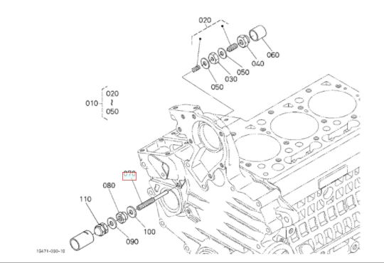

The fact that you can push down on the throttle and it will start and run leads me to believe that it's an Idle setting or throttle control issue and not a fuel issue:
It could be an internal issue, but start simple.
First things to check would be the Idle Apparatus (bolts for setting Idle) you do not want to change these you just want to make sure they are in place and tight.
They have a aluminum shield over the Lock nuts that will spin, but the bolt should be tight and locked down to the block.
Next you want to make sure that everything is working on the Throttle control, E.G., Stop solenoid is working (snaps in and holds for approx 5 sec when key is turned off then springs back out.), springs aren't broken, and set bolts are still locked and wired in place.

Thank you for the information. I will have to check that tonight. Is the the idle cover item number 060 in your illustration?

Everything seems to be in place and tight. I think I will just take it back to the dealer and see if they can figure it out. Thank you for the help though!
