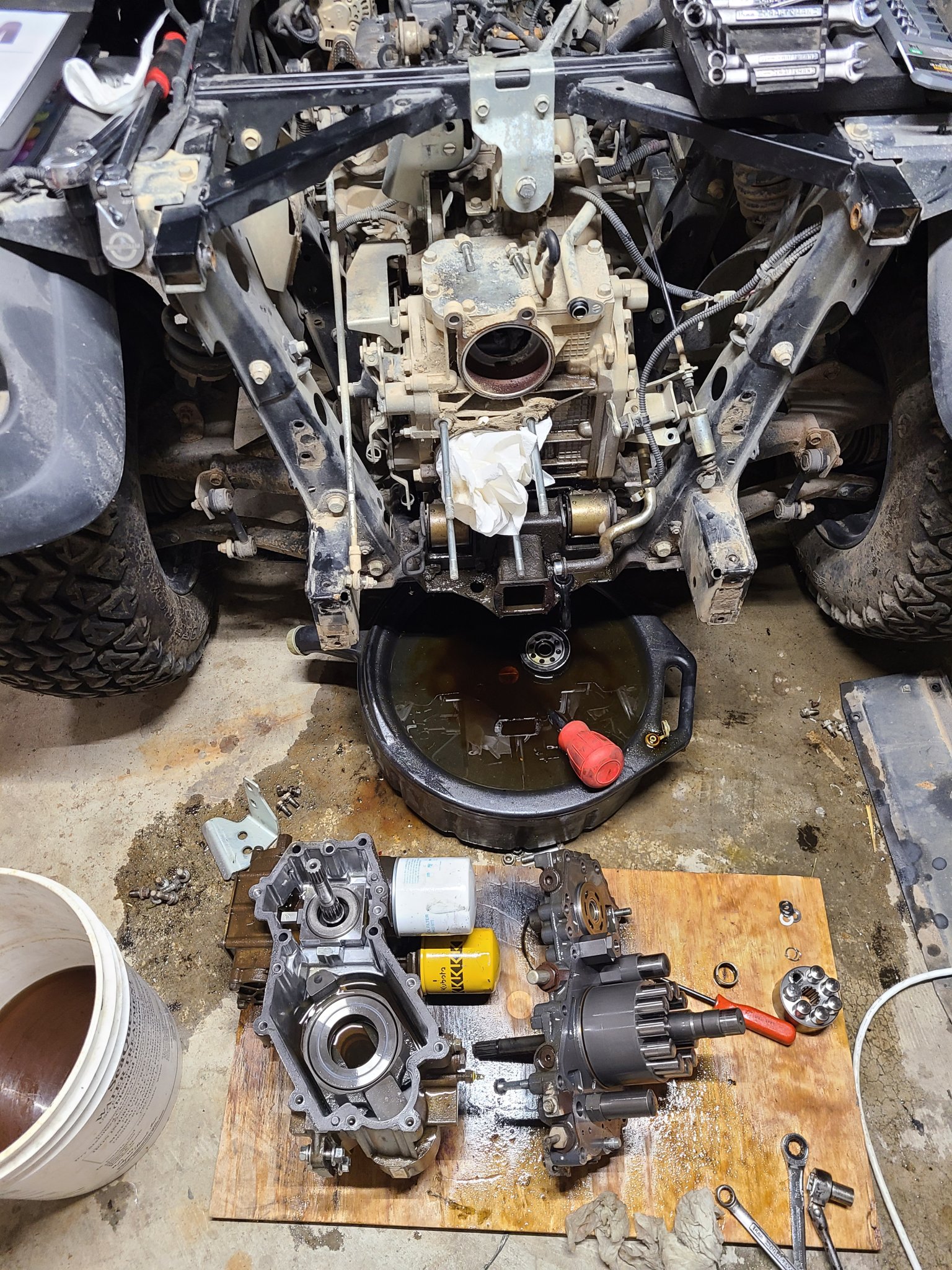

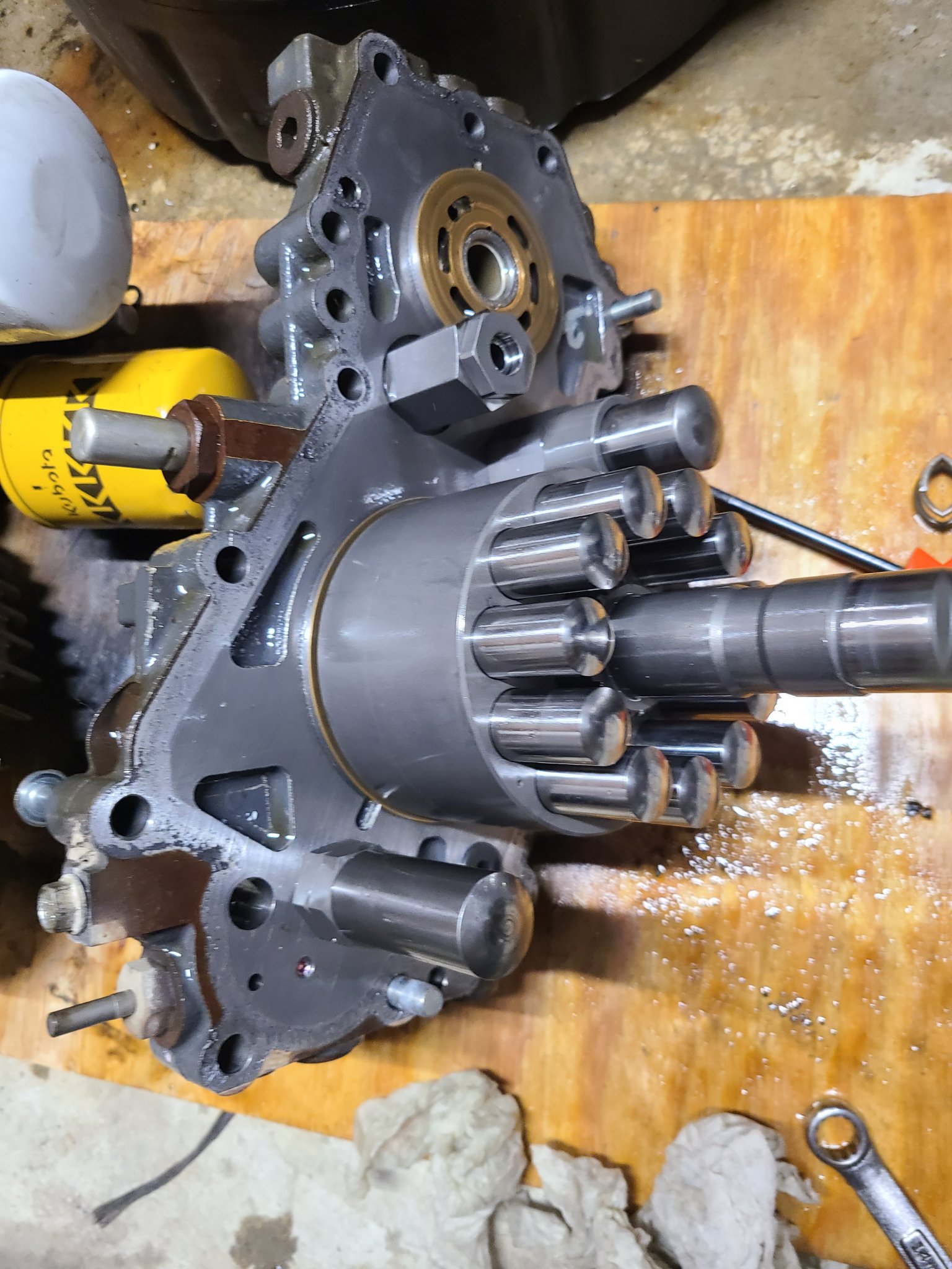

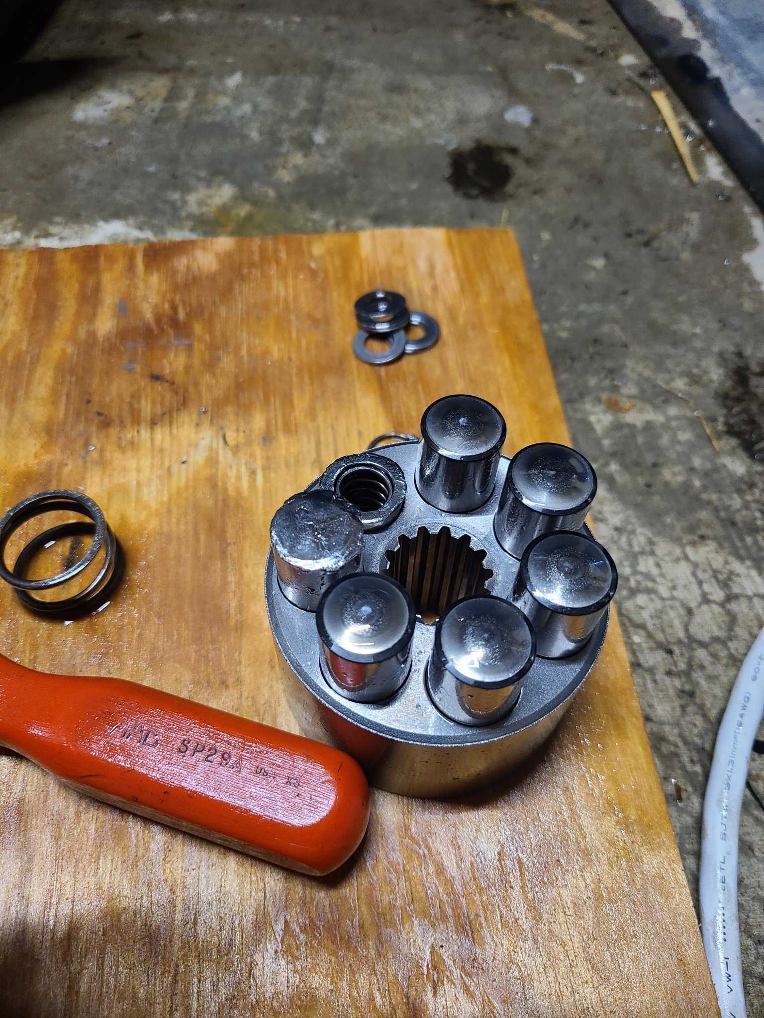

Bought a broken 2018 X900. Was told the transmission was bad as it would only barely move forward or backward. After reading other stories I assumed it had to be the HST. My first move was to add hydraulic fluid to the reservoir, which was about two gallons low. No change. Pulled off the HST today and found this. Seems pretty straightforward with what is causing the lack of movement but my question is two parts; I see zero appreciable damage anywhere other than the two plungers so would that mean everything is fine after replacement and secondly, how could this happen to just two?
I bought the machine for $3k so putting some money into this is worth it to me. Just want to make sure I prevent this from happening again.

Nice job of diagnosing and repair.
What do you think happened?
It appears that the piston shown was "hammered".
I wonder if lack of hydraulic oil and/or water in the system would cause the system to "hammer" as it starved for oil under a significant load?
Is that a "groove" worn in the swashplate from the damaged pistons?
What does the other piston look like? same?
Any big chunks of metal to be seen?
I'd be curious what the 3 filters in the system caught.
Check the unloader and associated linkage too. If the linkage gets out of adjustment it makes shifting difficult - a possible contributing factor.
I have to believe it was simply ran low on hydraulic fluid. How it only destroyed those two pistons I haven't a clue.

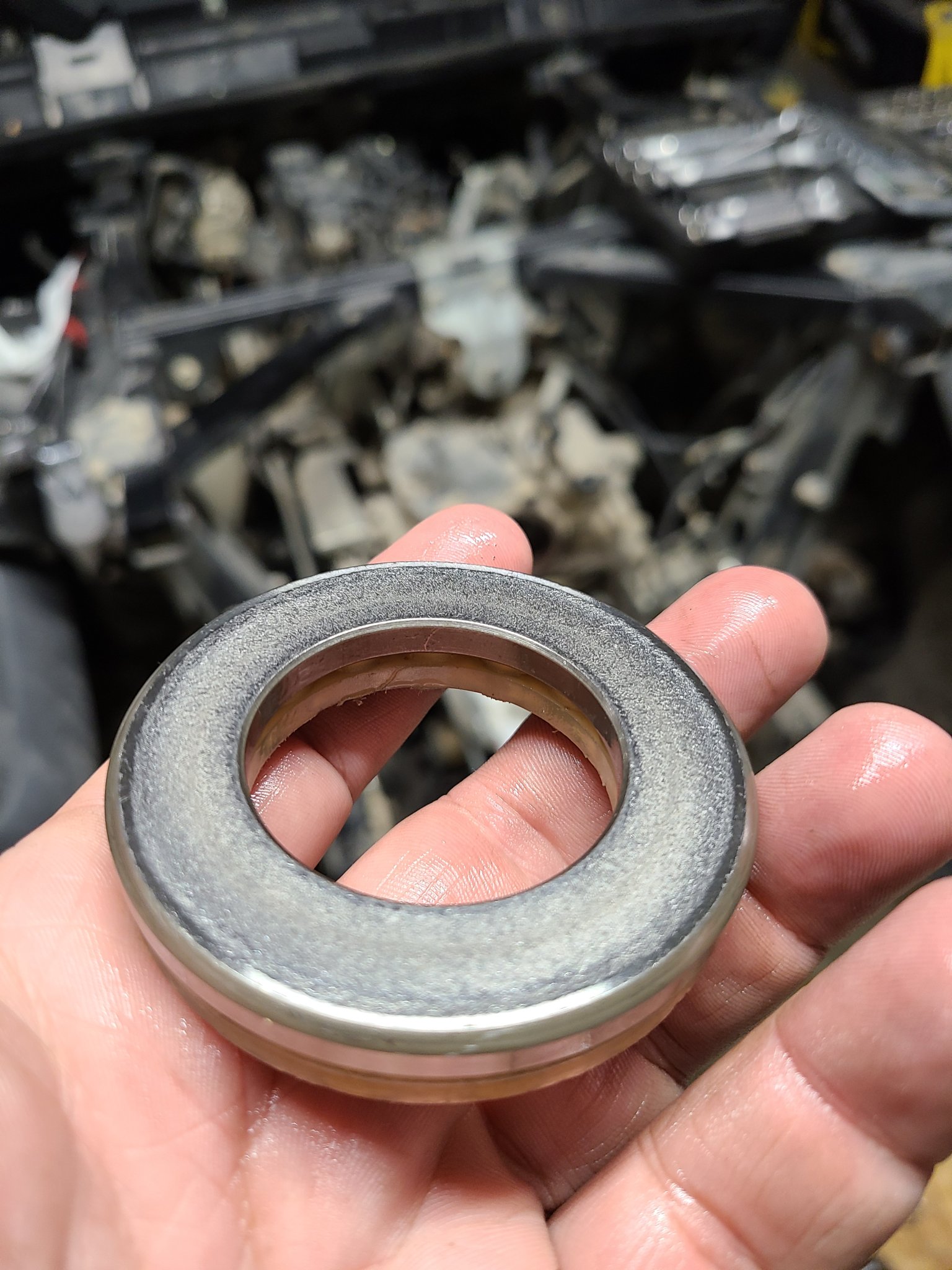

This is the upper swash plate:
There is an obvious mark but man I cant feel anything with a fingernail. The back of the larger swashplate is perfect. Zero marks.

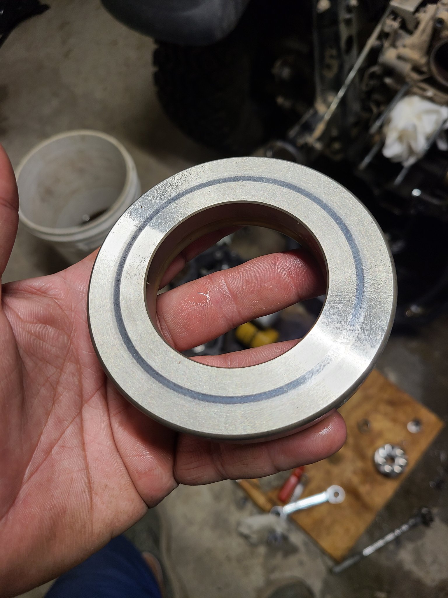

Now here is the lower bearing surface:
This has certainly seen better days. The shiny surface is completely worn from those pistons being pressed against it. I need a snap ring plier to pull the lower plate off, but I'm assuming there is some damage.

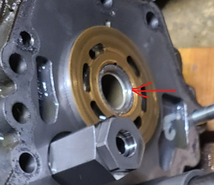

Before ordering parts or making your decision you need to inspect both valve plates and the motor rotating group surfaces. You will have to replace the valve plate for the pump anyway. Inspect the charge pump as well.
I would be less concerned about the thrust bearing for the motor and the cradle bearings as long as the do not show significant wear or contamination.
The area marked below of the port block looks like it could be damaged.
All of this will drive your decision, but a used part is just that and it is a gamble.

The valve plate is fooked hard. The whole system needs dismantled and surveyed.
