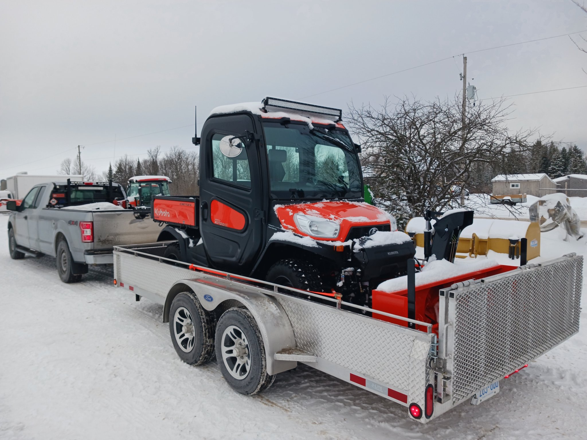

Anyone here have the K-Connect on their RTV-X1100C? I'm taking my Boss plow off, dealer is buying it and I'm getting the K-Connect and snow blower installed.
The questions I have are with that subframe mounted underneath, can you still remove the rear skid pan in order to change fluids? And what about the front diff? Will it still be accessible?
I am also having them put all new fan belts on it before they put the driveshaft on so I won't have to deal with that for a while.
Then just have to see where they are going to relocate my front turn signals.
Good thing I also have a receiver hitch mounted winch with wiring on the rear also because use the front hitch will be off limits now.

No, I do my own services and the rear steel plate that needs to come off to do the services still comes off. The K-Connect driveline does touch that one. They may remove the front part though? Not sure. But I did see back half is still on when I was at shop.
I got a good dealer. Only pain is front diff, the oil will run down the K-Connect skid plate. And replacing fan belt will require removal of a driveshaft.
