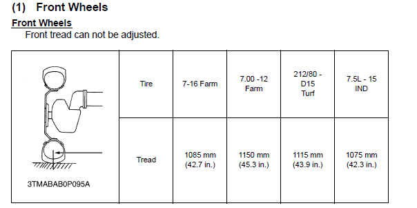

Thanks, yeah I can adjust the rear wheel width, but at the narrowest setting it is already 130 cm. That would be sketch marked as "a": 1015 mm measured at the middle of the wheel from the image below. Add to that half of tire thickness on one side and half on another, that gives you 1015+285=1300 mm.
So if you think tiller of 125 cm would work with 130 cm wheel width, I vote for that !

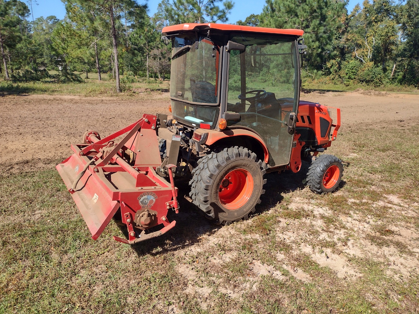

Pulled my 6 footer (182.8 cm) forward rotating tiller set at medium depth with my LX3310 Hydro in medium range this year. Fairly hard sand/clay mix soil. Kicked out the occasional root but no problems other than dry and dusty.

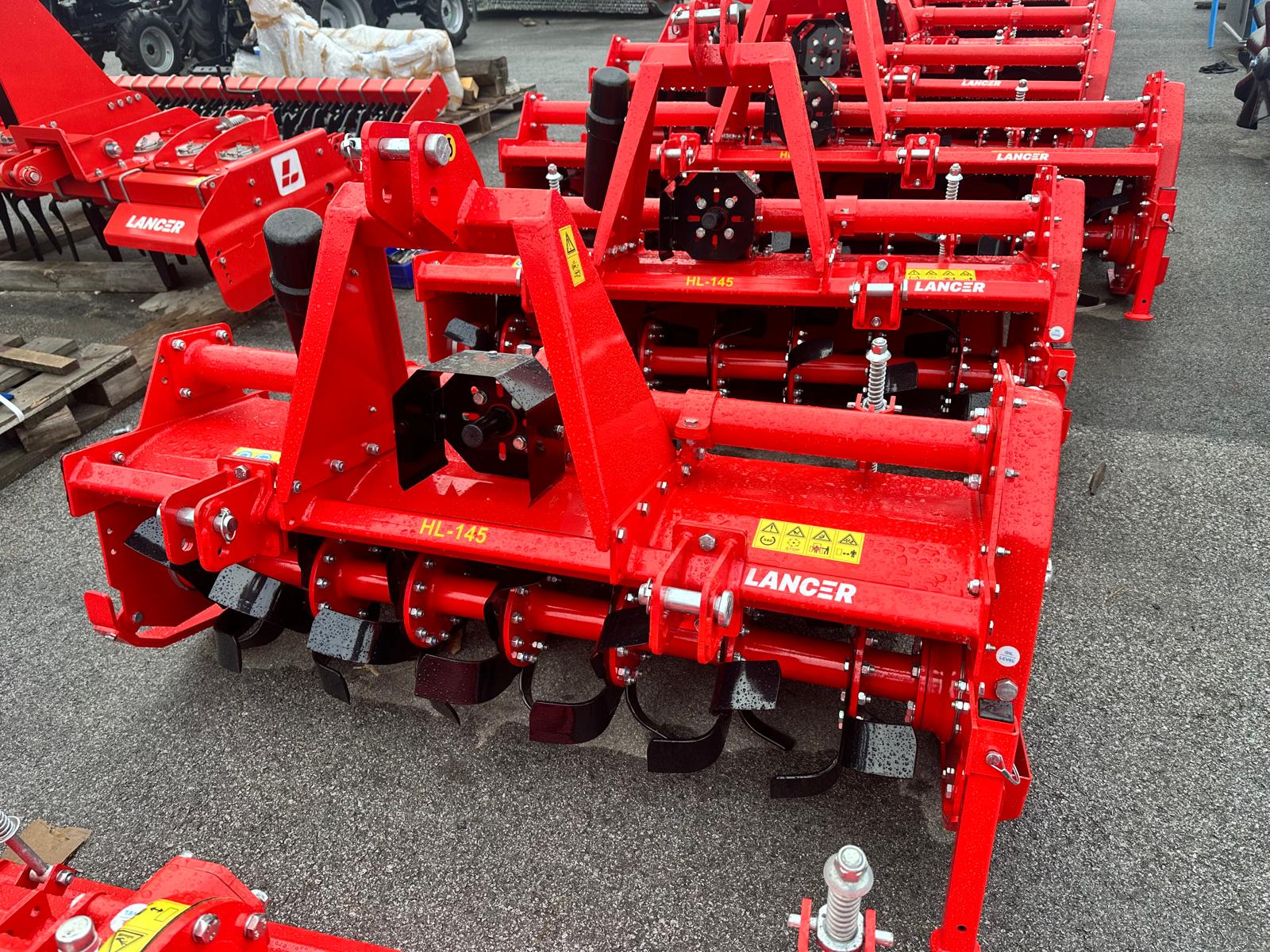

To make things more complicated, it seems that markings of width on the rotary tiller are not unique and depend of the manufacturer. The specs for the tractor list maximum working width. And what is working width? I assume it is the span of ground that the tiller’s blades physically engage and turn over in one pass. BUT is it measured from the outer cutting edge of the blades on one side to the outer cutting edge of the blades on the opposite side OR it is the inside width of the tiller’s chassis or housing?

I agree, we are not talking about mechanical watch precision here. BUT, let me tell you that the guy who is selling these tillers has measured width of blades and they are spread at 135 cm, while on the tiller it writes HL 145. 145 cm is inside measure of the chassis. So, I would say working width is 135, not 145 cm. The tiller specs in the book say working width is 145 cm :)
