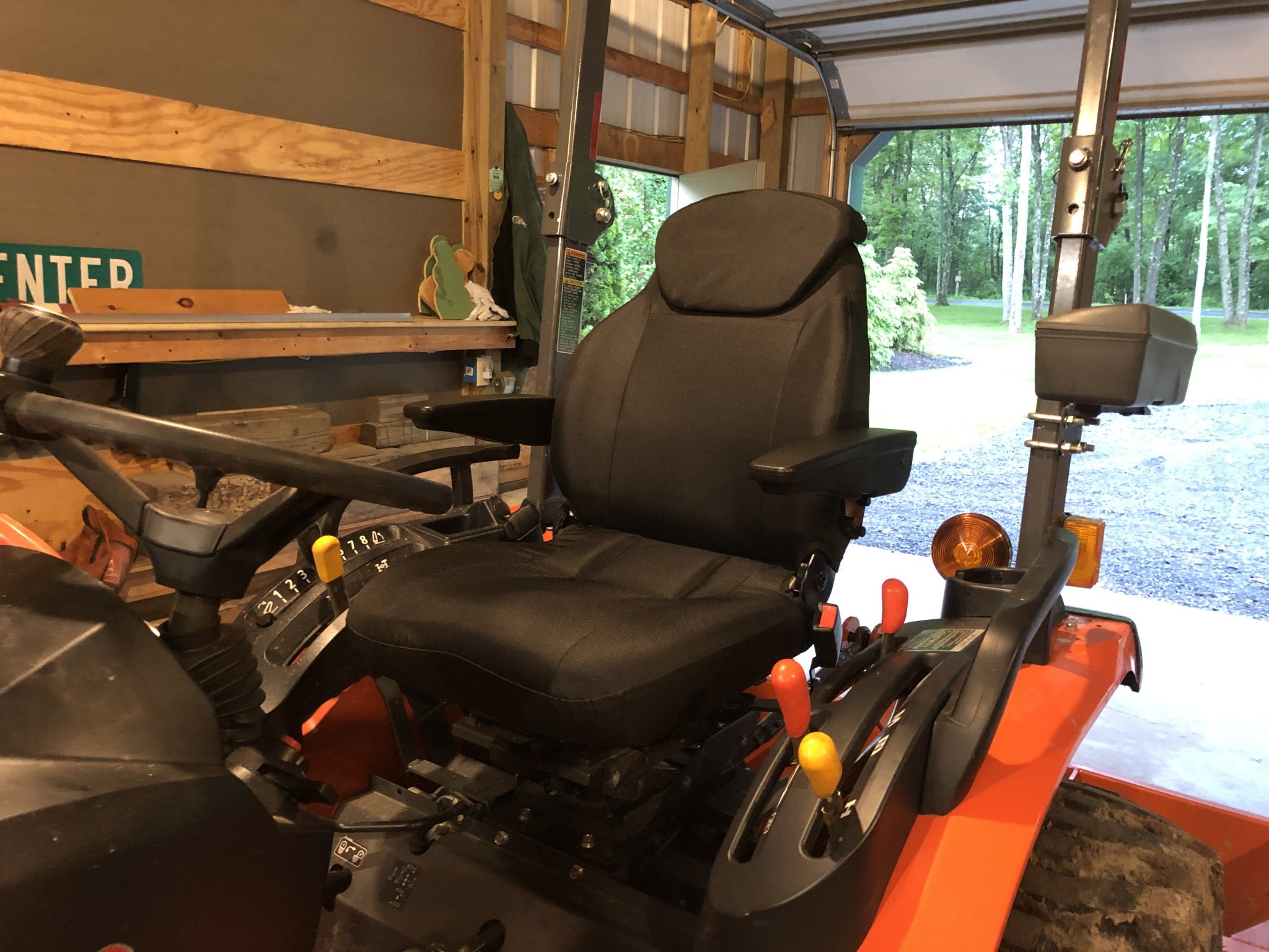

Just measured, and the LX is 90 inches to the top of the ROPS measuring to the ground next to the PTO shaft. Maybe not as tall as I thought, but taller than the OM says and too tall to go under anything less than 8 foot opening safely. As you pointed out, an OH door is gonna have some of the bottom panel still hanging down, unless I finagle a little extra track to fully retract it to a horizontal position. Maybe get a track for a 9 footer, trim the vertical portion down to an 8 footer, and then that will give the door a little farther to roll up and get outta the way. Or, just get a roll-up. They're pricy, but they get outta the way. I'm not opposed to sliders, either. After all, it's a barn, not the Taj Mahal. Anything will be better than the 'bota sitting out in the rain.
