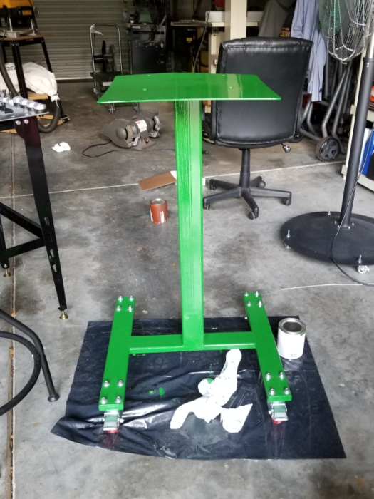

I have found that the canned Rust-Oleum tractor paint dries very hard, flat, and shiny. I'll post a photo of a project I used it on. Unfortunately, it doesn't mask imperfections in hot-rolled steel.
