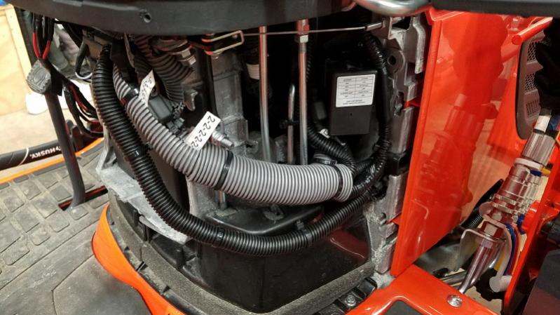

I took 3 30" pieces of 12ga wire and connected them directly to the positive side of the battery with inline fuses, ran them over the top of the battery box and cased them in corrugated loom. (See Pic 1)

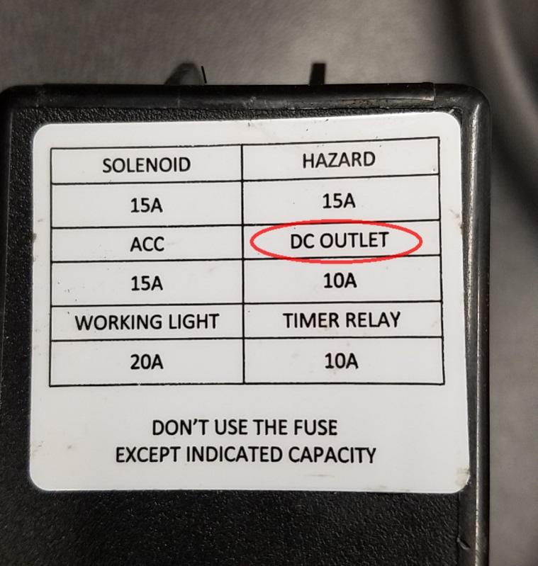

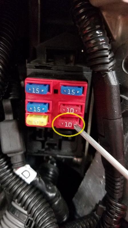

Located and removed the existing OEM Fuse box and located the fuse that powers the DC outlet (this one is switched by the ignition See Pics 2&3)

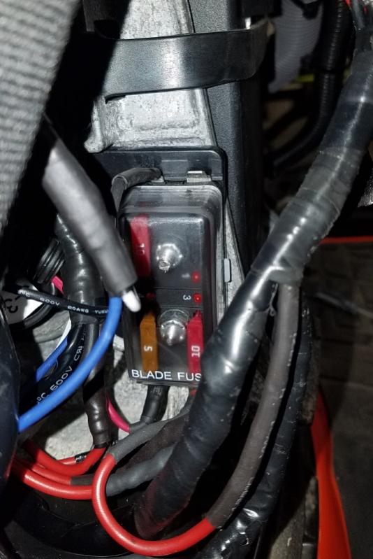

I then Installed the waterproof "add-on" fusebox and powered it with fused 14ga wire from the DC outlet splice. (Yes, the device will be double fused ultimately. See Pic4)

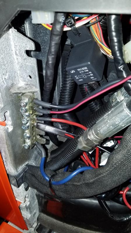

I Installed a Ground Buss Bar and grounded it to the battery's negative terminal and the frame (Yes, double grounded see Pic 5). This was purely for convenience.
I Wired the "low end" of the relay to the new waterproof fusebox on the line side and a switch to the load side.
Then, I wired two of the three 12ga power wires to the "high side" of the relay and then to the light fixture. ......done! The third could be used for future use.
