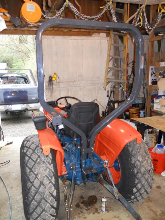

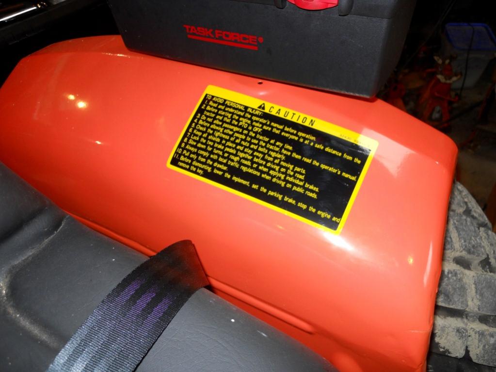

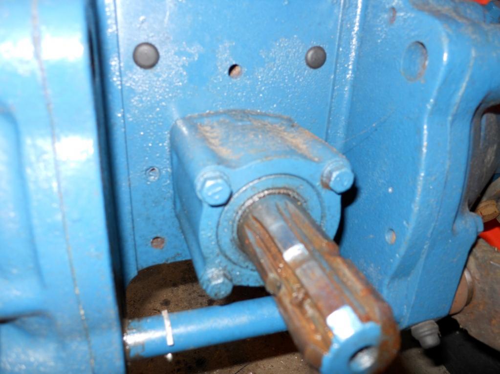

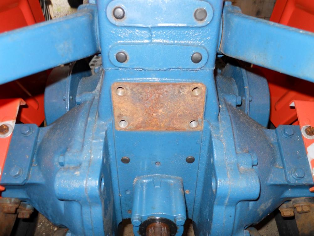

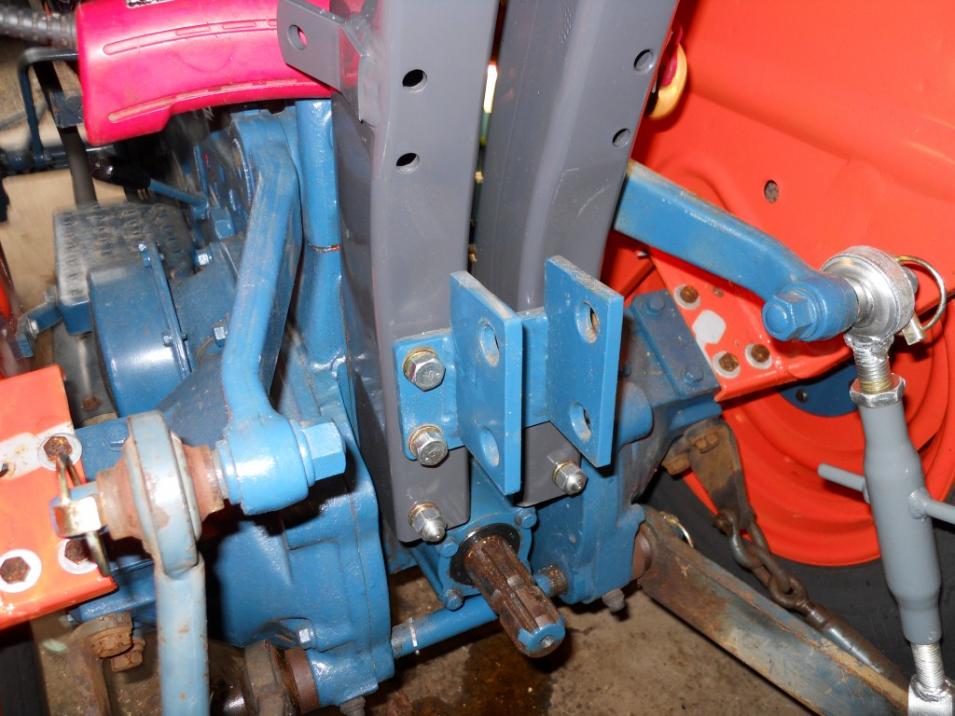

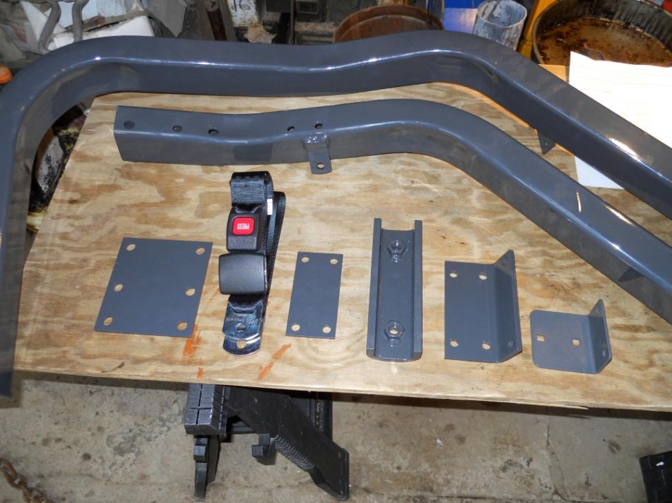

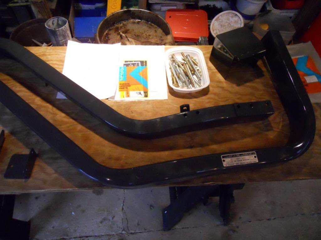

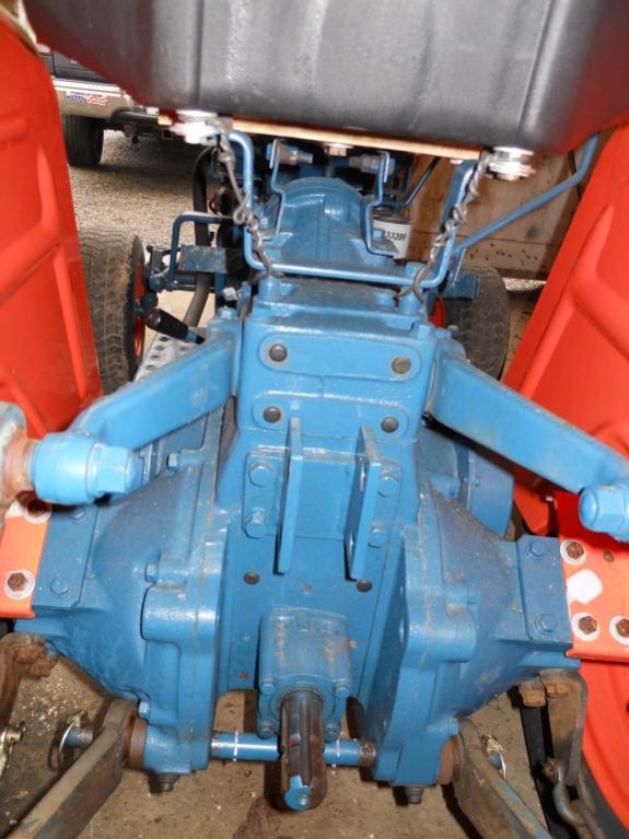

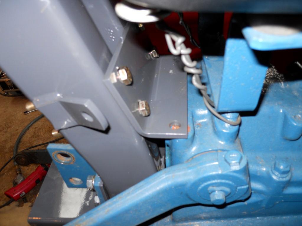

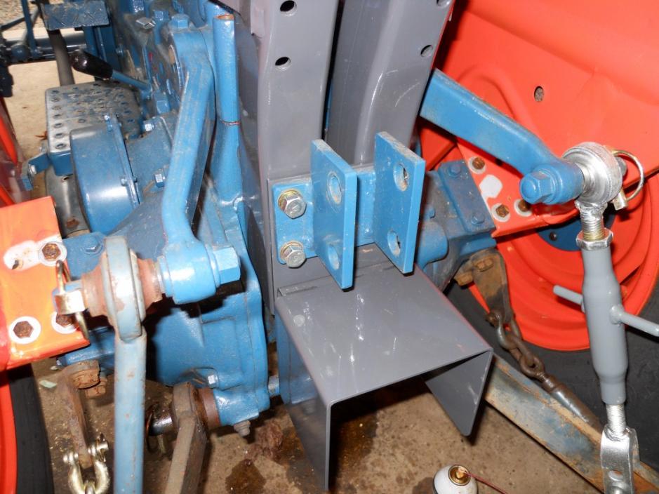

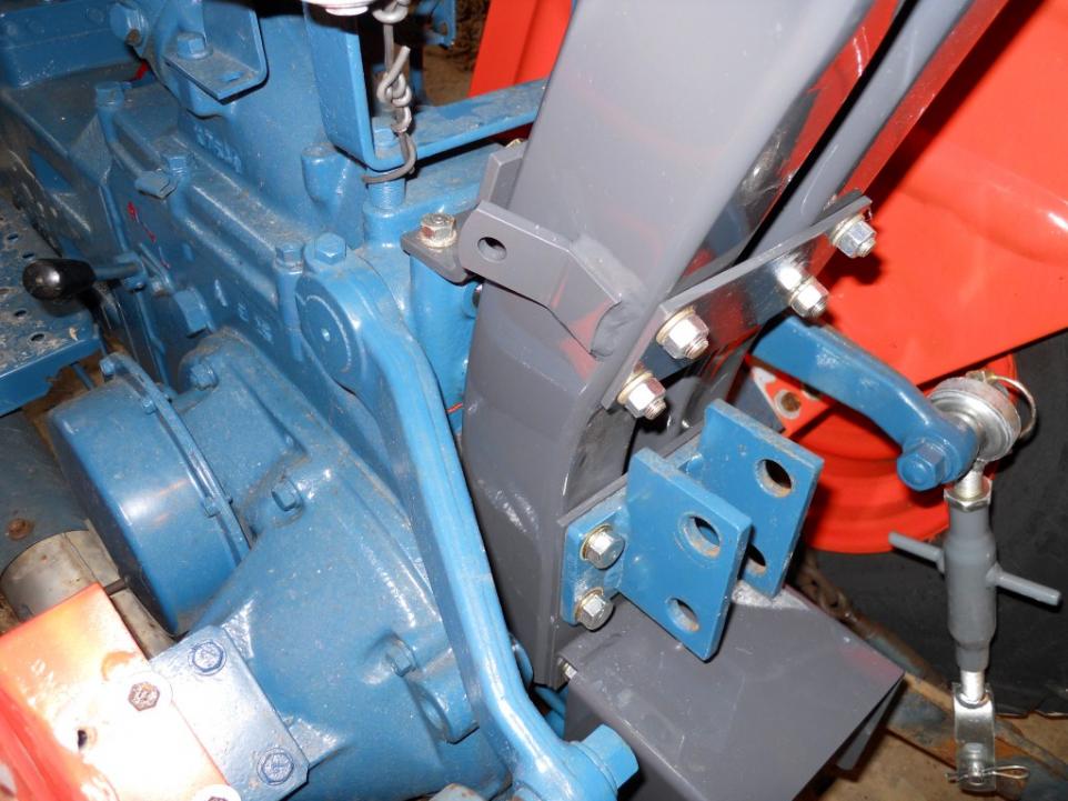

Took about two months for delivery but at last they are here. Cost was $148 + tax and $70 freight. First thing I did was replace a leaking oil seal around the pto. The only other advice I might add is to tap and clean out the two threaded holes where the studs are installed. After years those holes were nasty! The rest of the installation went well,even came with decals:)

Mine was missing the pto shield so it was nice this came with a new shortened shield. I may have to get a shorter top link bar because now my bar has to be on the lower hole and adjusted all the way in just to make my box scraper level. But I haven't tested it out yet.
14,549
3,297
Looks good,, man thats high enough you could put lights all along the top :D

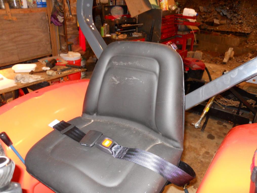

I also installed the ROP on my L185 along with the seat belts. Feel alot safer now. But will have to remove when I get ready to paint.

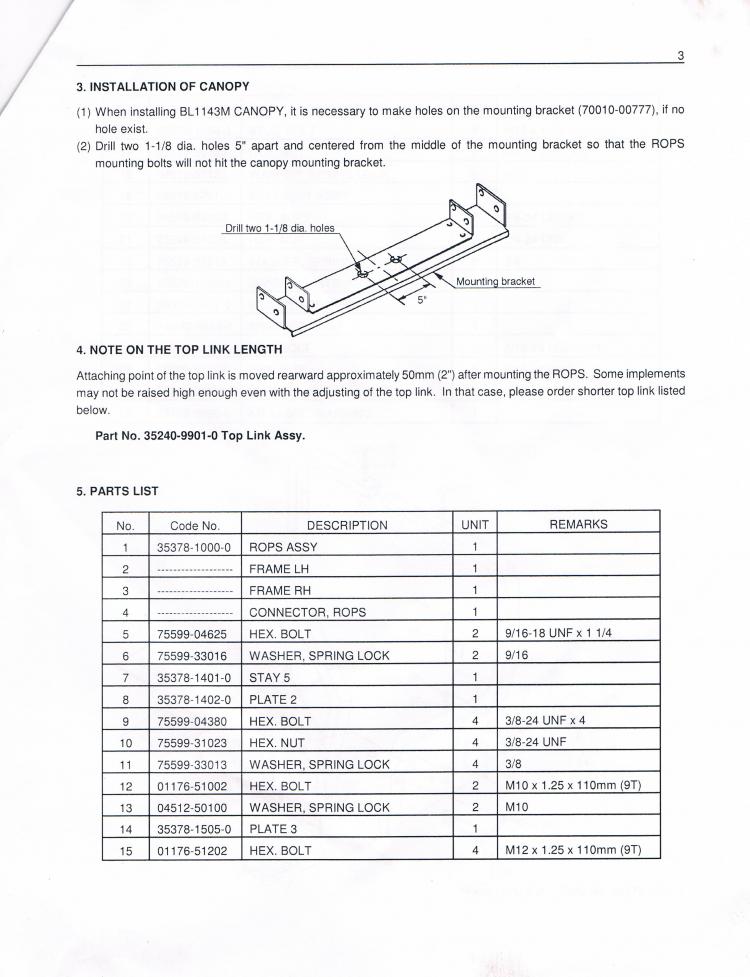

I may have discovered what you can order!

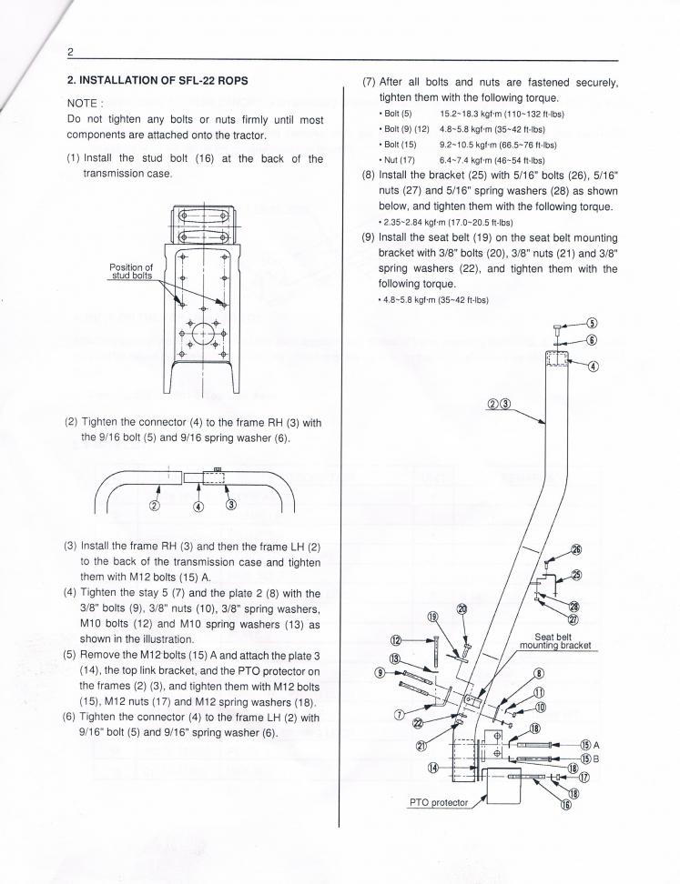

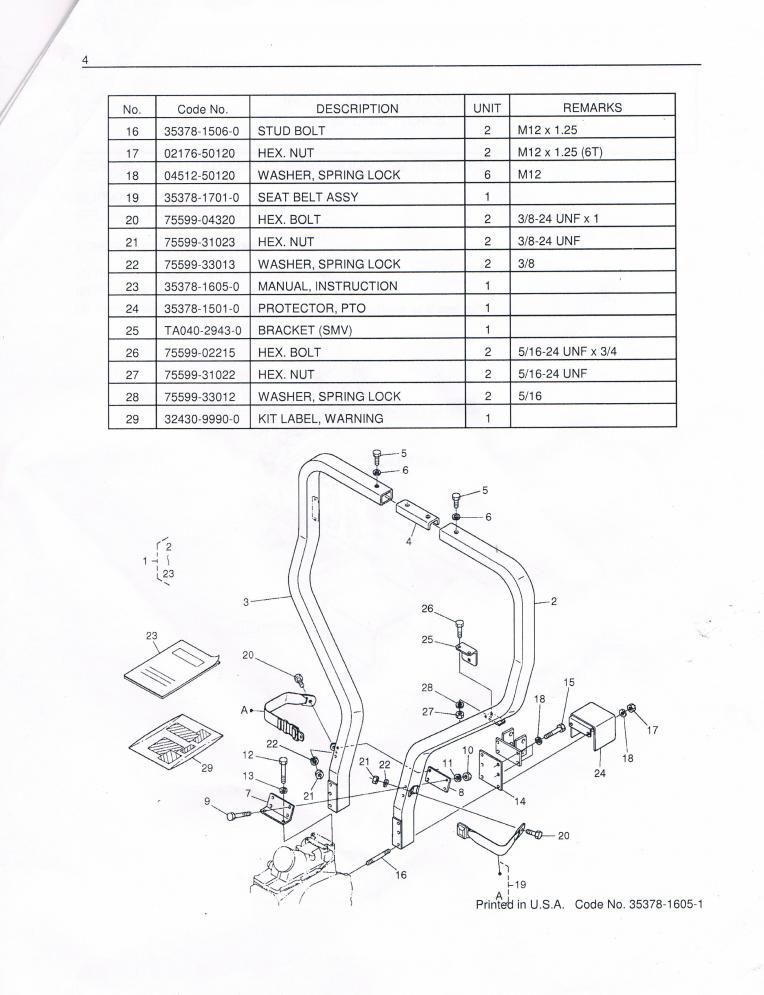

While it is true that what I recieved is the SFL-27 Kit the first part number is 35378-20000 and is the complete assembly.
See the attached PDF of the parts list. Perhaps if you ask your dealer to look that up, perhaps he can find out what you need.
The same ROPS fits the L185, L245, L235, L275. There are some additional parts required if you have draft control.
View attachment I00100.pdf
If needed I can scan the installation manual that has all of the part numbers listed but the PDF seems to show the same information.
Good Luck!
