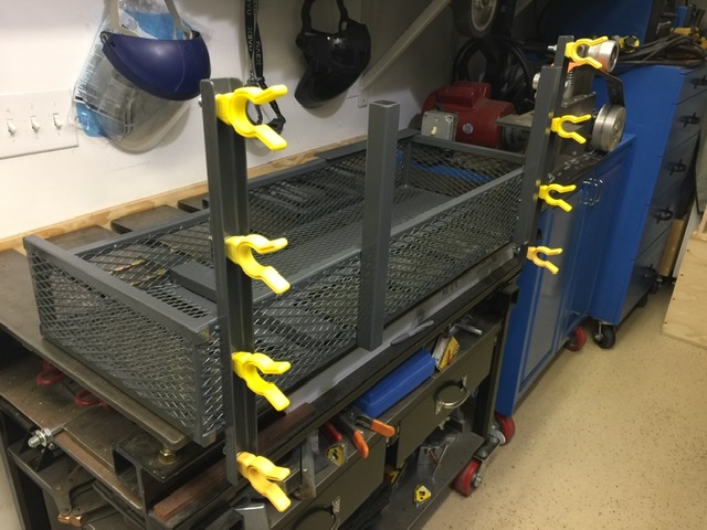

I had one and just built this with tool rack...

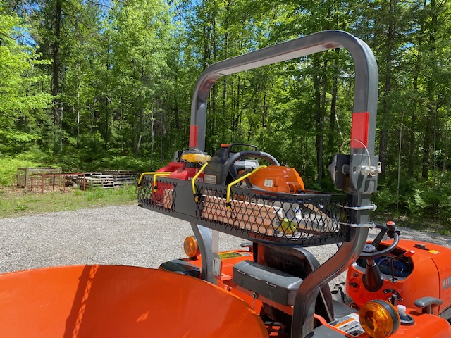

RDB thanks for sharing this. This is a great idea. I just ordered my basket 37.5” wide from Summit Racing $104 inc. delivery and found square U bolts with end plates at Menards for $1.60 each, I’m fitting this on my L3200 but may add the same to my other tractors.
Looking forward to finally having a solution to carrying a few things on my tractor, especially chain saw, bar oil and gas can.

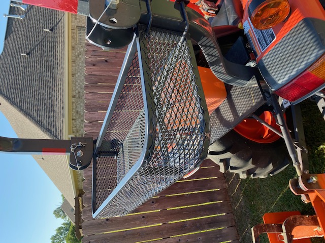

It's a 36" ATV front basket and I purchased the U-Bolts from TSC. I made the straps from flat bar from TSC. Works great.

Fitted my basket yesterday on my L3200. This is a great addition and allows me to carry chainsaw, gas can, bar oil and other tools. My land is mainly woodland, always need a saw on board, I just ordered another basket and will do the same mod on my L3901. I’m using a 37.5” wide basket from Summit Racing website and square U bolts from Menards for $1.60 each, very nice fit and finish.
