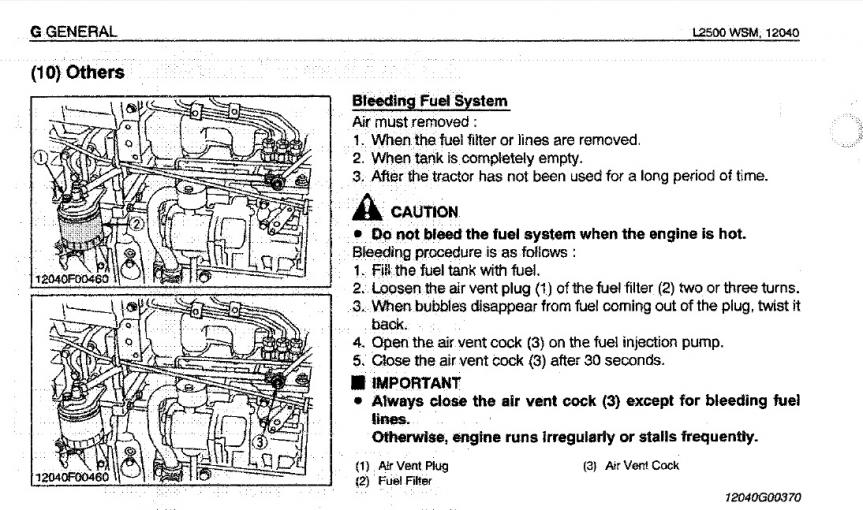

Cranked it up and drove to some shade. Oil & filter change, crank, run a couple of minutes and check. All OK. Change air filter, no issues. Filled a thirsty battery. It's been 40 years, literally, since I owned any real equipment but I remember trouble with air so I saved the fuel for last. (It's OK for you to snicker. But at my age the L2500 qualifies as "real equipment.) Tried to follow the owners manual I downloaded but there were some issues. First, I couldn't find a fuel petcock or shutoff anywhere. But I saw a post earlier where the poster stated to avoid having to bleed he screwed on the filter and let the fuel flow until if streamed out of the new filter, then tightened it up. So I prepared a bucket for a fuel spill, took off the old and screwed on the new filter with fuel overflowing the filter. Seemed to work OK. Cleaned up. Cranked up. Idled for a minute or two and just as I pushed the hand throttle forward, engine quit. I went back to the manual and unscrewed the bleed nut on top of the filter and got a smooth flow. I then opened the valve by what I assume is the pump/injector/whatever unit for 30 seconds. Didn't hear or see anything. Closed valve. Fires and quits. Repeat. Same. Tighten filter. Repeat, same. It's 89 degrees so I left for the house.

Set the throttle to high, crack all the high pressure lines at the injectors (not at the pump), crank for short intervals (to let starter to cool) till the you get clean bubble free fuel, then tighten start and run. ;)

Thanks loads to everyone of you. I opened the 3 injector connections 1.5 to 2 turns. Turned the engine over for a few seconds at a time, stopped seeing bubbles finally from two of the locations. There third injector was not visible without removing the air intake manifold which I REALLY didn't want to do. Cleaned it up, fired it up. Ran fine for maybe 10 to 20 seconds and started to lose RPM. I pumped the fuel, RPM came back, That happened maybe 3 or 4 times and then it started running fine. I let it run at about 2500 for 4 or 5 minutes, slowed to idle, upped the RPM a couple of times. Shut it down. Cranked right back up.
