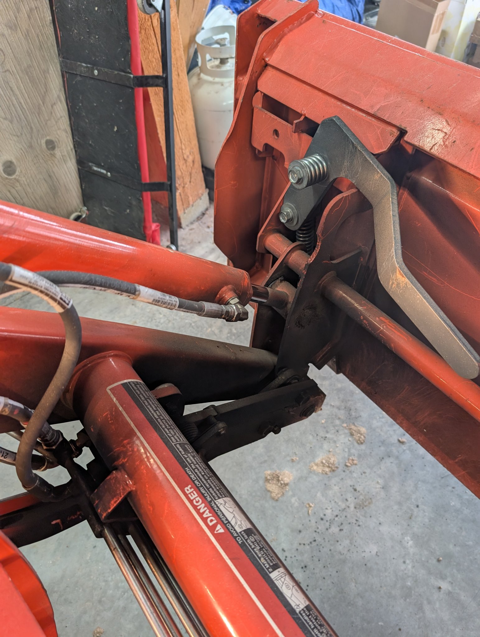

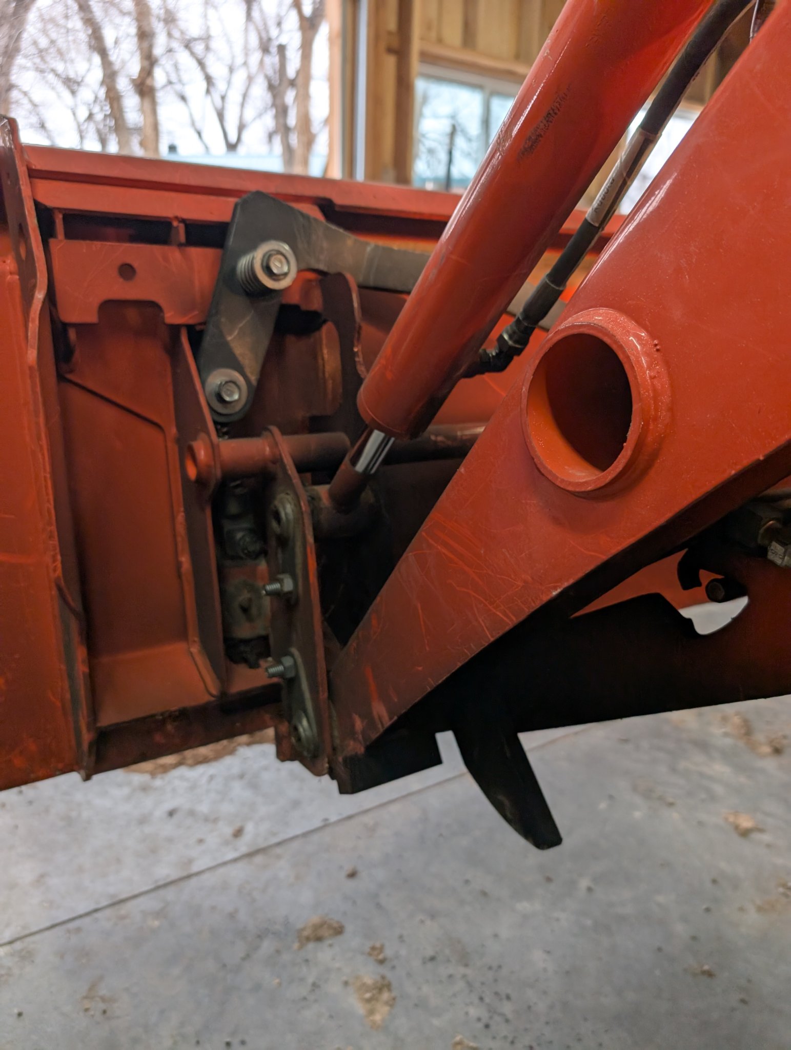

Second topic.... Been slowly digging and moving a large mound of dirt to other parts of my property. When digging, under heavy load, the exhaust pumps out a bunch of black smoke/soot. Since the B2601 has that front facing exhaust, the left side of my bucket is just coated in soot. Is this common? Pics attached.

Sounds normal to me.
Throw some stanadyne in it and see what that does for you.
It's a cetane booster (think Octane booster) in a gasoline engine.
Raising the cetane will cause no ill effects, but might help it run a little better.
I would also check the fuel filters and separators for any water.

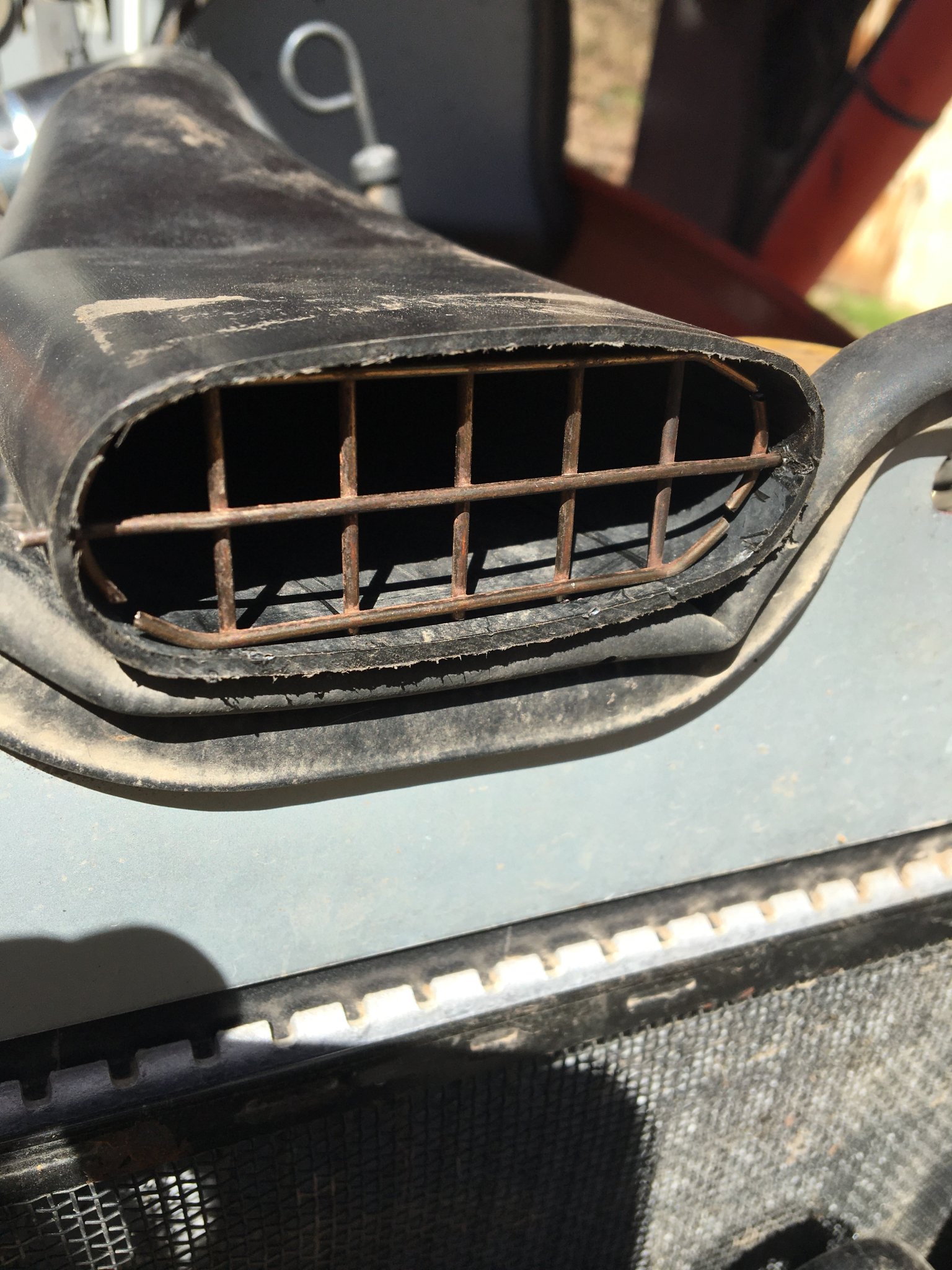

Few winters ago noticed the B26 having more black smoke when at operating temp. Do usually run with Stanadyne. Checked air filter. Housing full of red oak acorns! Packed cleanly by mice(?) with no damage to air filter. Screened both tractor’s air box inlets. No problems since.

Few winters ago noticed the B26 having more black smoke when at operating temp. Do usually run with Stanadyne. Checked air filter. Housing full of red oak acorns! Packed cleanly by mice(?) with no damage to air filter. Screened both tractor’s air box inlets. No problems since. View attachment 145191
Genius. I haven’t had a squirrel problem, yet. This will be an easy mod.

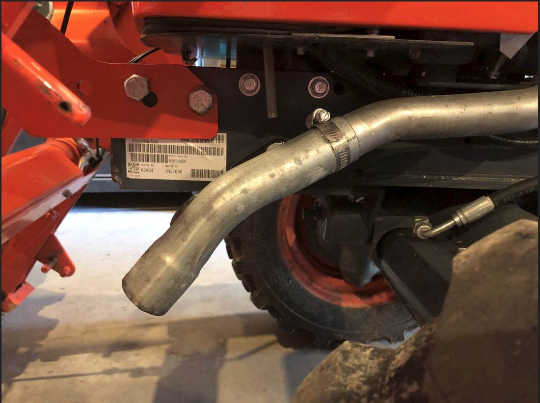

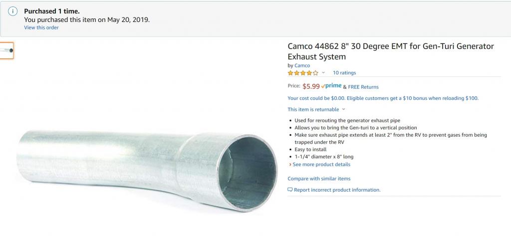

If it really bothers you...add something like this:
