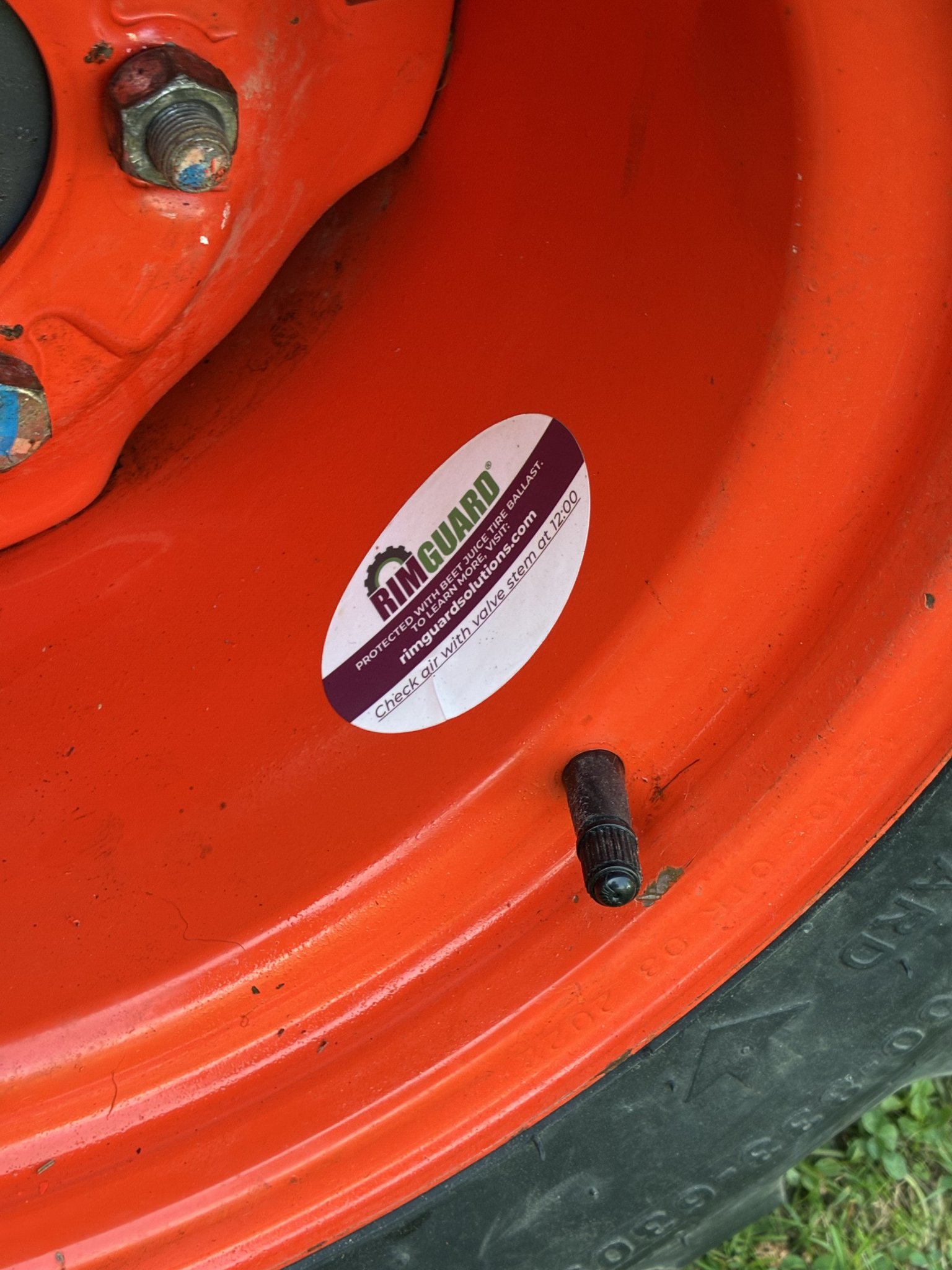

I have a 3 year old Bx23s-1 that has slowly been leaking fluid out of both rear tires. Bought tractor with tires loaded. measuring information is very difficult as valves at 12 spits out nasty very salty clear liquid. Finally figured out If I do it quickly I can get a reading. Found them both a bit low. Have to over inflate a bit and the leaking slows but still have wet tires at the lowest point. Tires clearly say rimguard (beet juice) Dealer claims to have installed a product called ballast star. Anybody have experience like this?

Quick internet research says Ballast Star is basically calcium chloride with rust inhibitor. How well it inhibits rust remains to be questioned. I would start by getting a spray bottle of soapy water to spray around the rim/tire bead and valve stem to inspect for leaks.
Quick tip, inflate tire first with air at 12 o'clock position to 'clear' the valve before measuring with gauge.

Great tip to fill with air first. I called the dealer where we bought the tractor with cash, service manager never mentioned that. I also think since the tire has Rim Guard on it with an 800 number to call. They probably should have Rim Guard installed. I sending them some pictures but I do not trust these people at all.

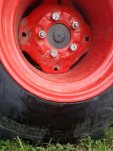

I will inspect for leaks but it’s pretty clear that it’s coming out around the rim. I have read that the ballast star has had complaints about corrosion. I understand that the oil they mix with the Calcium floats on top and circulates to protect from corrosion. Rest assured what comes out of the value at 12 o’clock is pure salt. I captured a little and tasted it.
130 hours on the machine and most have been pretty gentle.
Thanks for the feedback and I’ll let you all know, when I know

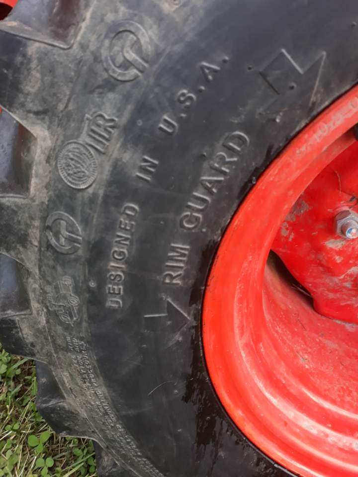

I believe you are confusing the use of rim guard on the tire and the ballast product called Rim Guard.
On a tire there is a method of projecting the rubber over the rim to protect the rim from damage. I think your tire has a “rim guard” not that it should be filled with Rim Guard.
This is one internet description of a tire rim guard (also can be called scuff guard):
A rim guard is simply an extra section of rubber that is added to the outside of a tire sidewall or bead area to prevent damage to the tire and wheel.

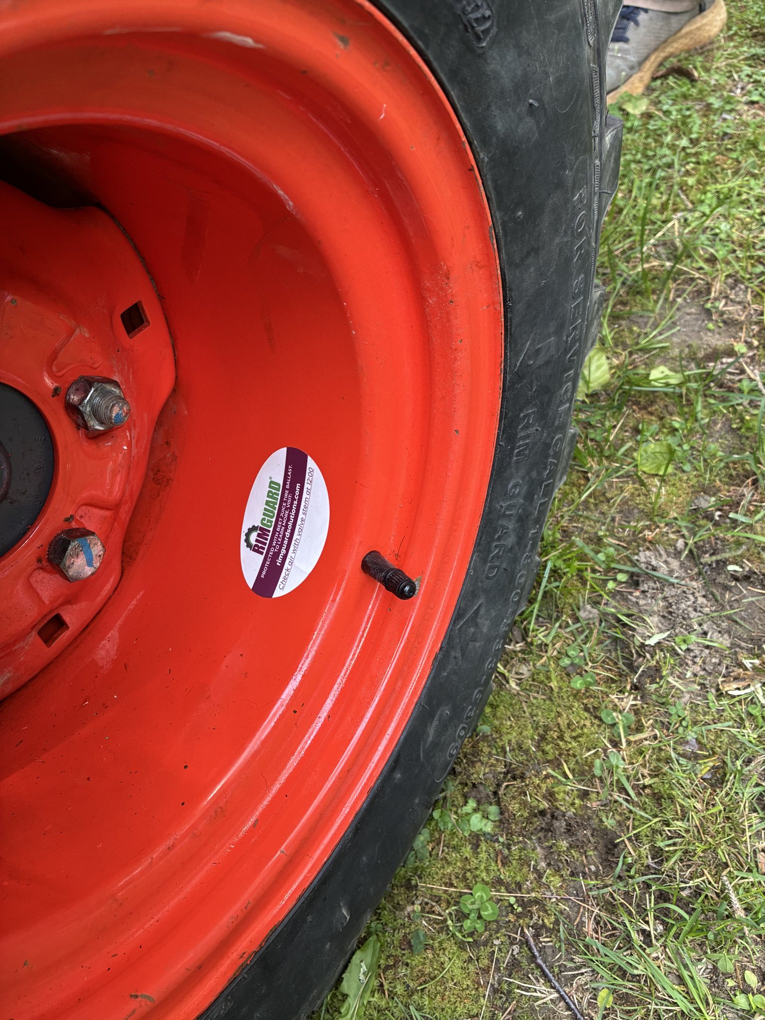

"clear salty brine" makes me think you have calcium chloride/ water in your wheels. It is a very common ballast. "rim guard" is beet juice which is red and sticky.

That is what I am thinking too. I sent pictures off to the dealer.. everything I have read says that calcium chloride should be in tubes.
thanks

Probably a gadzillion tubeless tires have been filled with CaCl. Your problem is not the liquid its the leak. Unfortunately, after three years of use the cost of fixing that is most likely coming out of your wallet.

I've never seen a tire that has Rim Guard molded in that is the Beet Juice derived Rim Guard product. If you think about it, it doesn't make sense to imply that the tire is filled when it isn't even installed.
Fwiw, my rims have a Rim Guard sticker.

Actually filling tubeless tires with calcium chloride is a very common practice. They do not make tubes for most heavy equipment tires so the only choice is to do so. The secret is to fill over the top of the rim so no oxygen can reach the rim.

$242 to touch up rims, install tubes and load with beet juice. I was expecting more than twice that. We did deliver the wheels to a much more honest and helpful dealer.
They all chimed in that they have repaired many many wheels with this salty brine, and a few were damaged beyond repair. One blew out in a field and spread this solution, killing the crop in that area
