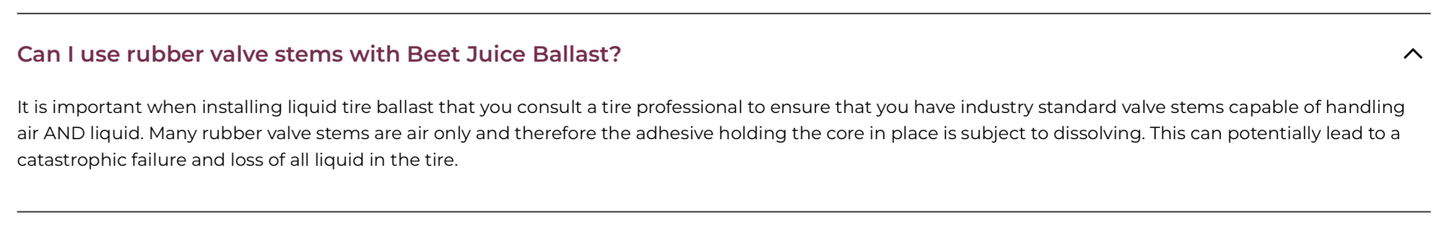

I noticed that they used the stock rubber valve stems. Mentioned this to the employee that dropped off the tractor and he said that's just what they do there. When you go to Rim Guard's website under the FAQ section it states the following:
For what I paid to add the Rim Guard for such small tires I would have guessed it included replacing the rubber valve stems with brass. Have read about a few accounts where the tractor owner went to air up their tires that had ballast and rubber valve stems and the valve stem core blows out.

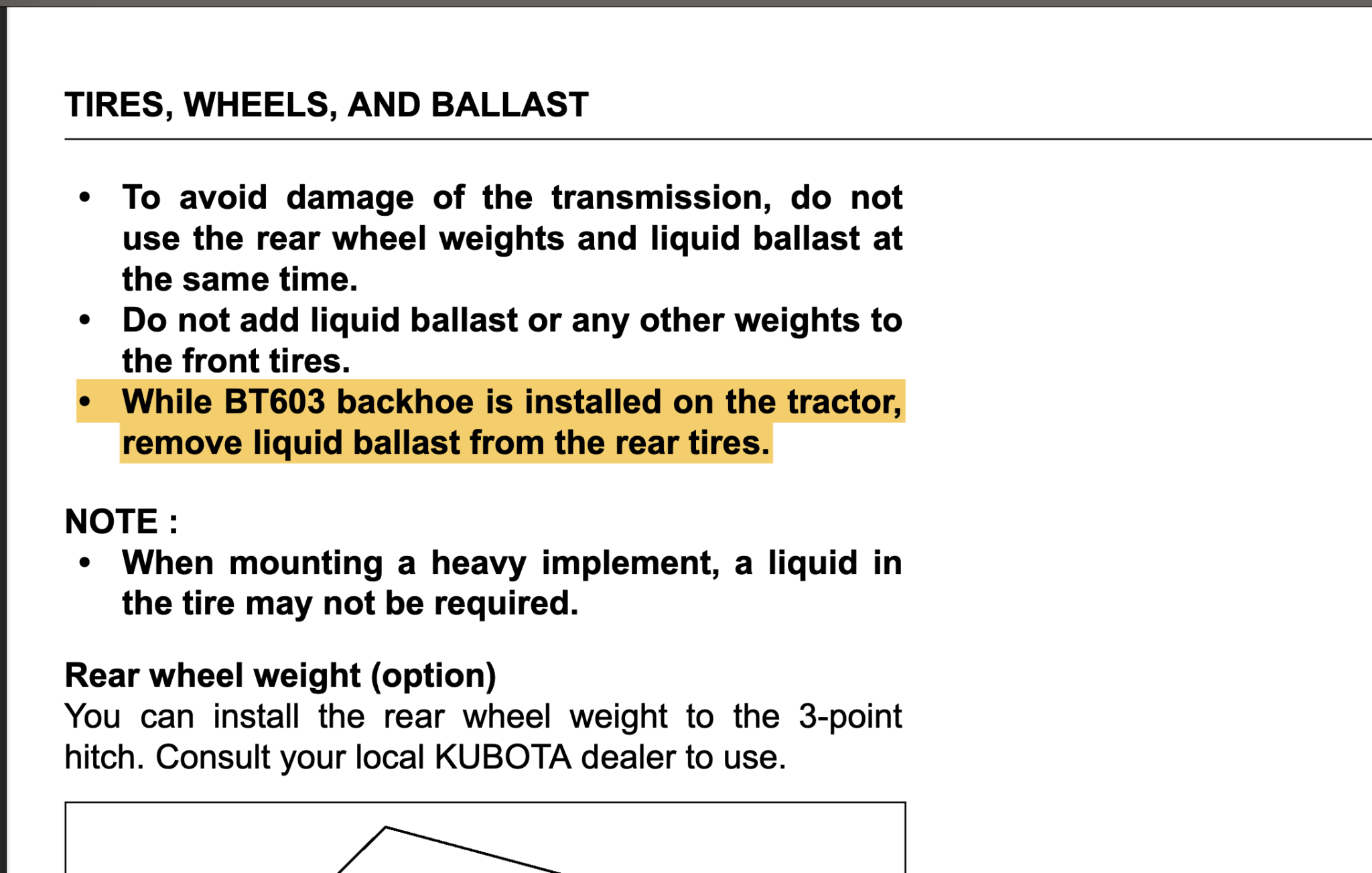

Like my cat, I'm curious ,, as to why you added ballast as Kubota specifically says to NOT do so ,when the backhoe is on the tractor. If you have the MMM, generally lighter is better for grass cutting, lest you have 'hills' to mow.

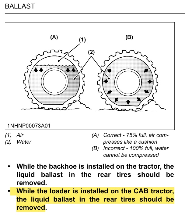

I'll have to look at the Operator's Manual.
Funny how the dealer was very serious about NOT adding wheel spacers, but was ready pushing the Rim Guarst ballast for the rear tires.
EDIT: found it in the Operator' Manual. Guess I'll be calling the dealer tomorrow.

@MT, the dealer should replace your rears with new ones, free of charge since he never READ THE MANUAL of what he SELLS !!!
My BH has been on for 7 years used on all sorts of terrain,some 'questionable...,no issues. Since you don't have the MMM ( same as me) , get rid of the rimguarded tires.

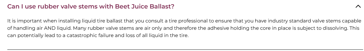

If you have rubber valve stems that are made for liquid and air they will work fine. If they are standard air only you may have future issues, depending on how well the brass core adheres to the rubber stem.
This is what Rim Guard states on the issue.
That highlighted bullet is ridiculous and completely impractical, just as removing wheel weights is impractical. I ran beet juice in the rear tires of the BX25 I had for 5 years without any issues, regardless of whether the backhoe was on or not. The local dealer installs beet juice in all tractor rear tires regardless of configuration.
A BX rear tire at 75% fill holds about 90 lb of beet juice, so that's 180 lb all in. Hardly a game changer, and the only logic to that comment that I can think of is that Kubota figured that with the FEL maxed out, the backhoe on and 75% filled rear tires, the overall weight of the tractor might be hard to stop on a decline of X degrees. This seems more like some legal disclaimer more than anything.
