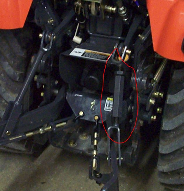

Also - the arm on the right (3 point arm) can be adjusted via a turnbuckle - look at attachment.

You can adjust the left/right height a bit by adjusting the top two clamps where the hitch mounts to the front of the tractors frame. The aluminum mounts have an angled cut so the tighter you make them the higher that side will be.

That's a thought, I see what you mean. If I loosen the left T bolt a bit it should make the left side drop a hair. The manual says to keep both those things tight, but even then the hitch basically hangs off the tractor.
