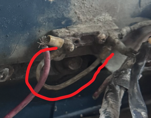

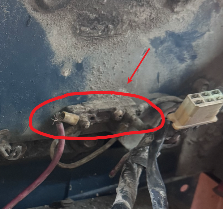

Good morning everyone!

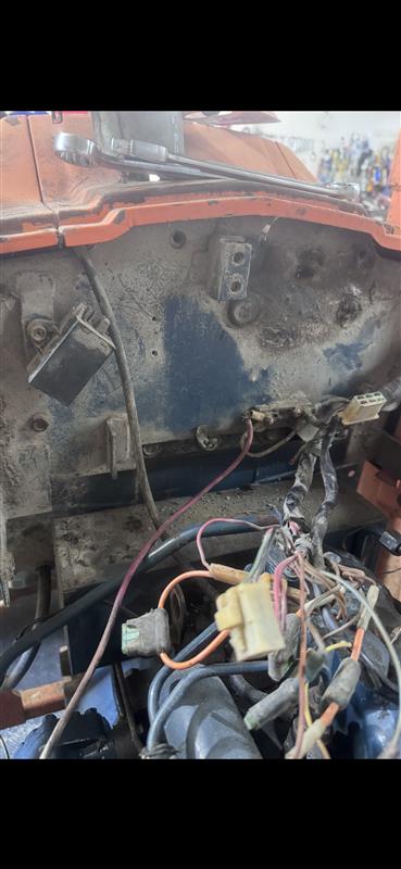

I'm rewiring a L345DT (believe it's a 1979 model) because well it's been hacked and taped and chewed all to bits lol. I've got the schematic but I'm unsure what one piece of the harness is. I can't tell if it's a ballast resistor, junction block or just a bus bar of sorts or what? Can anyone help me figure out what this is? The schematic and parts diagrams don't appear to list it and my local dealer has NO clue.
I've got a new voltage regulator, ignition switch, starter switch, fuse box (aftermarket but will work better lol), and wiring/connectors just trying to figure out for sure what this is.

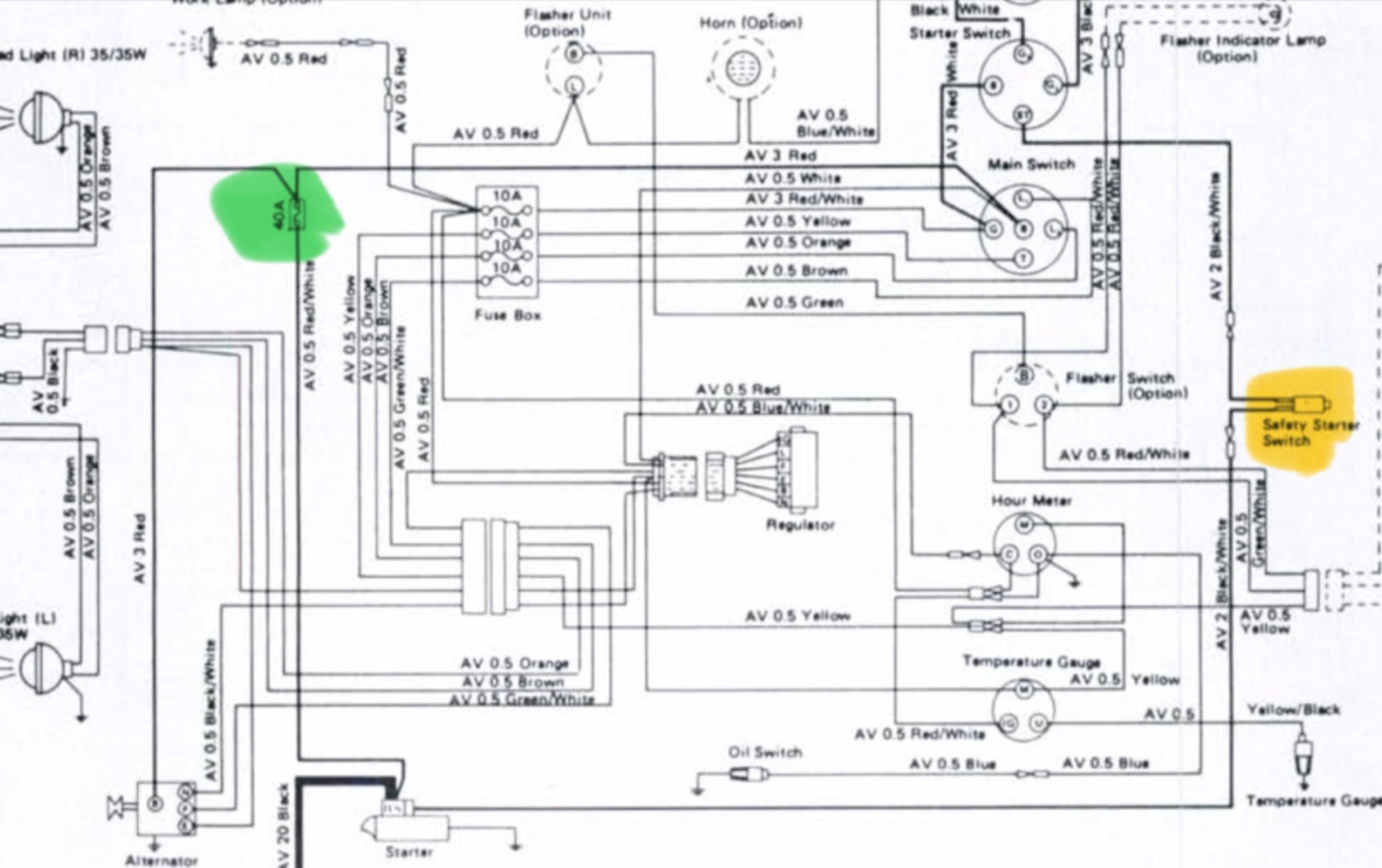

I am totally guessing on this but it may be a 40 amp fuse (green highlight) or something to do with the “safety starter switch” (yellow highlight). See marked schematic.
It looks like the fuse holder and wiring to me. The fuse may be a fusible link (wire across the ceramic body attached to both posts??)
@007kubotaguy might know for sure and comment later on.

Where exactly is that part located, in the back of the dashboard?
I rewired an L345 also, I think the safety starter switch is under the seat (seat had been changed on mine)
I think the 40A breaker above is just off the starter and takes a spade fuse. FYI from experience glow plugs are pulling a lot of amps, make sure you have correct gauge wire
That's kinda what I was thinking it might be a fuseable link type deal.

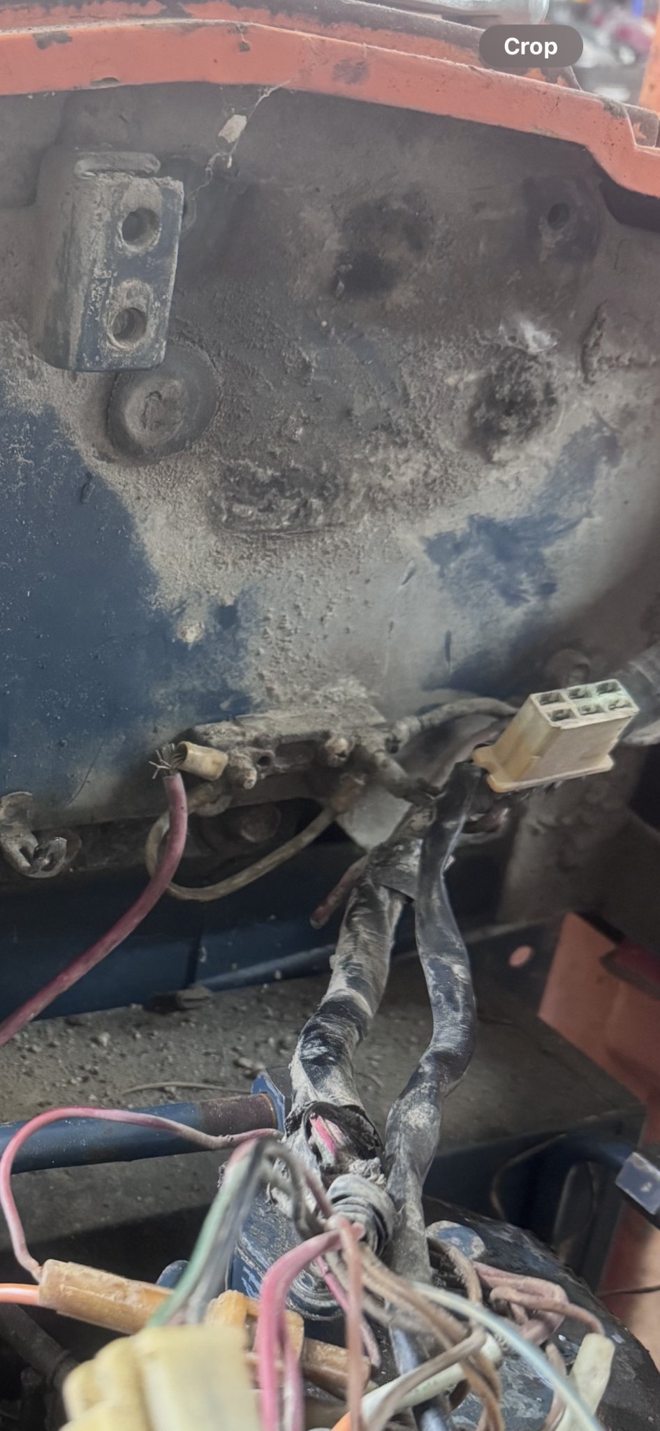

It's on the front lower driver side of the firewall, just side of center. I posted pics showing where it is mounted at.
And yes I converted the metric sizes on the schematic to AWG and rounded up or went up one size. Better safe than sorry.

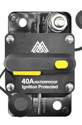

I'm thinking the same looking at the schematic, and think I'm going to replace it with a 40 amp waterproof circuit breaker like shown in attached picture. More modern, same purpose as the wiring schematic.
I'll confirm when I get off work that the wires from it go to the alternator (I believe they do but can't tell in the picture I have of the harness on my phone.

Or somebody got creative and bridged the (missing) fuse?
ENTIRELY POSSIBLE given the rest of the hack job on this wiring lol.. Especially because there is a jumper wire going across the terminals on it.
At first I was going to just patch it up but the further I looked into it I was like no... no... no... lol I don't want to put all the work into this thing just to have it burn down because of the wiring lol.

Sorry I'm late to this thread - my L345 has an enclosed in-line fuse in that location. It protects the starter/solenoid wiring. I found the original burned out one day and all I had were 30A fuses - which work a few times but eventually burn out. Needs a 40A fuse there. Your proposed 40A replacement circuit breaker looks like a fine replacement/upgrade. Take care, Dick B.
Awesome thank you! Based on the schematic it looked like it should be a fuse/fusable link but I've never come across one like that so wanted to make sure. The breaker will definitely work, and if it trips (which it shouldn't) it'd be easy enough to reset :)

The major load on that circuit is the glow plug circuit that the big black switch turns on when turned to the left. If it opens the new 40A breaker, check the glow plug wiring. On the posted circuit diagram the GP's should be in the upper right corner - (clipped off on my screen).

The major load on that circuit is the glow plug circuit that the big black switch turn on when turned to the left. If it opens the 40A breaker, check the glow plug wiring. On the posted circuit diagram they should be visible in the upper right corner - (clipped off on my screen).
Yeah I've got the full schematic and shop and parts manuals printed out. I'm rewiring EVERYTHING... new Ignition Switch, Starter Switch, Glow Indicator, Glowplugs, wiring, starter, alternator, voltage regulator, new style 12v fuse box, battery and swapping the OEM oil gauge over to a multi gauge that will read coolant temp, oil pressure, and batt voltage. Oh and I'm a fan of grounding straps so adding a couple as well.
