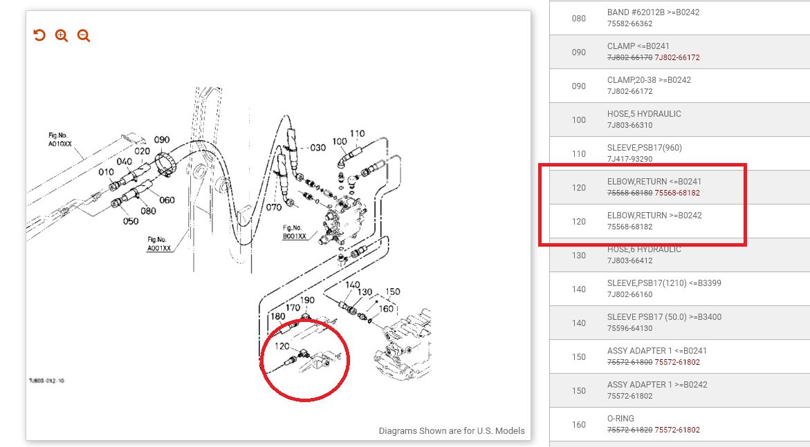

I've scoured every source that I can find and I cannot find where the return to sump line (or access port) is on my L47. I want to buy a Lane Shark this spring, and would like to have all of my hydraulic ducks in a row before I put the money down on the unit.

With nothing but the Kubota parts diagrams to go on the plumbing on the L47 is hard to decipher. Assuming you are going to power the Lane Shark off the loader power beyond the loader return looks pretty easy as well. A run tee added to the return elbow on the transmission would dump straight to tank.
Do you understand the ramifications of inserting the Lane Shark in the supply circuit and then using a dedicated tank return?
Yes, that is exactly what I was planning to do. I just had difficulty finding the return to sump line or access port. Even Messicks was vague (by phone call) as to the location.
Just folloe the loader return to where it connects to the transmission. I can imagine thats easier said than done.
8,679
4,438
Do you have a link to that diagram that you posted?
Kubota USA online parts website.
Tractor here:
Loader here:
You can navigate around to all of the individual diagrams but its hard to fit them together into a complete picture...
