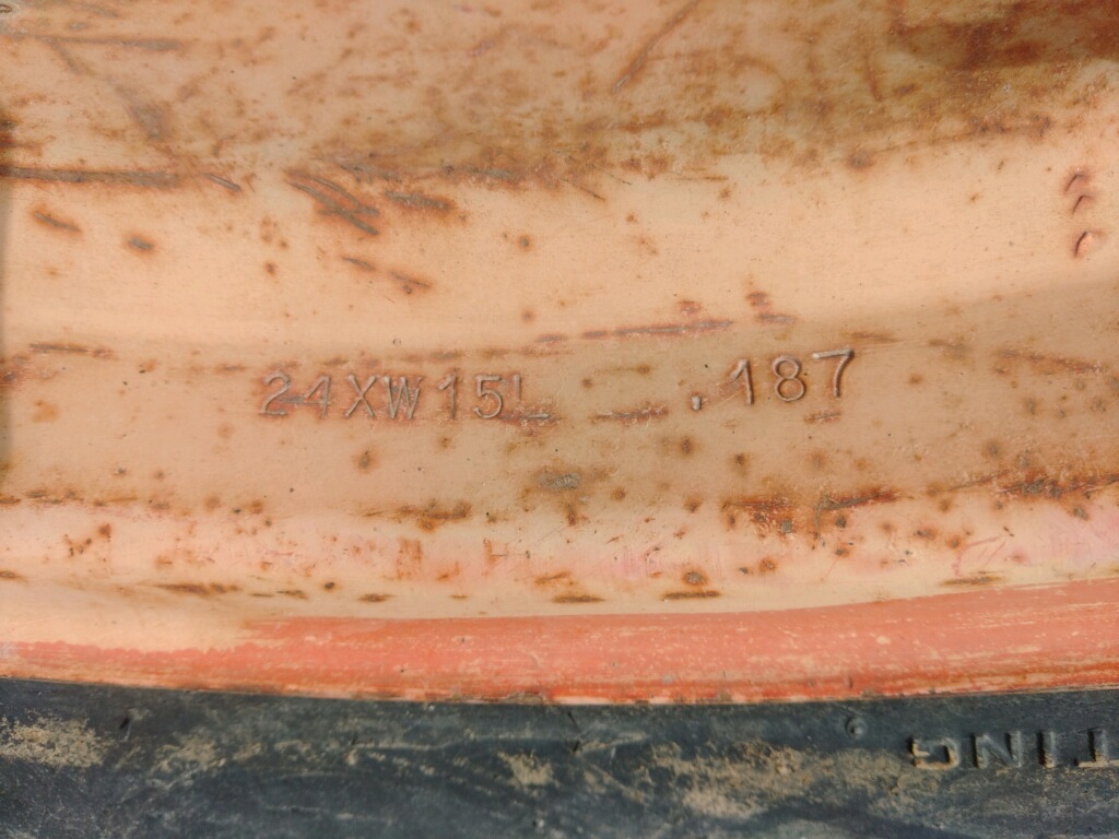

The rim on it 24 tall 15 wide. I can't find that combo for less than $800. The rims like he suggested are only 10 wide. I don't know much about tractors, but that seems like too large a difference to me.

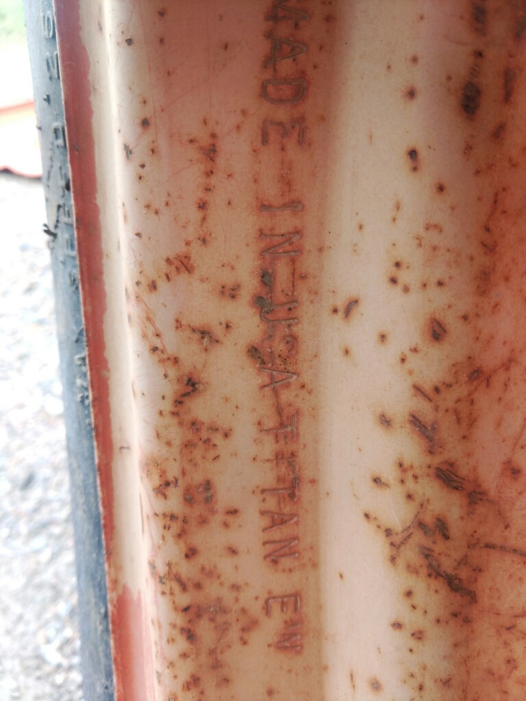

Looking at the pictures the rim is stamped 24XW15. Plenty of 24 x 15 tractor rims but six not four loop. Moving the loops would be a pretty simple nodification.
Your tire size would normally fit 12 or 13 inch rims.
