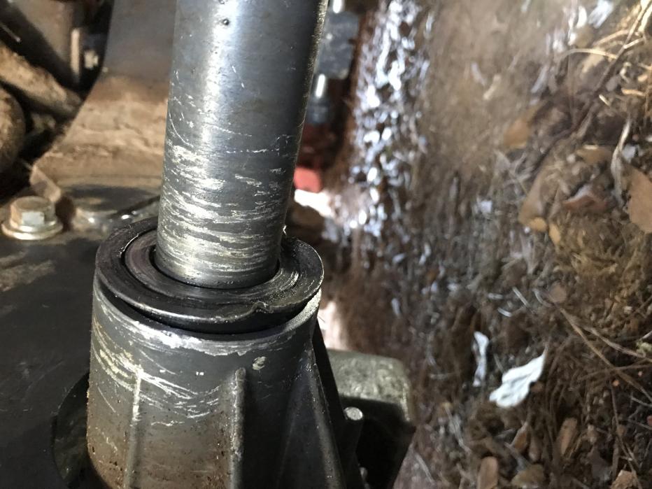

I went out to start my BX23s this morning and noticed a leak that was seemingly coming from one of my rear tires. Upon further inspection, it looks like I tangled with some barbed wire (picture #1).
The damage (picture#2) appears to be my ball bearing + oil seal.
Understanding that this is my first tractor and I am a novice (to put it mildly), I have two questions: (1) am I right about this being the part I have damaged? and (2) can I do this replacement on my own? If so, any good tutorials? The stuff I have found so far on the forum doesn't explain simple things like how to get the axle off.

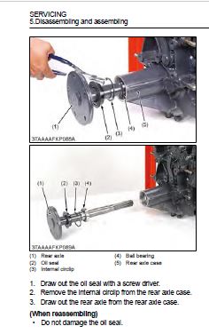

Then go to page 4-51
You pull /pop seal with flat blade screwdriver (already done for you by wire) , remove external clip, pull axle then remove inner clip, pull bad parts, reverse and reassemble, done.
