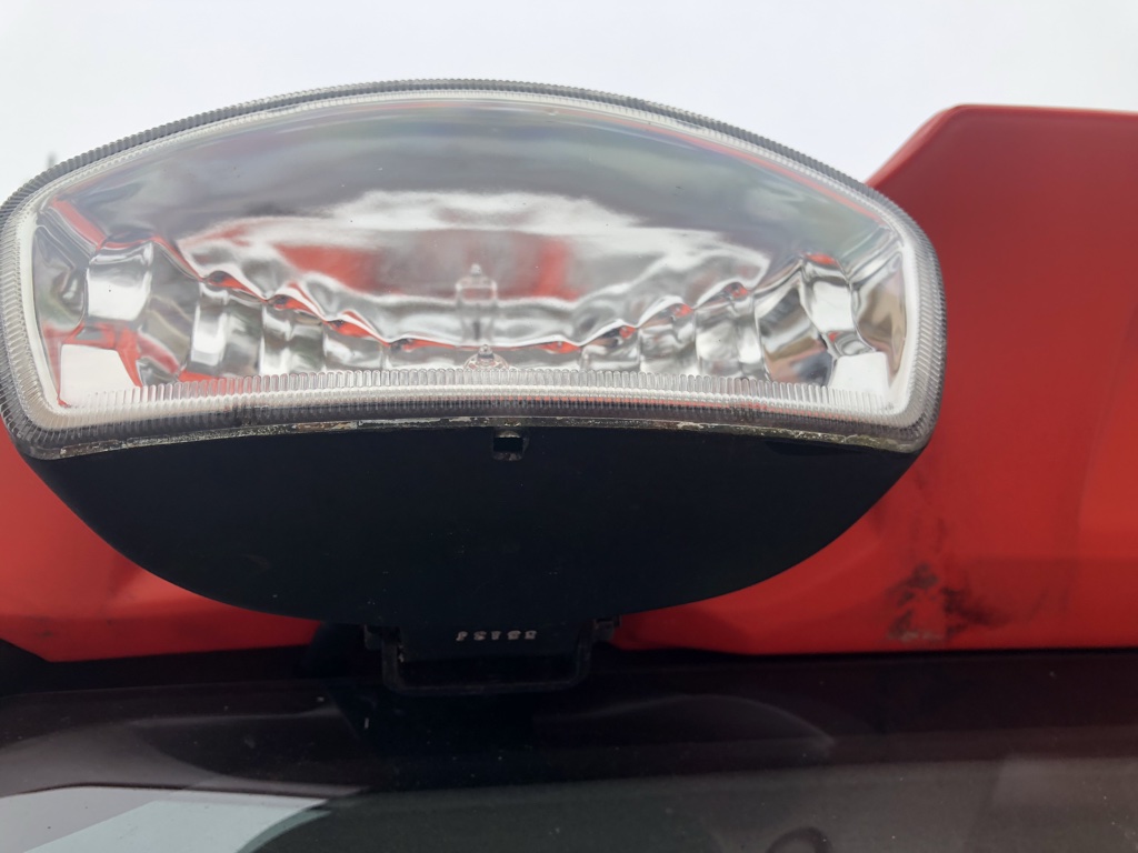

Hi, I'm relatively new to the forum and a new (to me) tractor owner. I have a L6060 and want brighter work lights on the front and rear of the cab. Instead of replacing the whole light, I just want to replace the halogen bulb with a LED bulb and see how it goes. I can always add a LED light bar if I need more.
I just tried to remove the clear plastic lens, but I don't want to force it too much. There's a small square hole in the middle bottom of the lens. I presume you put something small and push up and out? I just don't want to break the lens.

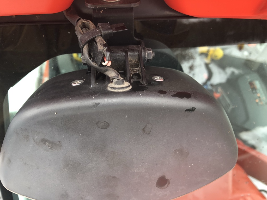

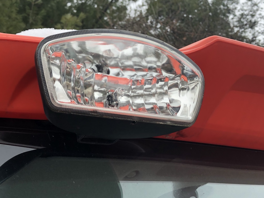

Hi Rcflyer330,
I took some pictures of my work lights. Do you think they are the same as yours on the B2450?
I see the two screws at the back. So if you take the work lights off, and unscrew the two screws, the front lens and reflector comes out and you can then replace the bulb?

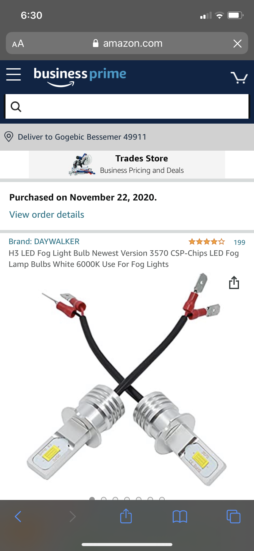

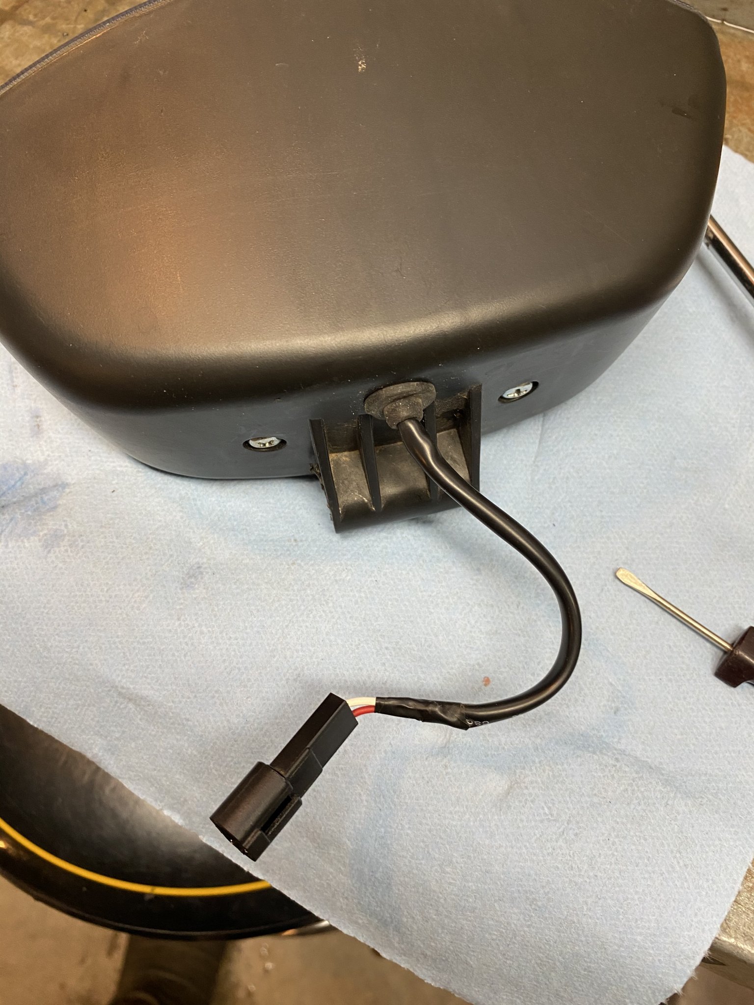

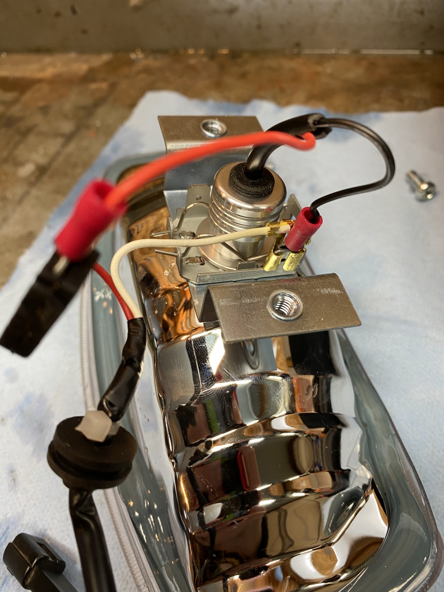

Installed my LEDs today, plug and play. Took about 5 minutes a light once removed.

View attachment 51222 View attachment 51223 View attachment 51224
Yes those are the same as on my B2650

they worked great. Plug and play. See my pictures in the above post.

Hi Michigankubota, thanks for the write up of your install. Yes, please let us know if the new LED bulb is brighter than stock.
Also, the stock bulb, did it only have one wire from it? I noticed your new LED bulb has two. The LED I found on Amazon.ca only has one. I want to make sure the one wire LED bulb will work too.

One or two wires should work. The negitive wire just goes through the body of the bulb if its a one wire bulb.
Thanks,
Paul
Stock halogen has one power wire and is grounded through the body of the bulb. My LED has its own ground wire that I plugged next to the OEM ground. As stated above, one or two wires should work.
