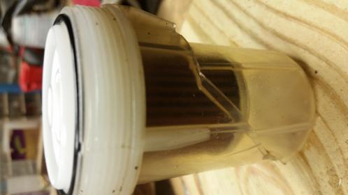

Filter was cracked, allowing fuel to squirt out continually ...here's picture of it removed once I got line plugged. Thanks all for input.

Looks that you have lost the clear cup which spins into the black head. The filter element is a separate part. Also there is a large o-ring and a tiny o-ring which fit on the top of the filter element.
If you can find the clear cup that's one less part to replace. Otherwise you will need the four parts: cup, filter element, large o-ring, and tiny o-ring.
Hope that the threads on the black head are not stripped.
When you get it together, turn the air vent cock knob to the left a bit. Start the engine and let it run about 30 seconds. Then shut down and turn the air vent knob to the right and closed. If it won't start after that, crack the air vent knob and try again. You will need to throttle more than idle to clear the lines. You should not need to open anything else other than the air vent cock.

Jim..Thanks and here is a better pic of cracked fuel filter. I've got an L3800

Yep, just changed an L3800 fuel filter yesterday.
I would see if the filter will come out of the cup easily. Remove the outer o-ring and save it in a baggie. If the filter gets torn up trying to remove it you know to buy a filter with the new cup. If the o-rings are undamaged, then re-use them.
When installing the filter into the cup, lube it with diesel fuel and not dry fit. Easier to remove if you need to. The filter must come straight out - you can't twist it out because of stops.

Got new assembly today as it was actually cracked too. Removed aand Reinstalled the 3 hoses and mounting screw easily. Less than $30 for entire assembly at dealer. Allowed filter to fill with diesel. Had some airlock occur after 30 seconds or so initially. Was able to keep rpm's up to allow fuel system to get back to running normal on its own. Seems to be back to its old self now and ready to go to work. Thanks to all on OTT.
