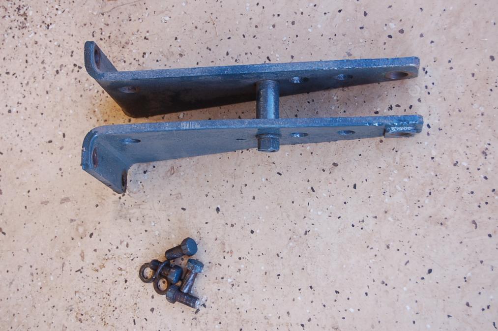

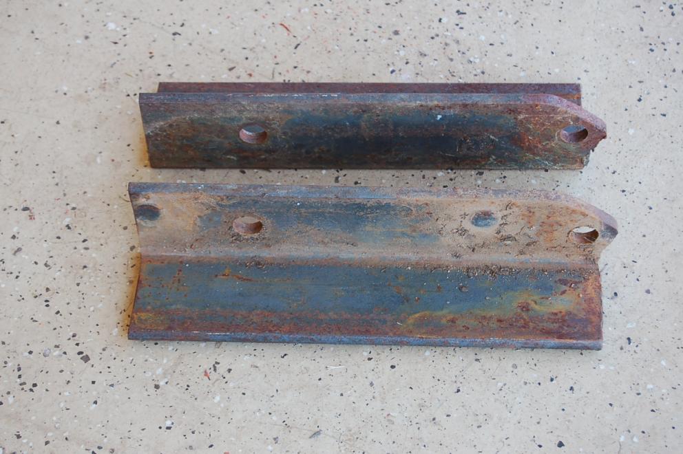

I am going to replace the stock 12" long center link mount
I need to be able to accommodate a post hole digger,
I have two pieces of angle iron that will work, already have the correct holes for the pin.
The only question I have is, "how much space is required for a standard post hole digger"? :confused:
I understand that the 1.625" on the 12" is probably not enough.

I was hoping someone could just give me the dimensions for a stock L175 bracket.
If worst comes to worst I'll just make it over sized and call it good.

My large cat 1/2 PHD is only 1" from the center of the pin to the back side.
My 3 point center link bracket is 1 3/4 from the back of the case to the center of the holes.
