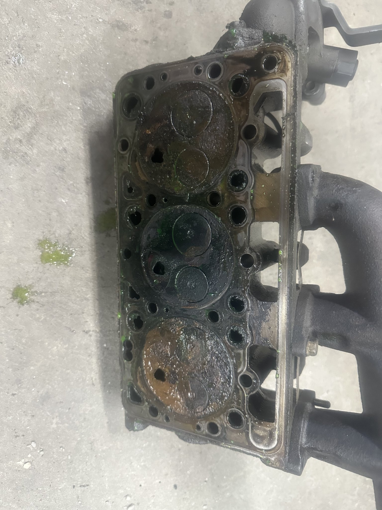

Where’s the best place to buy a new or reman D902 cylinder head? I’ve seen the ones on eBay but didn’t know how good they were.
Recently picked up a B 2360 as a non-runner. After pulling all the glow plugs, I crank the engine over and antifreeze were shooting out of the number two cylinder and the injector cup is completely gone when I pulled the injector out of that same cylinder.
When I pulled the head, I saw that it was cracked there by the valve as shown in the picture.
So it looks like I’m in the market for a another cylinder head

While not the cheapest, I've gotten several heads form Kumar Bros, and have had no bad parts.
