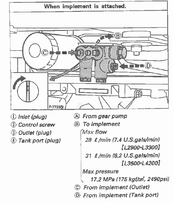

Here are the connections from the tractor to the loader. Pretty damn simple.
Your main symptom is the loader will not lower so a simple test of that circuit:
WITH THE TRACTOR OFF AND THE LOADER IN MID AIR
  1. Disconnect the hose at C and put it in a bucket.
  2. Move the joystick to BOOM DOWN and you should get a flow of oil into the bucket as the loader drops under its own weight.

Would someone be able to fill in the table in this picture with valve port numbers. This would help me sort out my problems.
thanks
This is the file
An example of what I am hoping for is.
A-3
B-1
C-2
Boom extend-
Boom Retract-
Bucket curl-
Bucket dump-
OK, you're in luck, nephew's L3600 was handy.
1 IN B on TheOldHokie's diagram
2 OUT (Tank) D on TOH's diagram
3 (Power Beyond) C on TOH's diagram
4 Boom up, extend
5 Bucket curl, retract
6 Boom down, retract
7 Bucket dump, extend
4 Boom up, extend
If the boom will float the workport couplers and tank are working. My guess is the coupler on C is not. Easily verified in a matter of minutes as described.
That would also have the pump relieving full time through the pressure relief (2500 PSI.) and the 3pt would not be working along with the loader.
