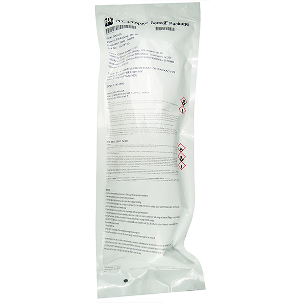

Diesel tanks are a mix of several layers of material mainly PP ( polypropylene )
Trying to heat weld PP is pretty much impossible to do.
How big is the hole?
If it's not too big and not torn you might be better of using a plug patch.
Stainless Toggle bolt and nitrile rubber patch.
Or use epoxy patch like this.
