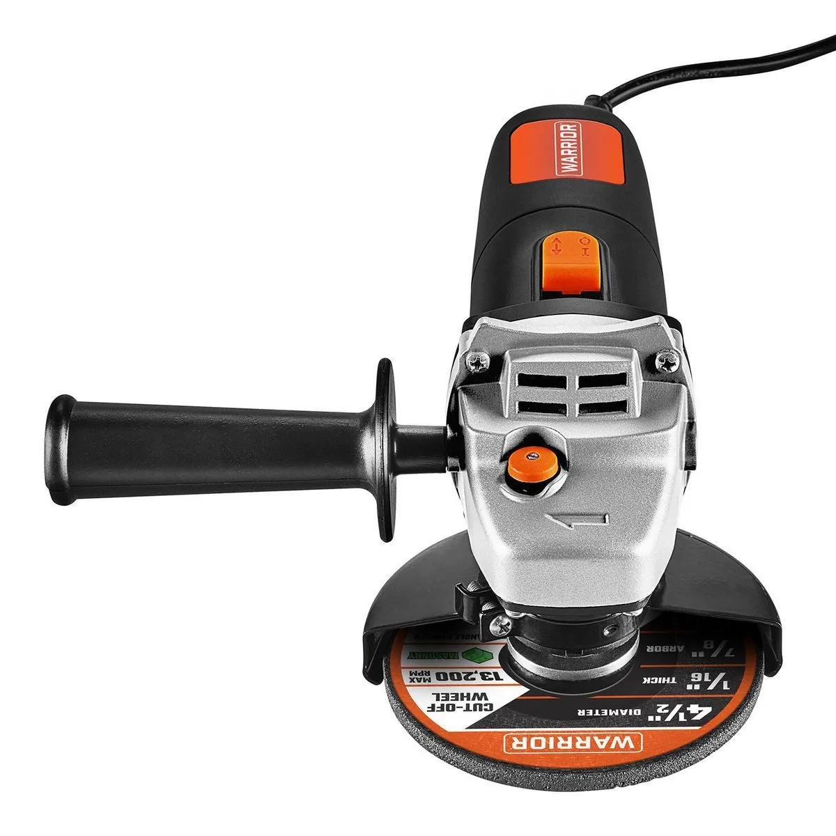

Since you state the obvious I can see it is very highly probability IMHO. My wife calls me Captain Obvious for a reason. LOL How about one of these? JK!
