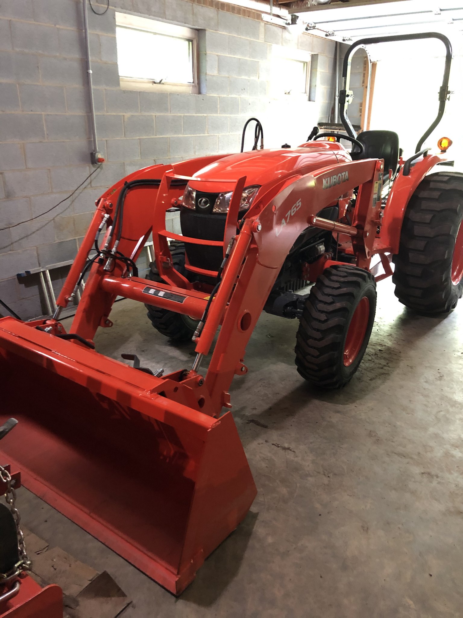

It is nice that the level spot I have is concrete in a building but all you really need is a level (or more accurately, flat) area the length and width of the tractor + loader.
