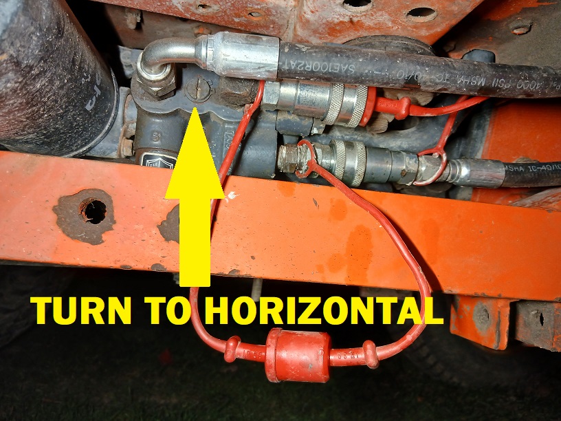

I have an L3010 HST with an LA481 front end loader. I had a soil pulverizor attached to the three point hitch and since I was working in tight quarters, decided to remove my FEL to give me more room to maneuver.
After removing the FEL and quick disconnects for the hydraulics, my three point hitch wouldn't work. A quick look at ChatGPT suggested I needed to connect the hoses, etc, etc - WRONG. (ask me how I know).

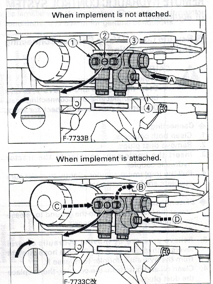

Went to the Operators Manual and there it was. On the hydraulic manifold under the floorboard, you simply turn the screw from veritcal to horizontal when removing an implement. Simple.
