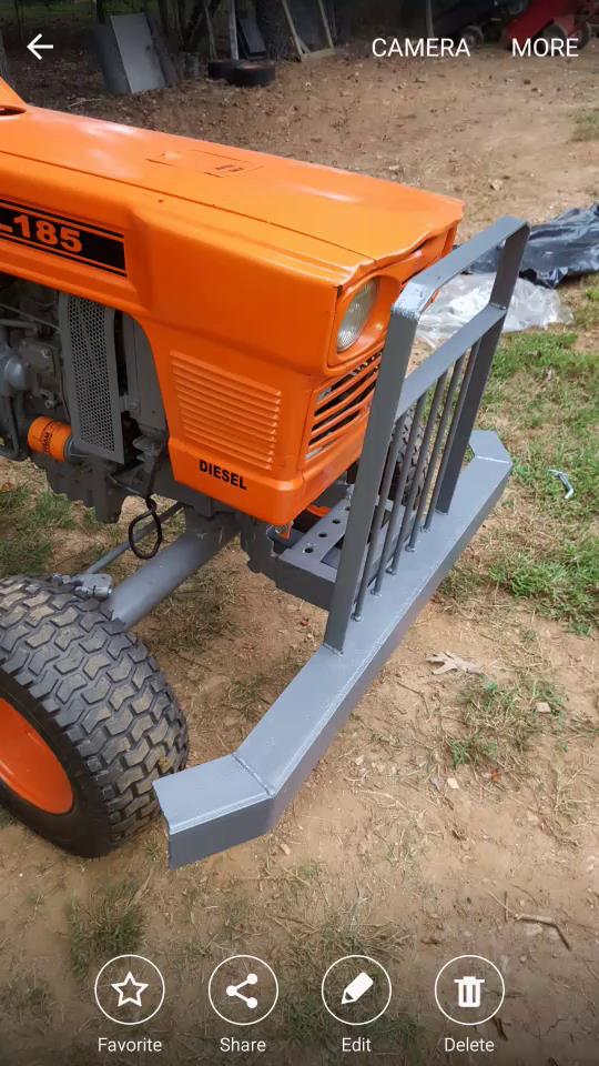

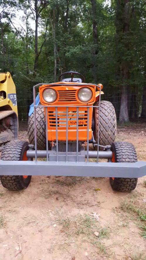

very nice work! nice to able to swap out as you need. Nice welding too.

Looks really nice. Does it fit tide enough, so it will not shake while driving? How heavy is it?

I put guides on the bottom of it to stop the shaking maybe a quarter inch give and take maybe less 30lb lite enough for me to take on and off easily

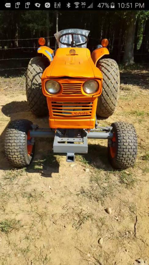

Was thinking about something for the front. For the hitch bar pin, im going to use a j-bolt and drill a hole in reciever tube for short part of j. As nut tightens, it will press against hitch bar and snug it in place.
