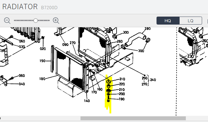

D dallcow43 New member Equipment kubota b7200 Aug 9, 2021 3 0 1 starkville miss Aug 28, 2023 #1 I have a Kubota b7200 and I am trying to replace the hose that goes from the water pump to the engine. Need to remove the radiator to get to it but cannot get the radiator out. It is attached from the bottom. How does it come out? Hellllp!

North Idaho Wolfman Moderator Staff member Lifetime Member Equipment L3450DT-GST, Woods FEL, B7100 HSD, FEL, 60" SB, 743 Bobcat with V2203, and more Jun 9, 2013 30,552 6,600 113 Sandpoint, ID Aug 28, 2023 #2 2 bolts on the bottom
N3BP Active member Equipment B7200DT, B7200HST-D, L2900GST, L3010 HST TLB Sep 20, 2016 473 202 43 Lebanon, PA Aug 29, 2023 #3 Radiator attachment mounting ears..... Attachments RQRP2405.JPG 127.2 KB Views: 145
N3BP Active member Equipment B7200DT, B7200HST-D, L2900GST, L3010 HST TLB Sep 20, 2016 473 202 43 Lebanon, PA Aug 29, 2023 #4 Disregard my previous post. Those ears are for the fender mounts. Attached is the correct location for the radiator mounting bolts. Attachments IMG_1093.JPG 154.4 KB Views: 142
D dallcow43 New member Equipment kubota b7200 Aug 9, 2021 3 0 1 starkville miss Sep 1, 2023 #5 N3BP said: Disregard my previous post. Those ears are for the fender mounts. Attached is the correct location for the radiator mounting bolts. Click to expand... Thanks a bunch. Hard to see but I got to them and got it off.
