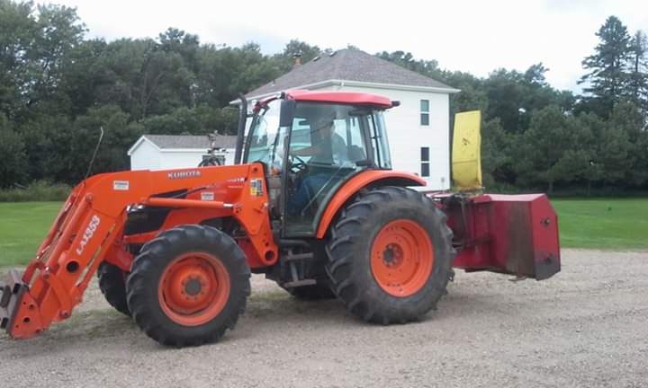

P.S. This photo was taken in July....today you can not see bottom window on the house from this angle!!!
