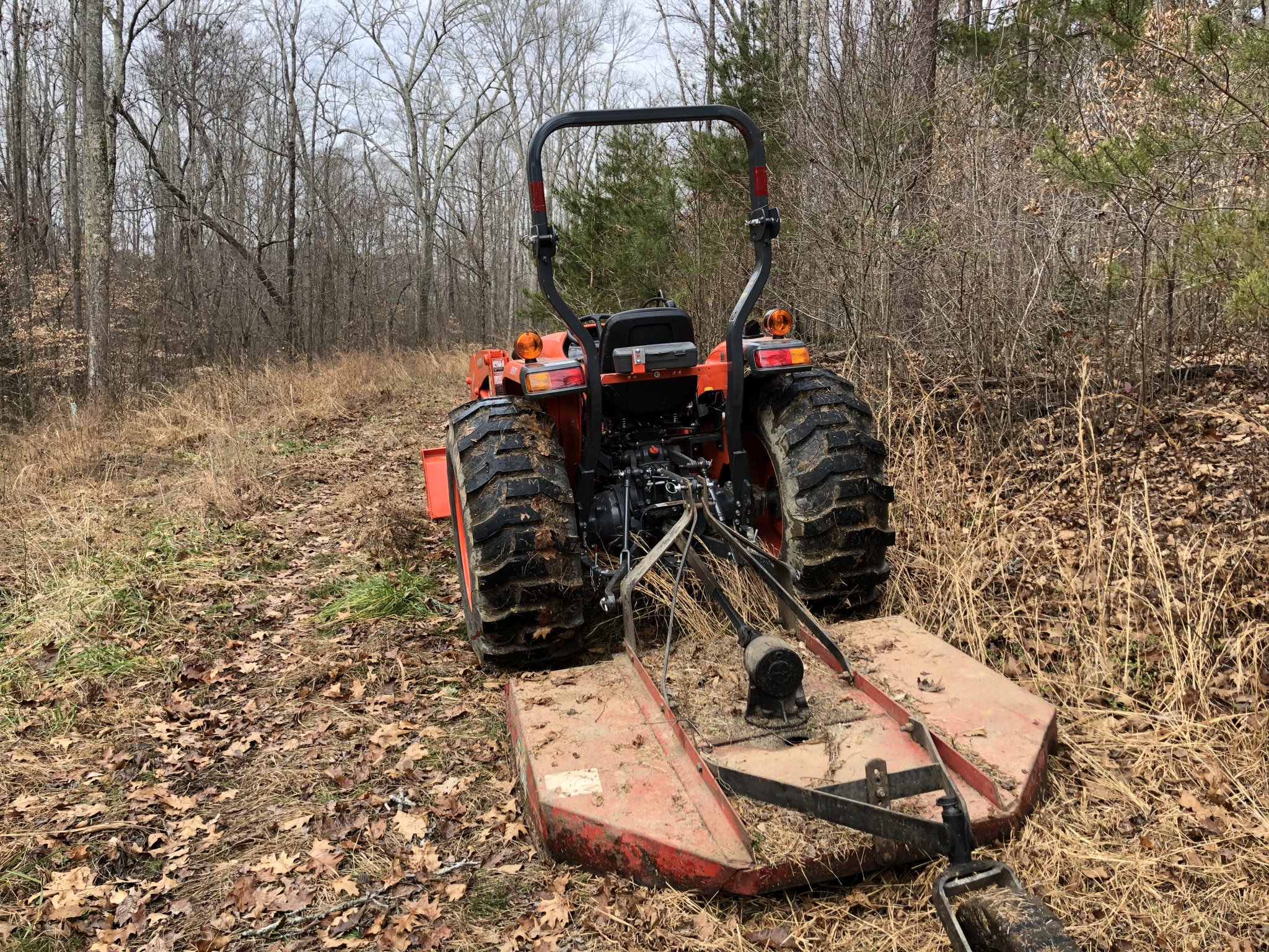

This is controversial but I run a 6 foot light duty Landpride cutter behind my L2501 which is rated at 19HP PTO. The type of trail maintenance , material I am cutting, the topography of my land has not been an issue. It also lets me "cut back" the trails a bit due to the 6 or 8 inches wider per side than the tractor rear tires.

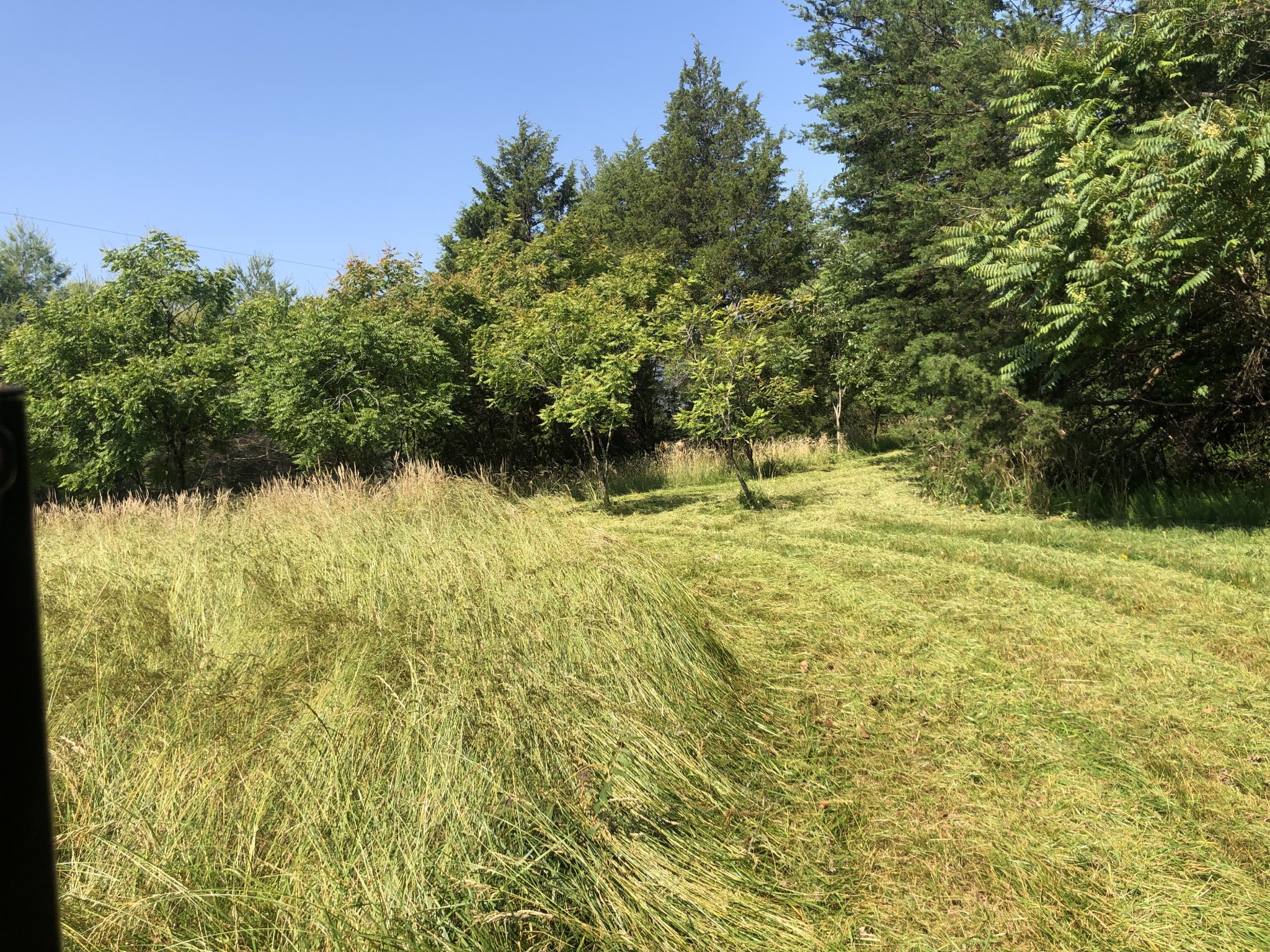

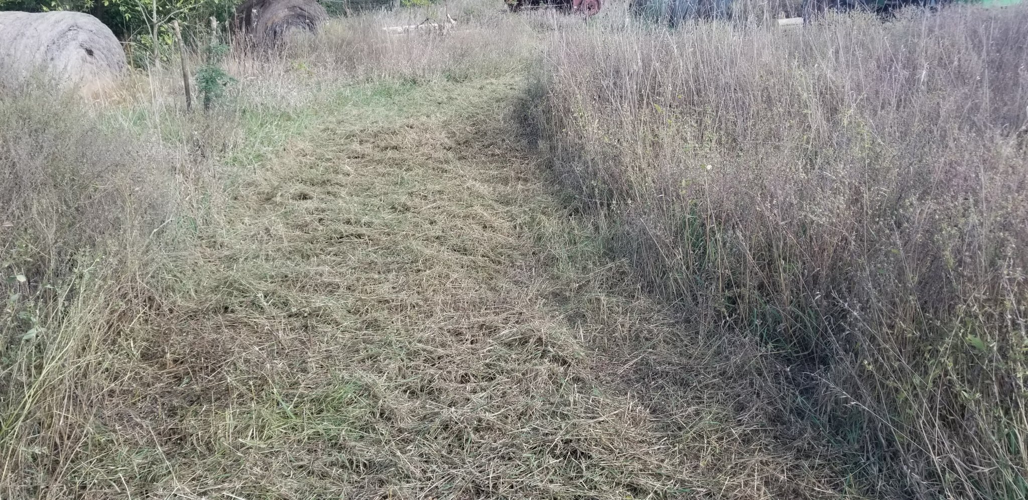

Russell made an excellent suggestion. I would add, if you mowed with a flail mower you would soon wish that belly mower was not on your tractor. That flail will mow as well, if not better, then the belly mower for the yard and the taller material. Because of your love of that mower.....don't get a flail!!! :)

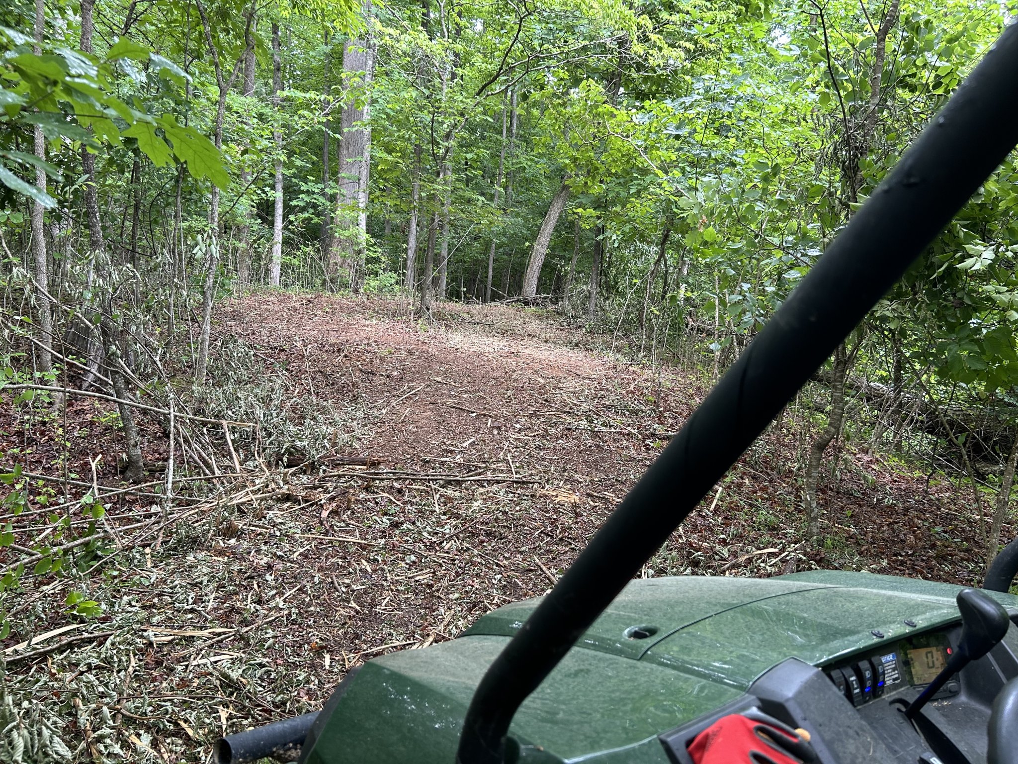

This gives you an idea of what I cut with my flail, and when cutting short grass is looks like you cut it with a 21" push mower, just a whole bunch faster.

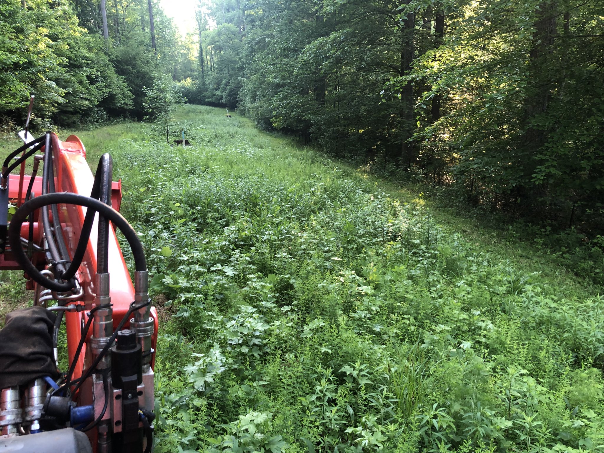

I haven’t bought a rough cut mower recently. Only thing I have to add is in regard to the heavy, medium, light duty. I have a Howes 500 Economy grade rotary cutter (about 570lb 5’ deck) for rough cutting areas we mow once or twice a year to keep trees from taking over. This is the sort of stuff it cuts.
Before (various native grasses, various forbs, and a lot of sweet gum saplings)

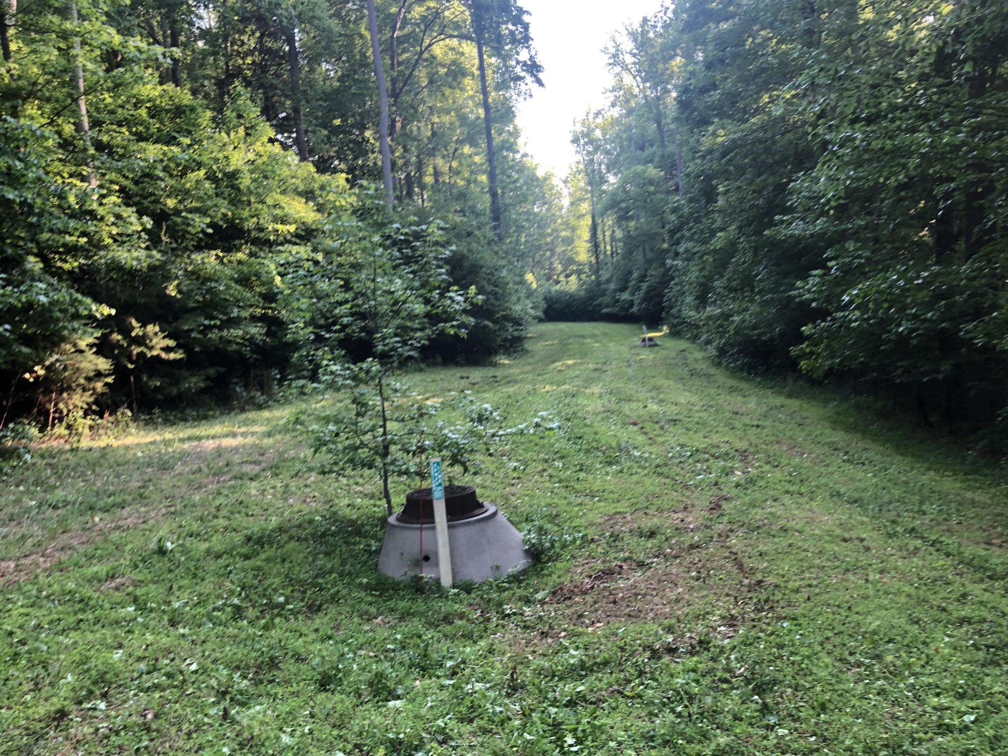

After
Partially done grasses, mostly broom straw with some I don’t know what all mixed in.
The busted up sticks on the left side of the pic are the remnants of 10’ to 15’ tall mature witch hazel bushes that covered this hill. Cut about 3 of them with a chainsaw. Didn’t like fighting through the branches searching for the base with a Husqvarna 455 on a 95 degree day. I decided to see if the Howes could live up to its 1.5” stem rating. After a couple of slow passes, it ground them to chips.
That’s a light duty rough cut rotary cutter doing light duty stuff. If you’re just mowing grass, regardless of height, I don’t know why you’d have any need (or use) for a medium or heavy duty cutter.

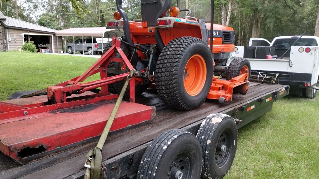

So I'll be doing that in the morning when I pull the front wheels to drop them off to have the new tires put on. It'll be my first opportunity to inspect the horse's teeth, so to speak, because I purchased the rig sight unseen from a fellow about 150 miles away and had another guy fetch it for me.

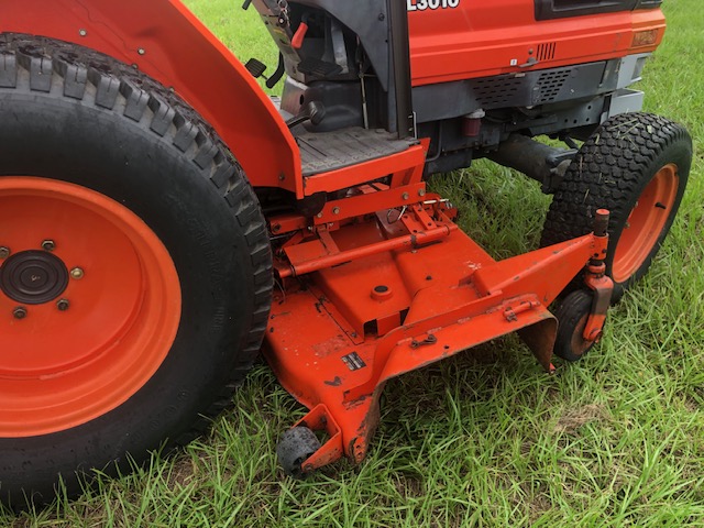

The tractor itself is exactly as represented, and I am perfectly satisfied. However, I've already junked the rotary deck because the gear box failed under a light load (cracked the cast iron housing dumping all the 80W gear oil). Shear pin failed when the gear box broke, and that's actually when I discovered it had crapped out as the tip off something was wrong was looking behind me expecting to see mowed grass, and it wasn't being mowed.
Anyway, since the deck itself was Swiss cheese with rust, I had already planned to fabricate a replacement - until - the gearbox let go. So that plan went out the window and I put it on the street. And no, not the end of the world because the seller made no representations whatsoever about the mower deck. No bad feelings about it failing, just one of those things.
Meanwhile, the belly mower deck looks, maybe not new, but definitely decent. Like it's experienced, but not trashed - or so I hope - but there has to be a reason he didn't use it. I'll find out soon enough.
So whilst I've no clue why the seller didn't use it, it was 'the' major appeal. However, I've never used a belly mower and have no clue how effective it'll be. Expect it to be very effective else Kubota don't make them, right?

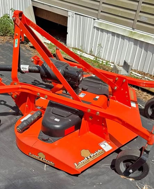

Anyway, I have found an interesting deal on a Land Pride finish deck model where the seller wants $2000 and the deck's virtually unused (claims only 3 times). But, it's a finish deck instead of a brush hog. Not really sure that helps me. Or at least no more so than a flail mower would. And per D2Cat, a flail will be less trouble because he mentioned ho little maintenance he's had to do (none?) and I know from experience how much work is involved keeping mower blades sharp. These are photos of the finish deck. New they're $3300 so at $2k the seller wants it's gone.
Anyway, if I were shopping for a finish deck, I'd have bought this one already. Good brand, good price. Meanwhile, I continue nosing around for a used rotary cutter or flail.
