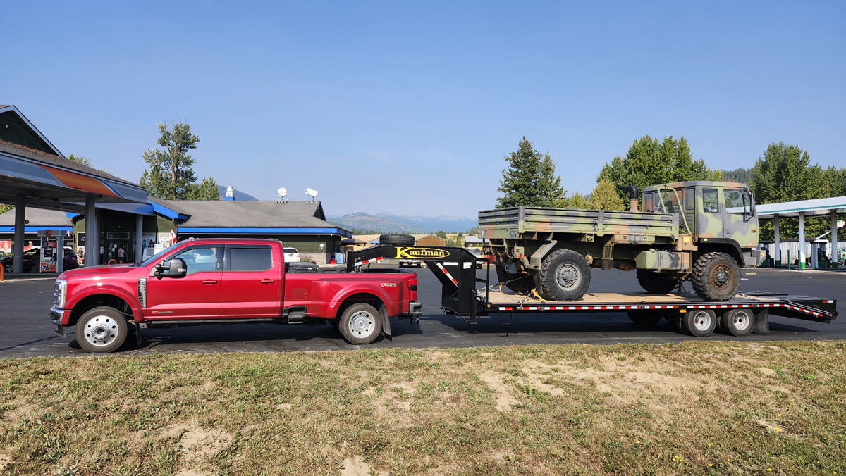

You could buy some quality ratchet straps to haul that tractor. Chains and binders are nice to have, but if you don't plan on hauling stuff fairly regularly I would think that straps would be the better choice since they could come in handy for other things.
I have a bunch of chains and binders but also have four really high quality ratchet straps that a friend in the US Coast Guard gave me many years ago. He used to fly around in a C-130 and he gave me a set of four of the straps that they used to secure equipment inside the aircraft. I've hauled many things a lot heavier than your L2501 using those straps and they've worked well. But I generally like/prefer chains and binders for most hauling because of the durability when exposed to a lot of use/abuse.

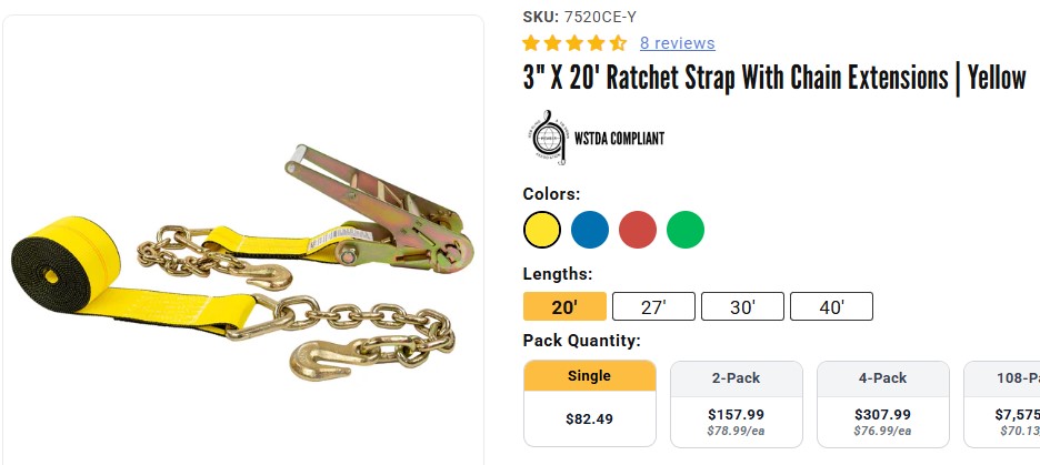

I recently bought a couple of ratcheting binders from this company because I wanted/needed more than just the four Peerless that I have. They specialize in trucking type equipment and the binders I bought are very well made.

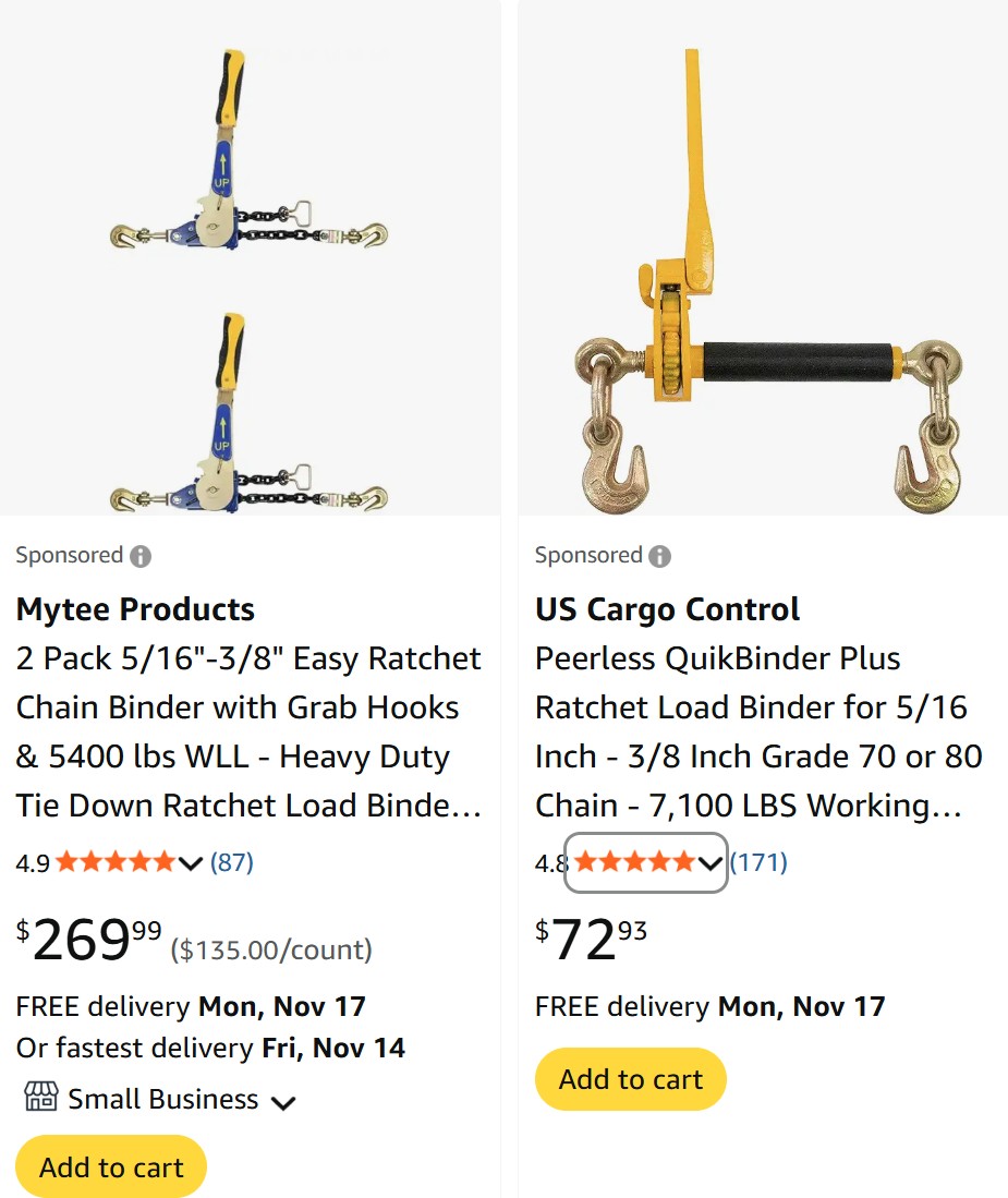

I get most of my stuff from Mytee Products. Website is here:
There are two types of binders that I use and like
1) Peerless Quick Binders - these are pictured on the right
2) Ancra EZ Binders - pictured on the left. these are all that I use now. They are much faster to use.
Shop around to find them at better prices. Black friday is coming soon.

Yep, those are the same ones I have. I bought the four Peerless binders a few years ago at a local heavy equipment dealer, but took your advice and bought the Easy Ratchet binders through Mytee Product's website.
I realize that the EZ Binders have gotten pretty salty lately, so, they aren't for everyone. I just know that when I was digging fairly regularly, I didn't want to mess with regular binders at the end of a long hot day.
The peerless are pretty decent (easy to use) and can be found at a pretty good price occasionally.
