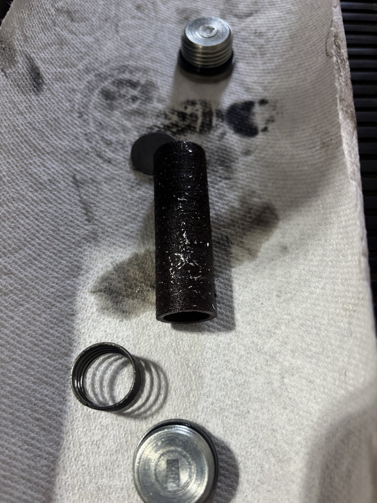

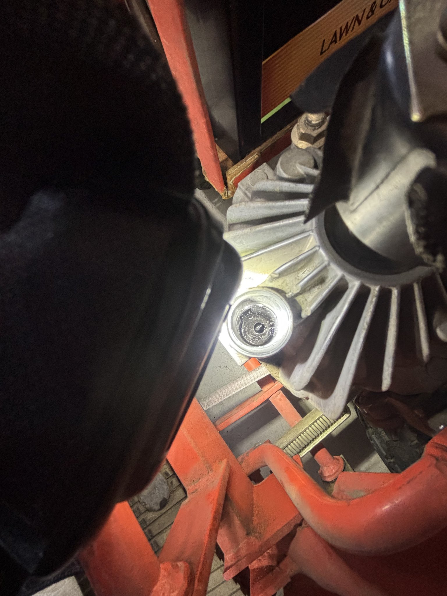

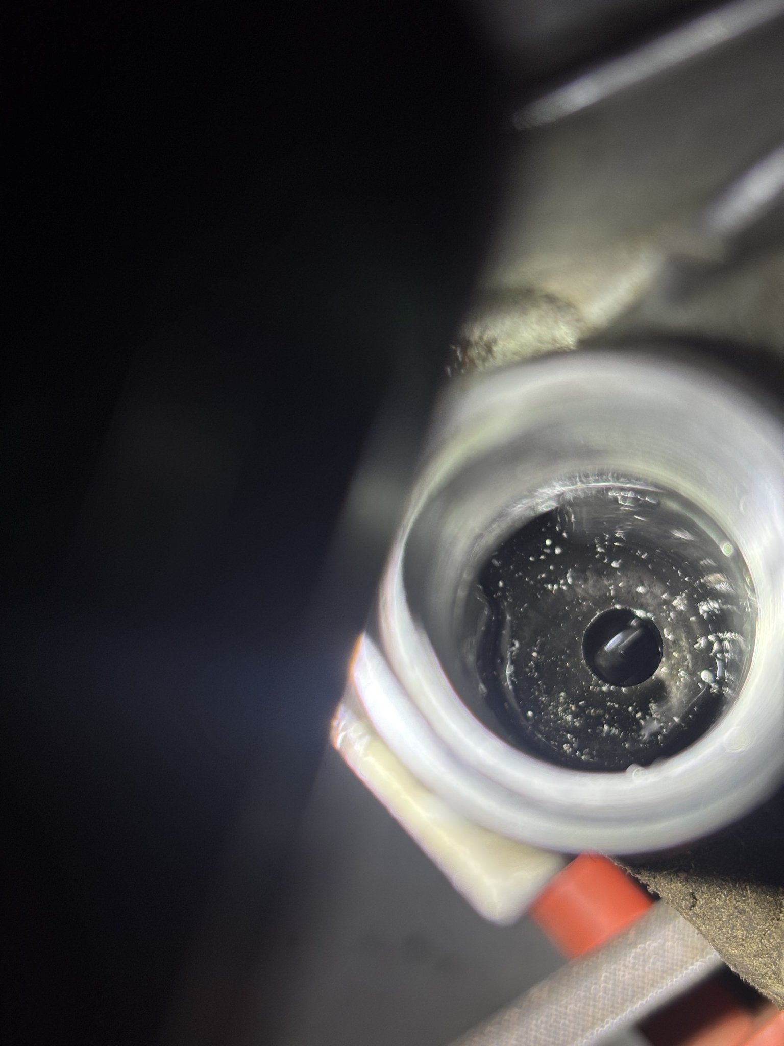

Yes, I've verified everything is connected properly up to the HST. However I just re-emptied the HST fluid and pulled the HST oil filter and see flecks of metal on and around where the oil filter resides... so I assume something is broken internally in the HST???
33,470
8,747
That's a sign that the pistons and plates are eating each other.
33,470
8,747
Lack of maintenance, dirty / contaminated filters and fluid.
