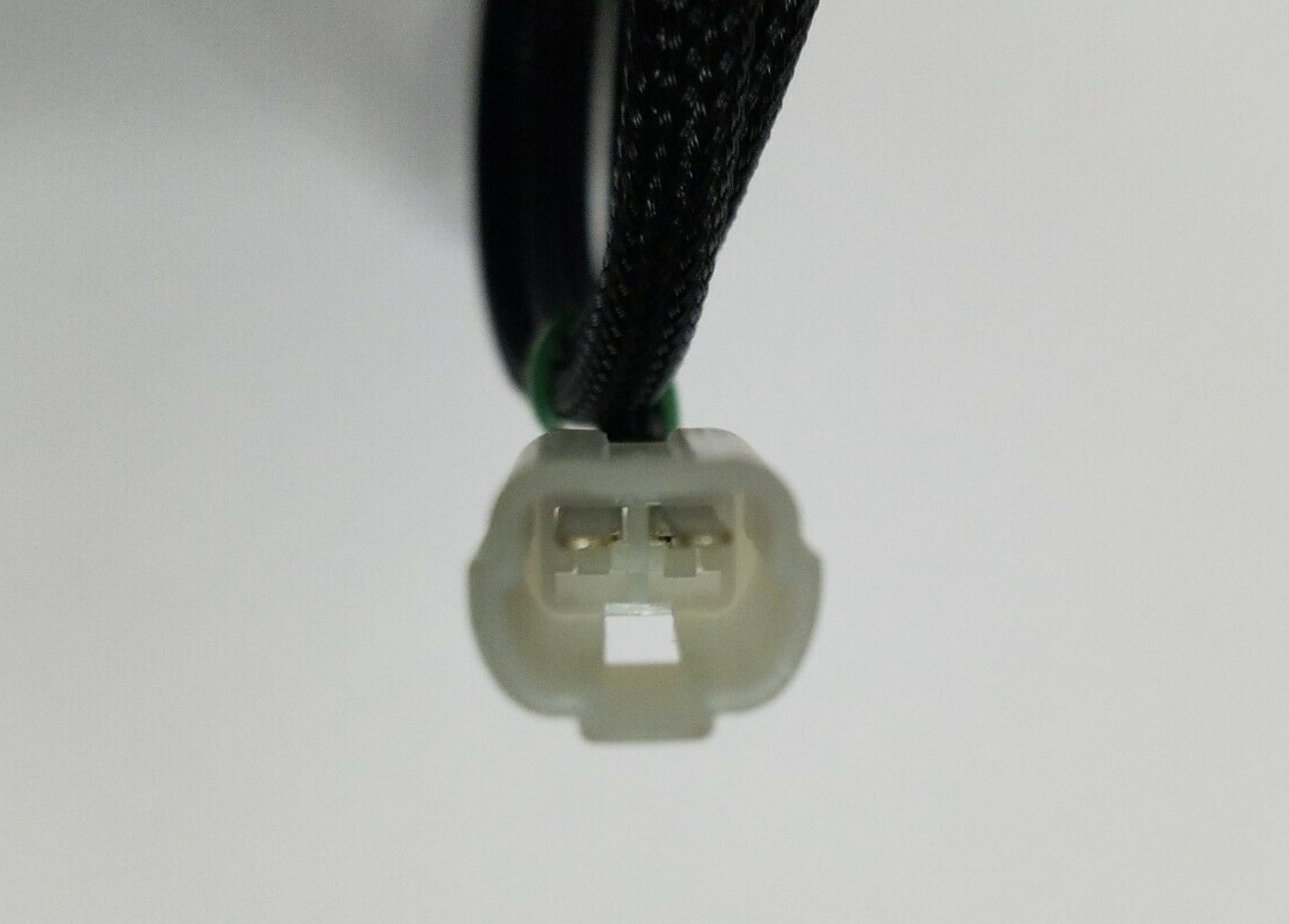

Here is a picture from that add of a straight on shot of the connector.
Thank you wgator.
That's what I need. I just sent an email to the seller asking if she has 4 "complete sets" of the male/female connectors. I hope so....
