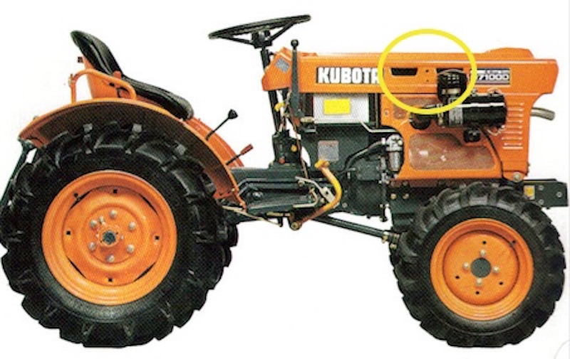

Older models used to come with a rear view mirror, sometimes as an option. In the pic below, you can see the mounting holes on the hood of the B7100. But they were the first things removed when FELs were installed. When I was doing a lot of box blade work, I planned on making some magnetic mount mirrors to stick on the FEL uprights, but I had bigger fish to fry and very little time for cooking. Now that the BH is mounted pretty much all the time, I will probably never get around to the mirror project.

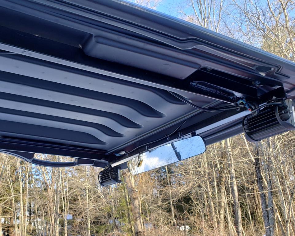

I mounted a golf cart mirror on my canopy. It takes a little getting used to being such a wide angle mirror but that actually makes it better, the field of view is huge.

A tall outside truck mirror mounted horizontally up high and inside my cab makes snow blowing with my pto powered snow blower a breeze. No looking backwards or strained neck muscles whatsoever. It's a real game changer for rear mounted snow blowers!

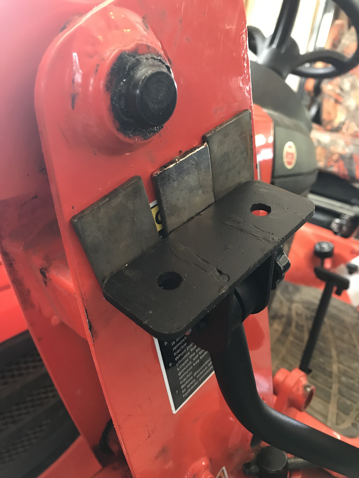

used extruded aluminum. opened the center holes to 1/4" and used bolts to hold everything together. to prevent/reduce damage to the loader paint, ouble sided carpet tape and cork strips were added to the aluminum.
