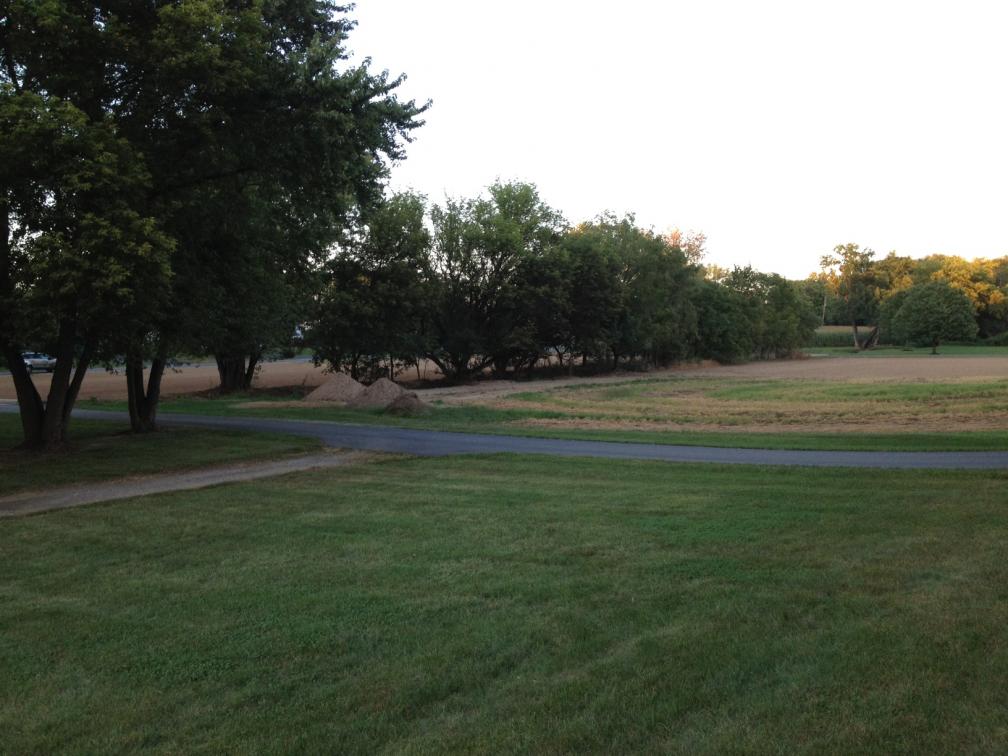

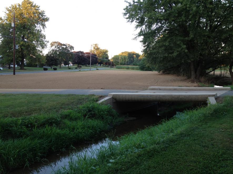

Finally used the box blade yesterday. As cerlawson said, they have two different applications. I've used scraper blades for snow removal for over 20 years and they worked very well. I also used them for spreading crushed stone and LOOSE soil with some success, but a rear blade won't cut into the dirt.
Here are a couple pics of what I did yesterday to transform a field into more yard. The land was fairly level, but there were humps and valleys near the driveway and road. There was a ridge along the road that a finish mower would scalp in places with a dropoff where the farmer worked the ground. We had about 12' of grass on the far side of the driveway since we built about 24 years ago. It always had a drop between the driveway and the field that had to go.
With the box blade it was fairly simple to relocate the dirt from higher places to where it needed to be. The piece I worked on yesterday is on the road side of the creek and is about 1/3 of the land we bought. In the first picture you can see most of the level land, and out of the photo to the right it gets farther away from the creek it slopes up to be about 10 or 12 feet higher at the top end. The part I worked on yesterday is on the road side of the creek. The part left to do now has a couple piles of topsoil that were scraped off for use on another project, so the work on that side of the creek is still a way off. Now to pick off some stones and toss seed on the nearly finished part.
