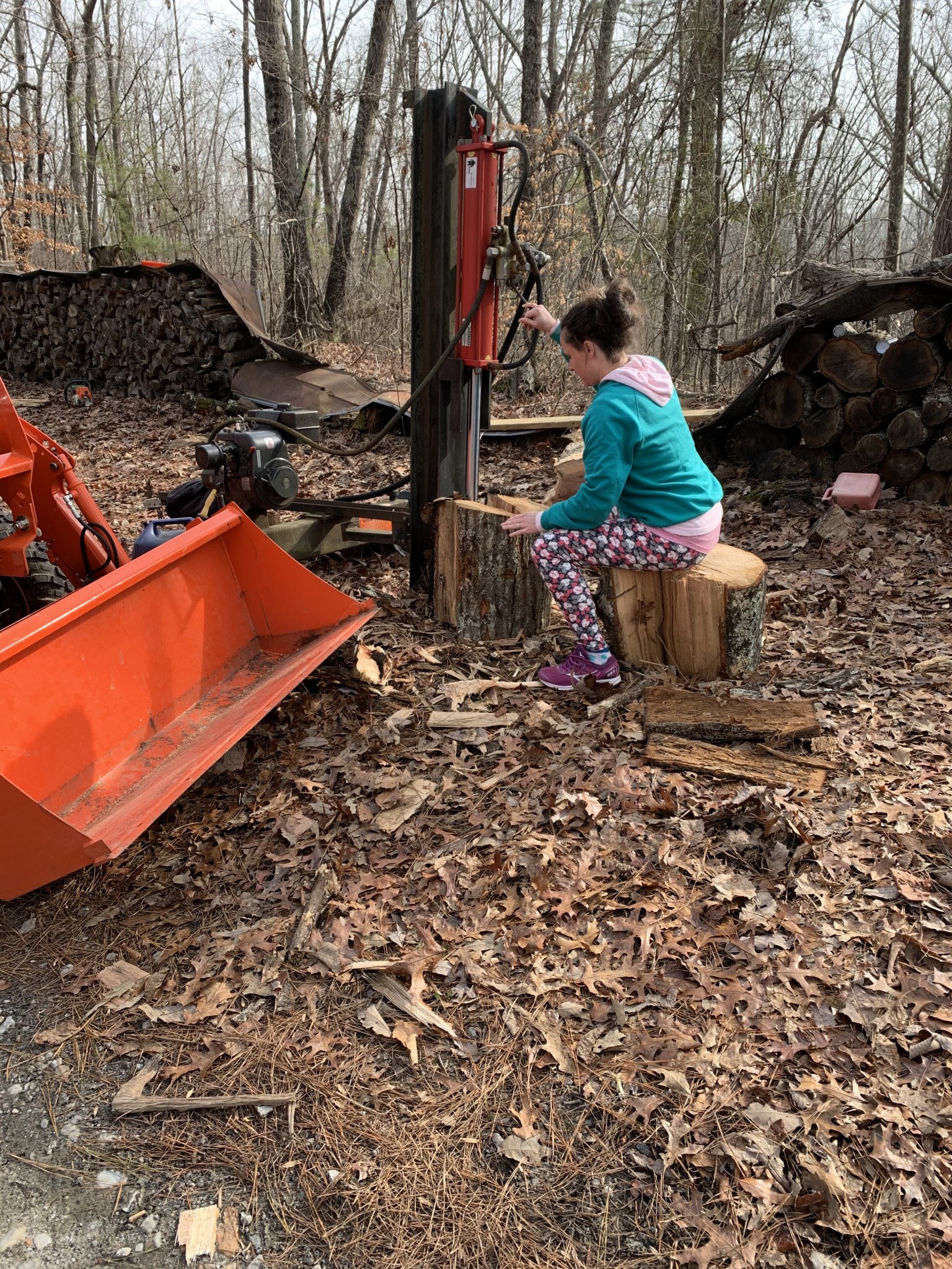

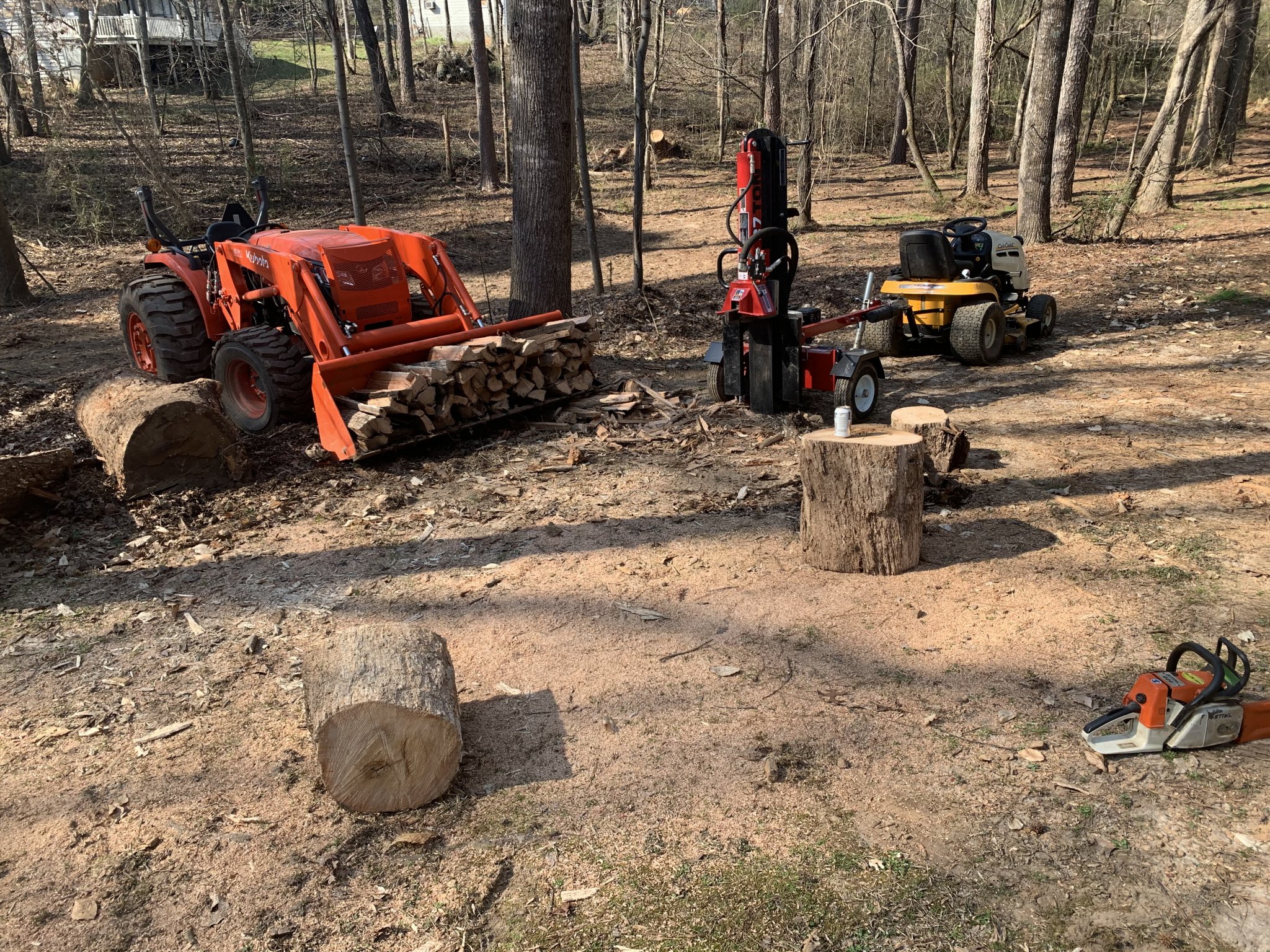

Is a stand alone splitter out of the question? That would free up tractor for moving logs/splits.
MX and my north star splitter.
LX and father in laws splitter.

Stand alone certainly has its advantages. Mine is a vertical 3ph with a hitch at the rear so I can go into the woods with a tandem trailer as well. Split wood, throw into trailer, come out of woods and haul home with my 4x4.
Makes sense. If the splitter has its own valve to operate ram (I assume it does) and it is open center, you can plumb into the backhoe circuit to operate from tractor.
