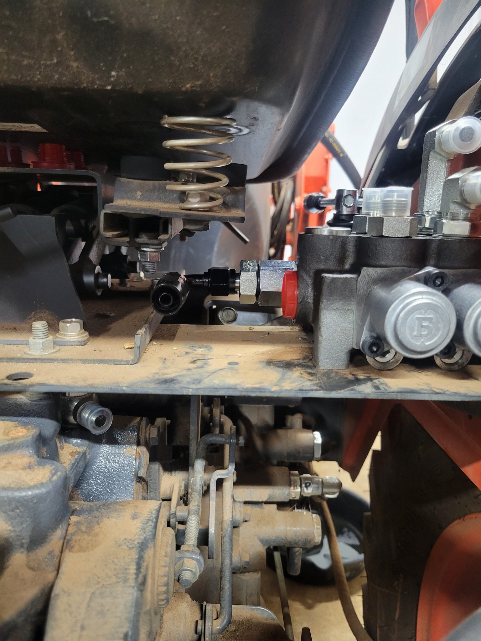

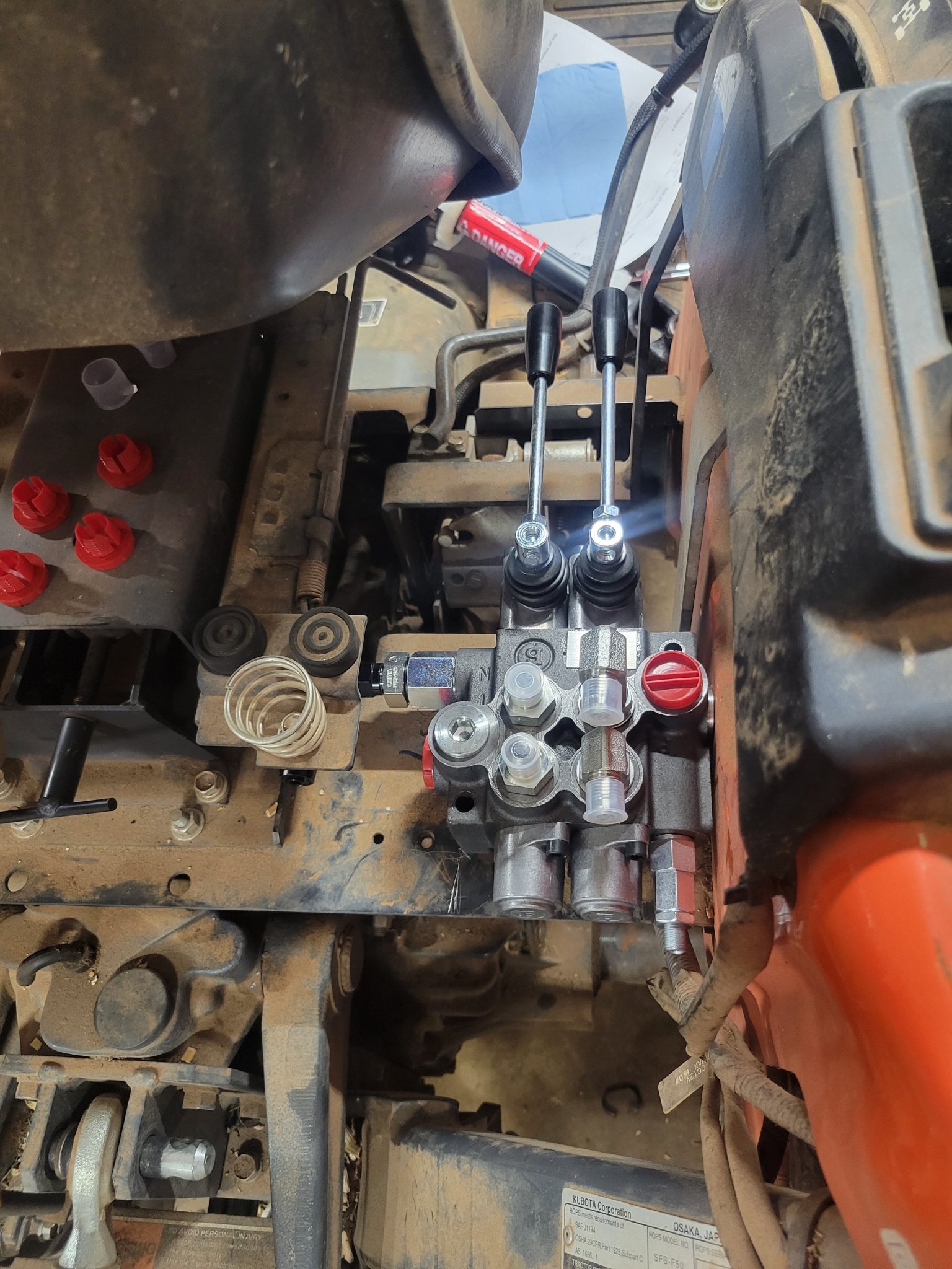

Okay - So I was able to get a used BH77 Installation kit from where I bought my tractor -another trade in that didn't have a BH but had the kit and the dealer allowed me to swap out parts.
I Installed a Summit 3rd Function valve at the same time. Everything went well.

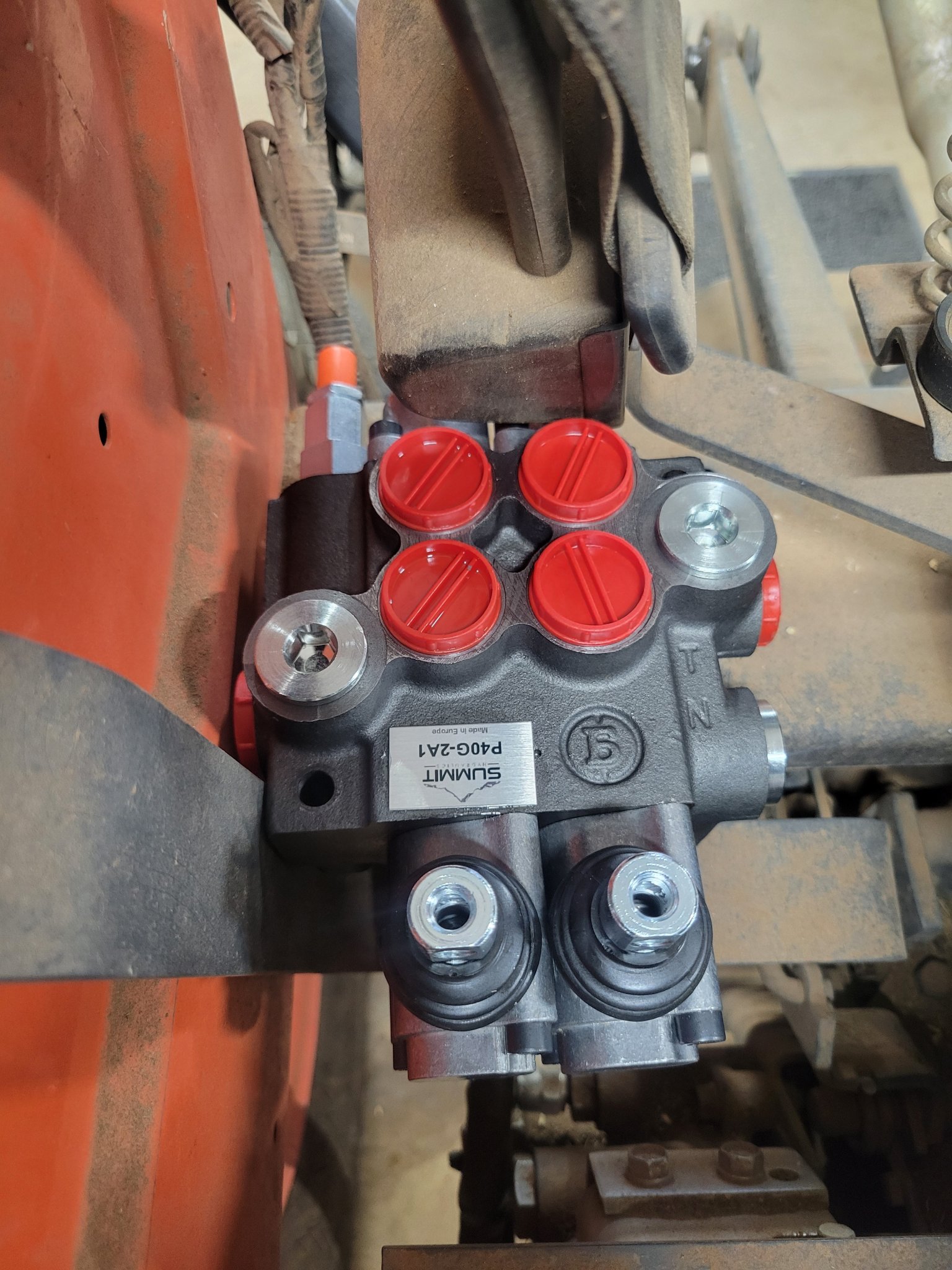

I removed the BH hardline from the PB port that bolts to the BH frame and I installed a SAE 8/JIC adapter with a JIC/JIC 90*into the PB port of the loader valve, and ran that to the 3rd Function valve on the loader frame.
I also changed the bracket location - the Summit bracket must be a multi use, and where it was to mount put it out in harms way:
I located it on the backside of the loader frame and drilled a new hole in the bracket - it seems much happier:
I brought the T line from the Summit valve back to the location where the BH hard line was bolted to the frame. I made a small bracket and installed a JIC/ 1/2 MNPT bulkhead fitting, added a 45* MNPT to install the original BH quick connect
I have the BH Hard line that returns to the 3PT on top of the transmission:
Everything seems to be good. I have a question in the next post.

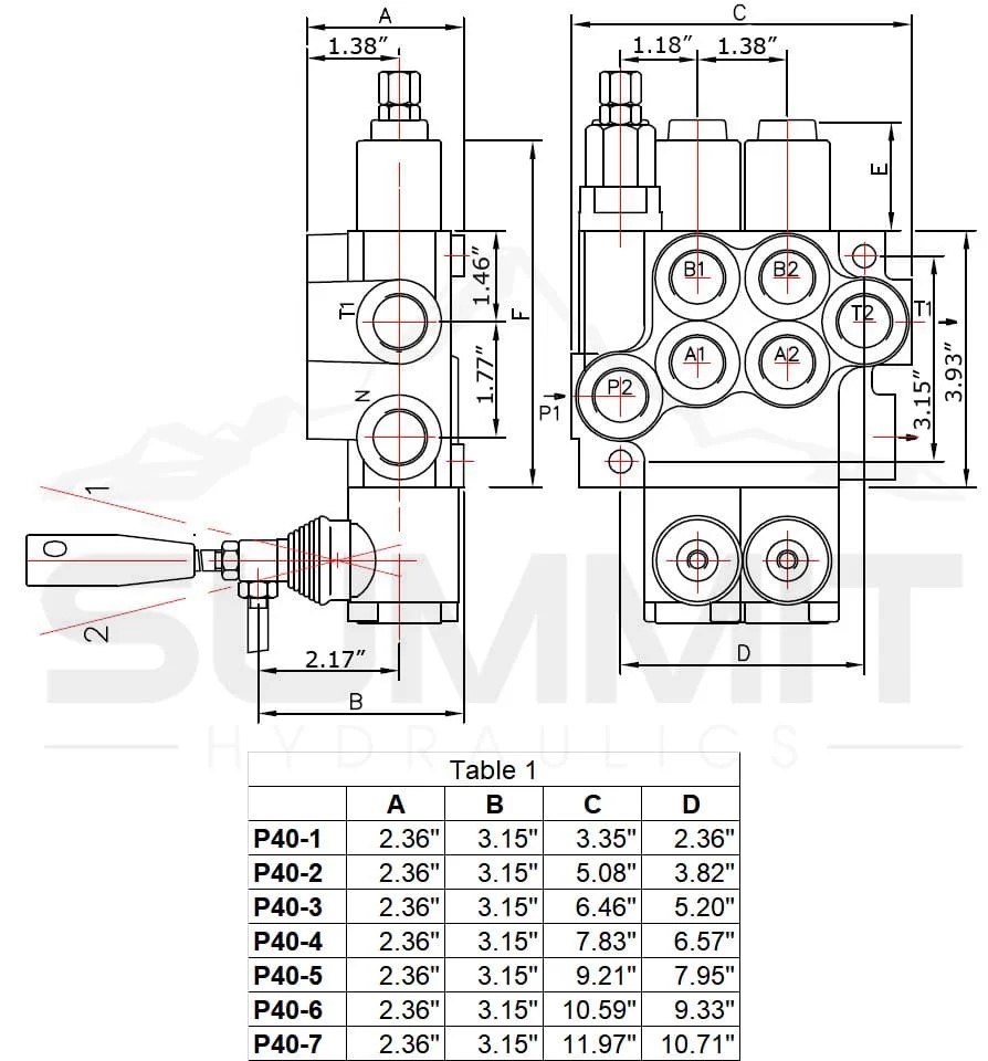

Thank you for the replies. So the 3rd function valve is a non standard valve that can handle hi pressure. The valve I use for the rear remotes will have to have a PB sleeve to feed the BH AND a Tank line to send low pressure "used" oil back to the T I put in the loader tank line. Am I getting that right?
Also I am looking at this valve - seems compact and should fit next to the seat. The 2 single valve setups seem to be out of stock. This valve also seems to make logical sense for a top and tilt use - up and down with float for Top and left and right to Tilt L& R

There is nothing "nonstandard" about the third function valve. It is a standard valve, just a different type.
The Brand joystick valve is a loader valve and is not well suited for your application. Something like this is much better
