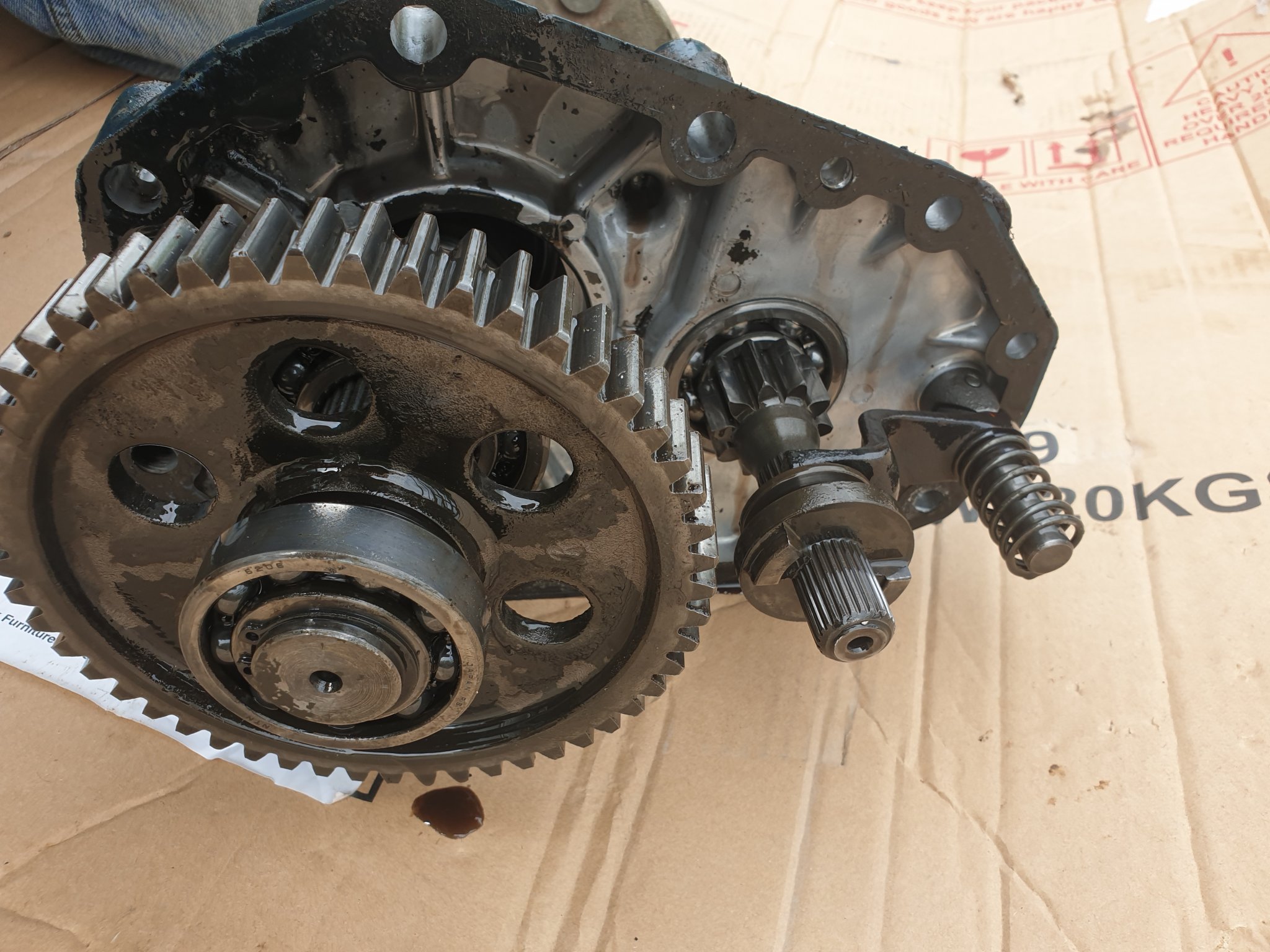

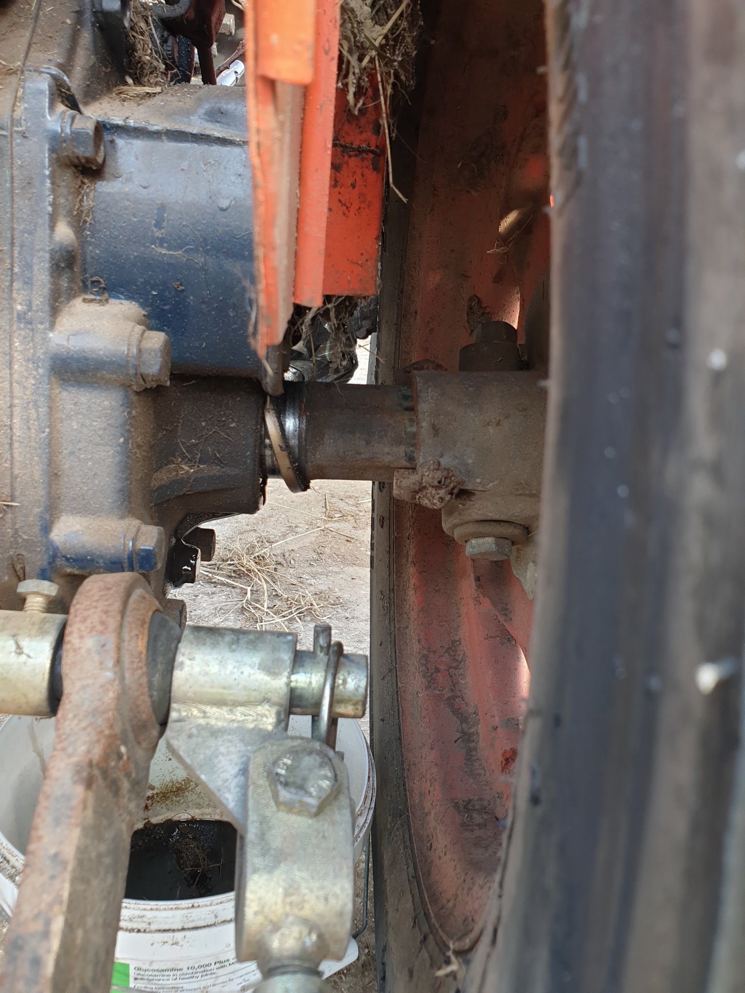

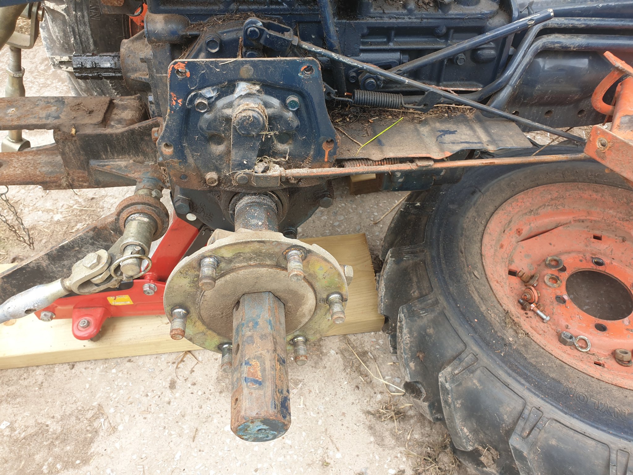

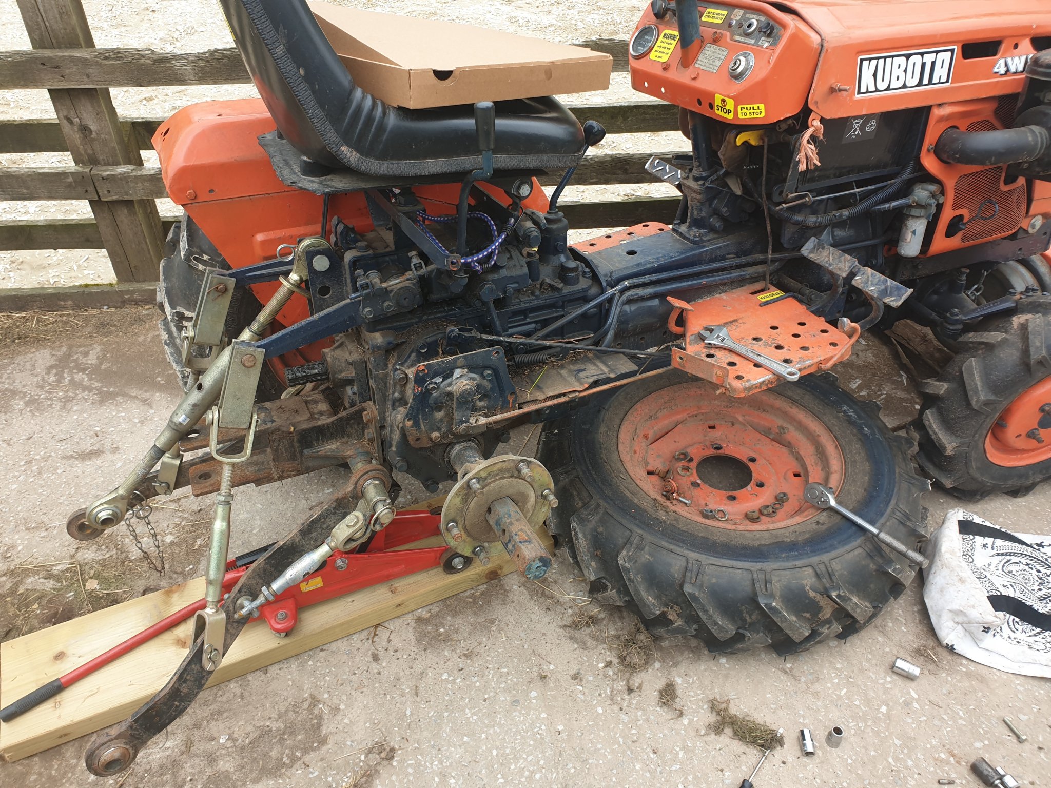

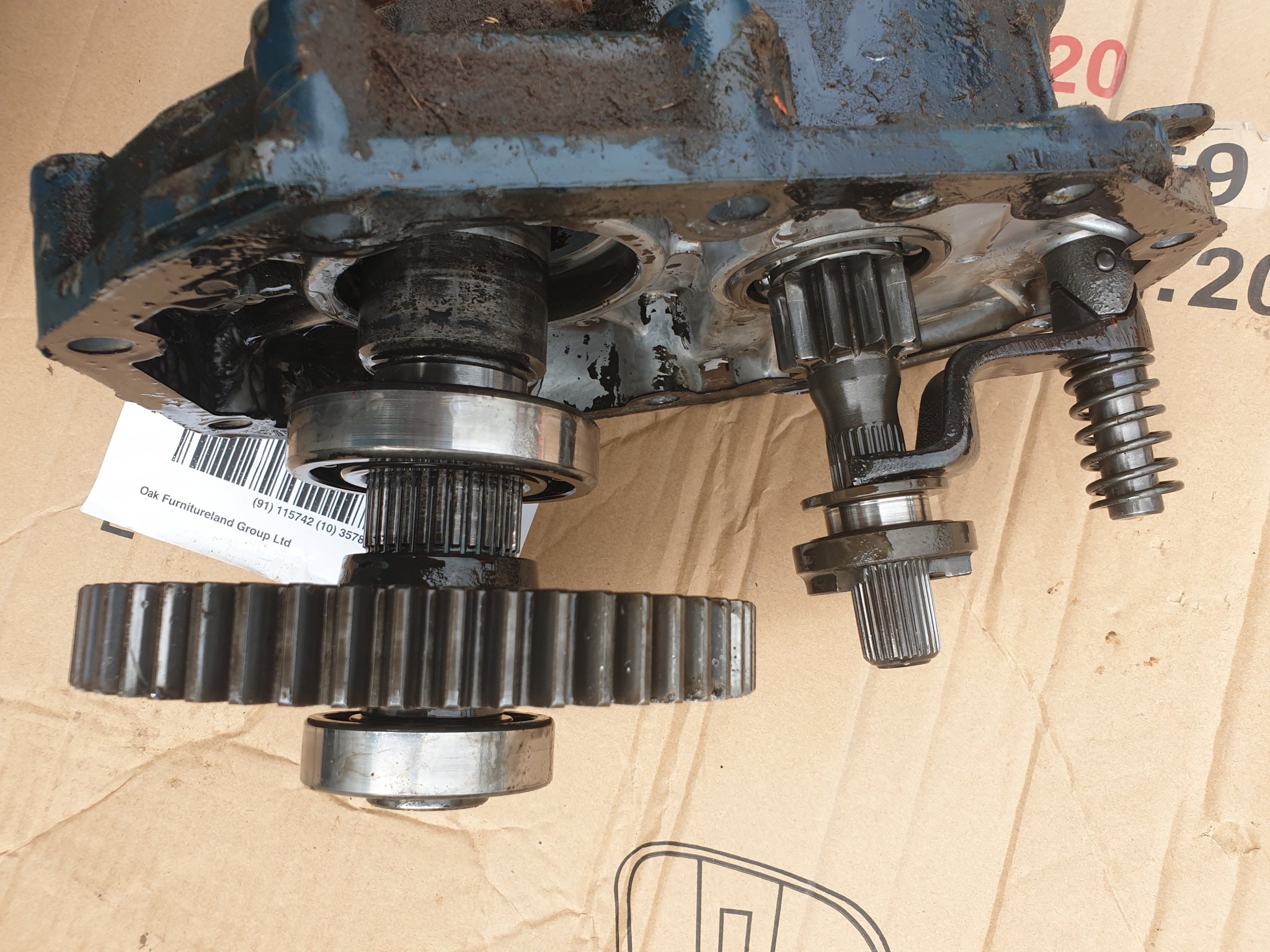

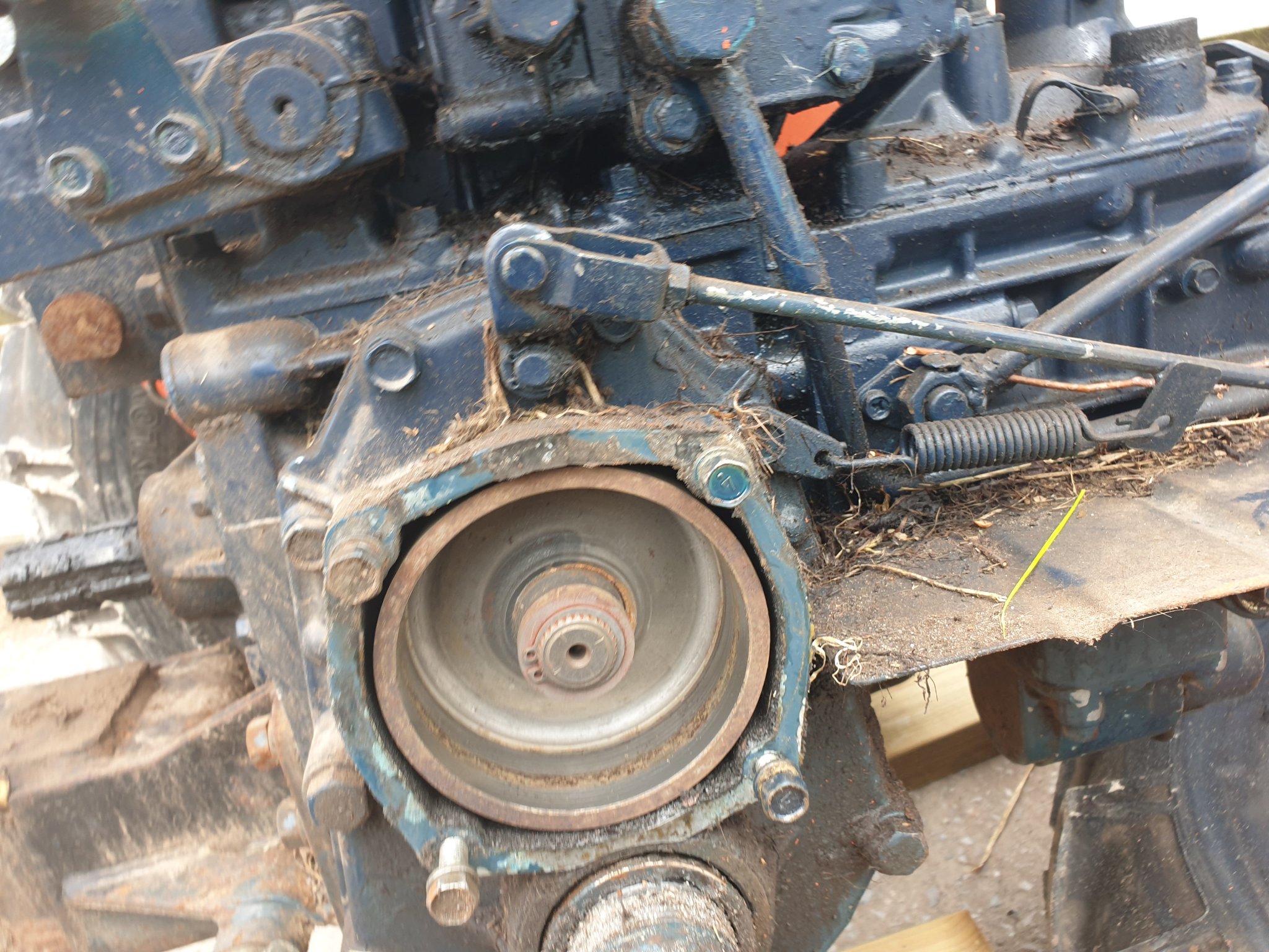

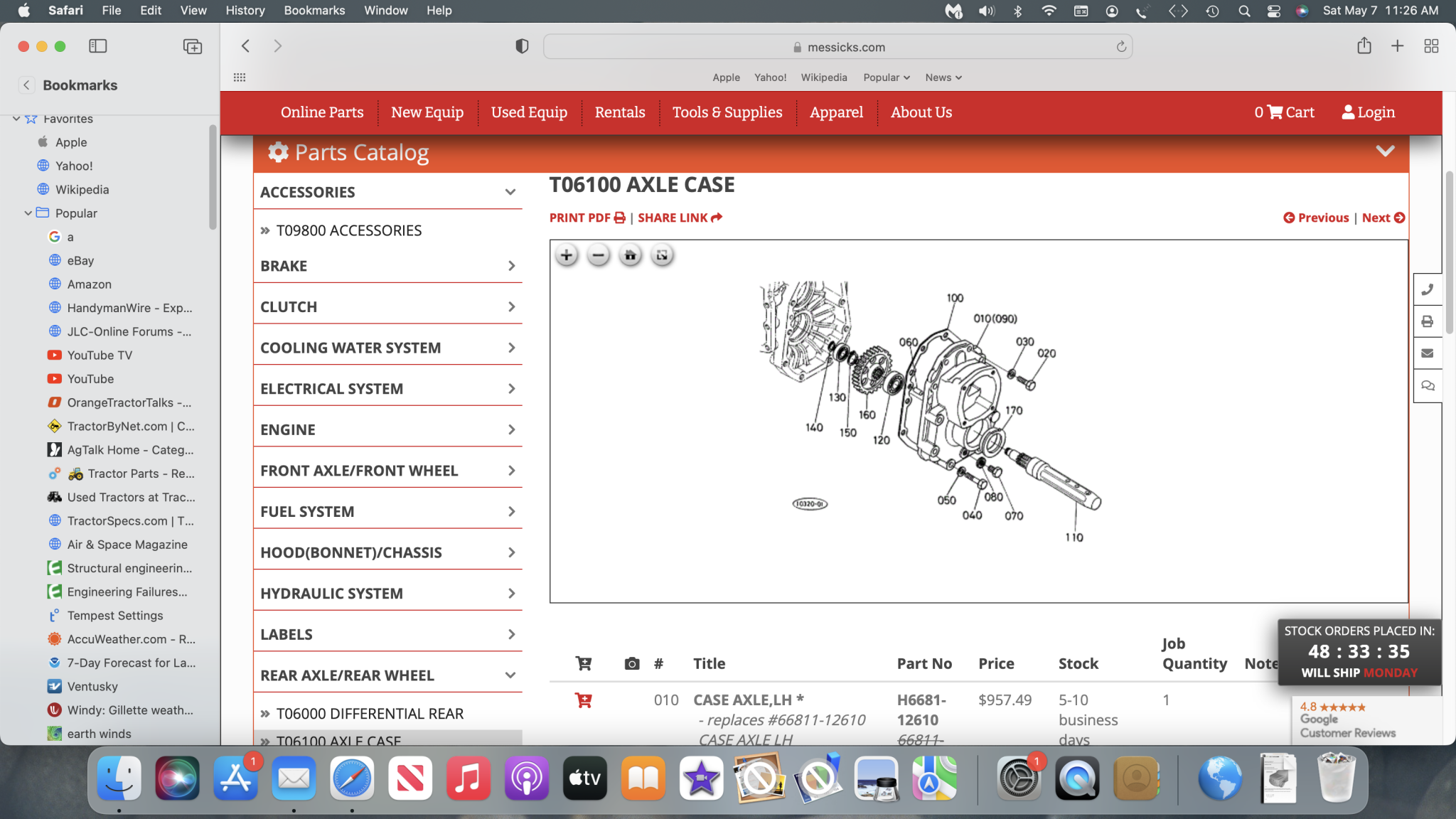

So, managed to pull my rear axle out somehow. Wondering how hard a fix this is? Is it a simple knock back in and re seal or am I dreaming?

Something has broken inside the axel case. The axel is held in with a snap ring inside that case. Hopefully maybe the snap ring just broke.
8,047
3,165
I say that is dreaming
There is probably something that retains the axle that is broken
Look at the illustrated parts list to see what that may be
