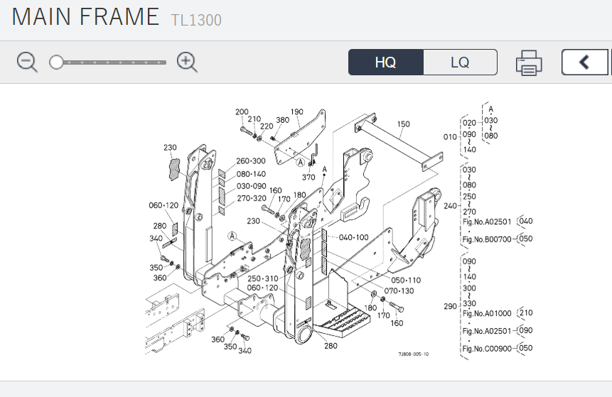

You need to drop the loader frame down, It's quite the task.

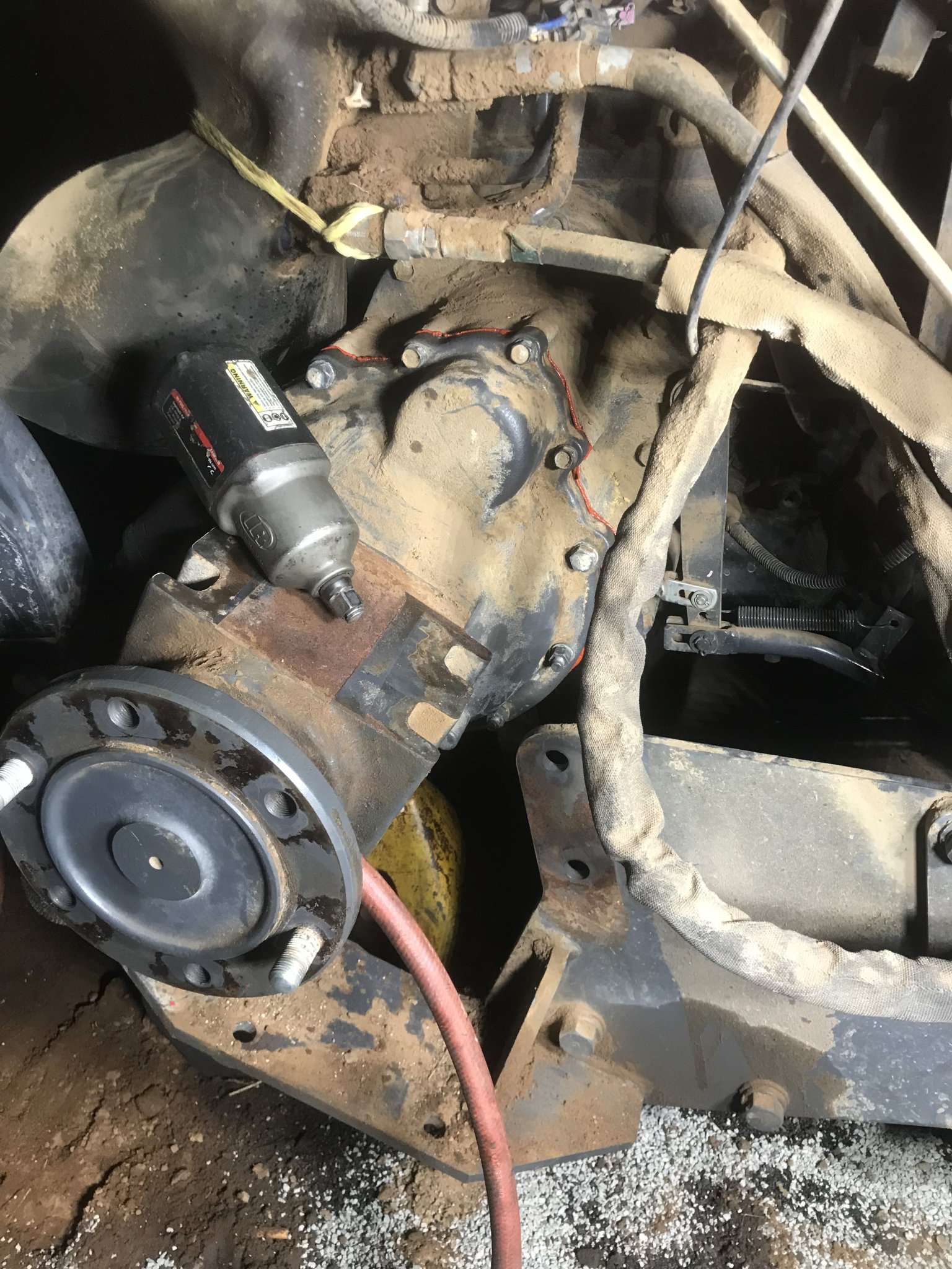

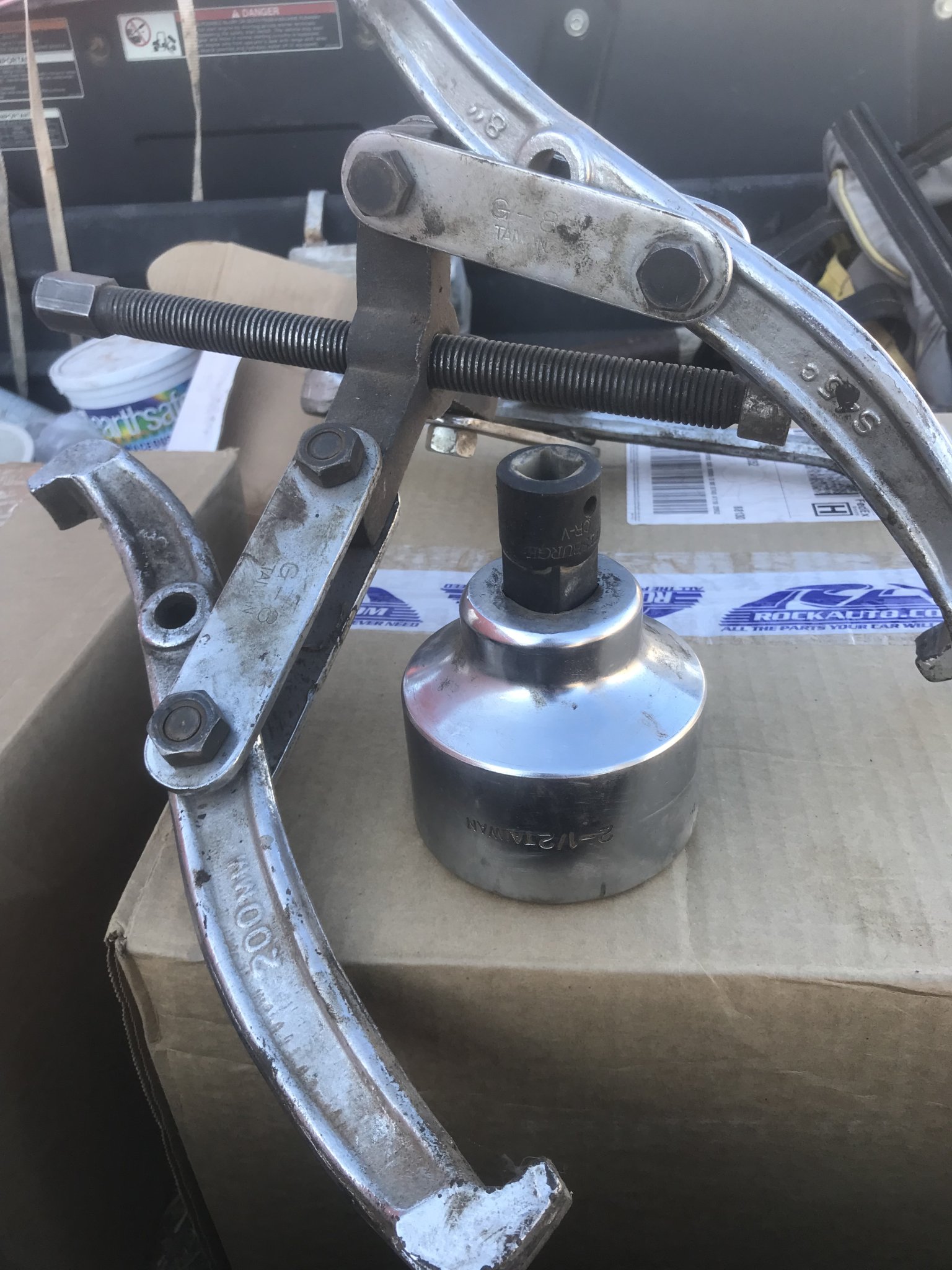

That's a 2 1/2" socket

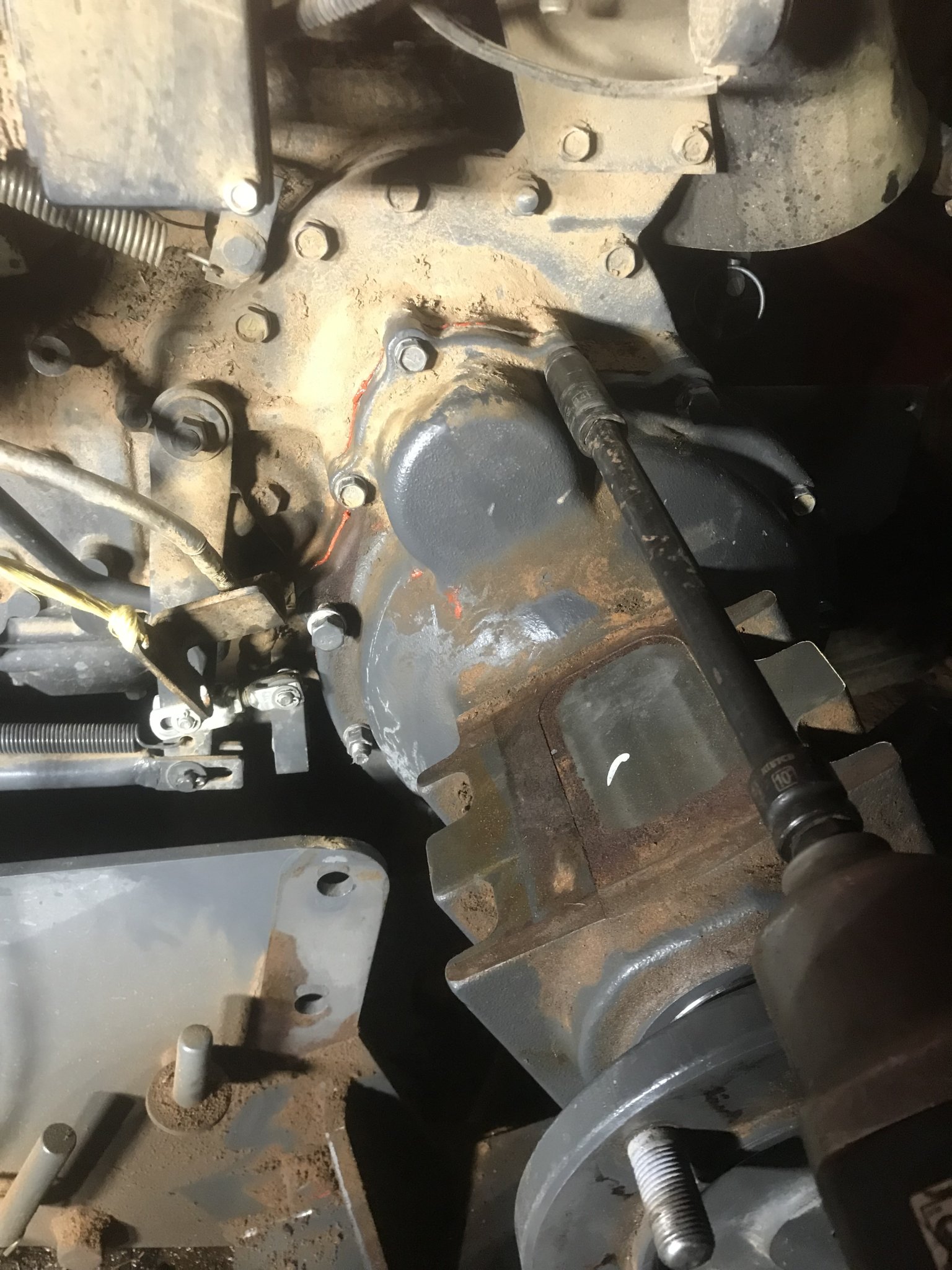

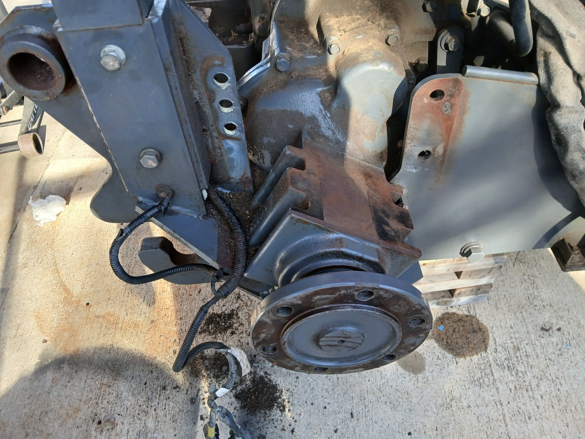

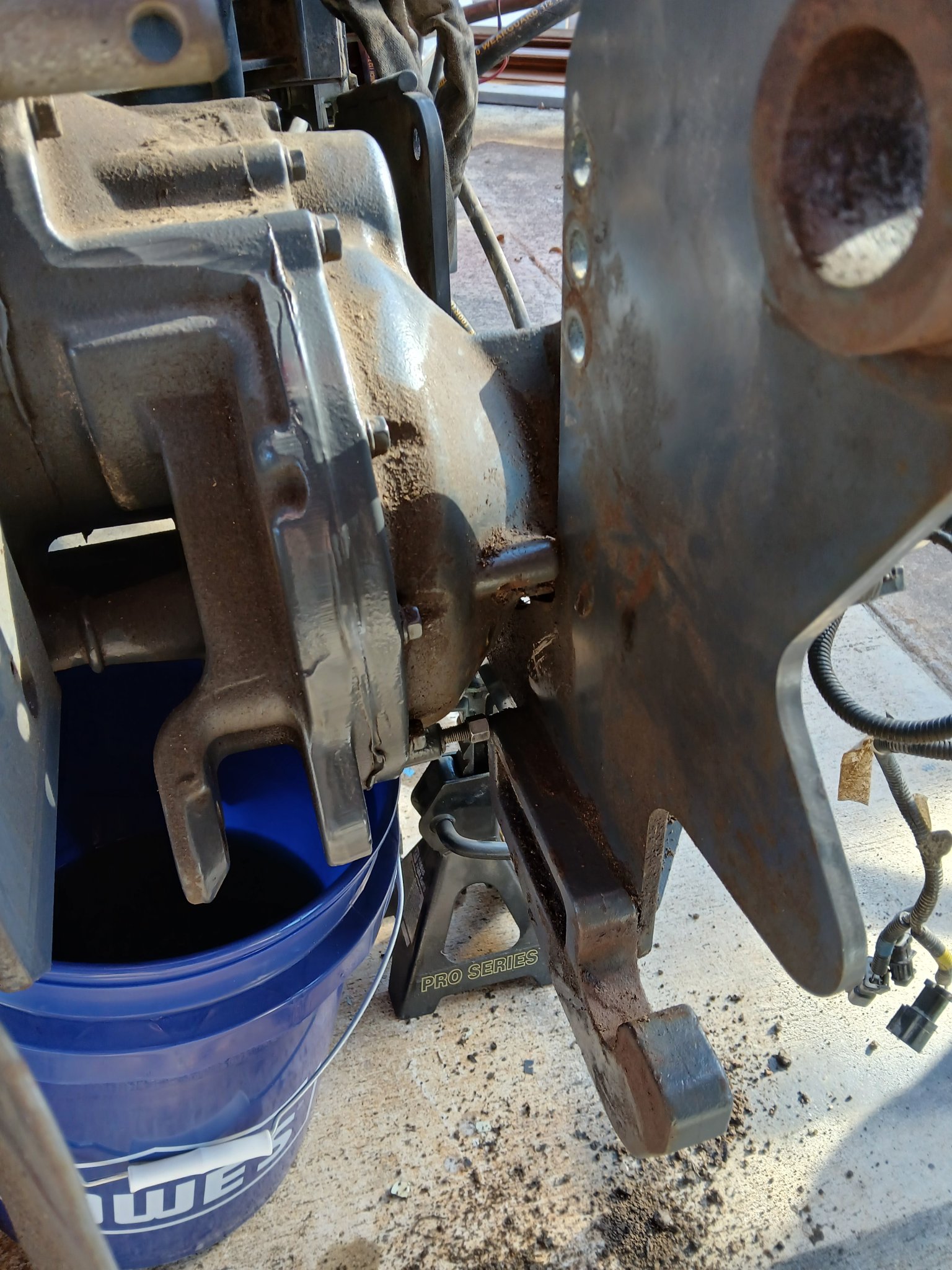

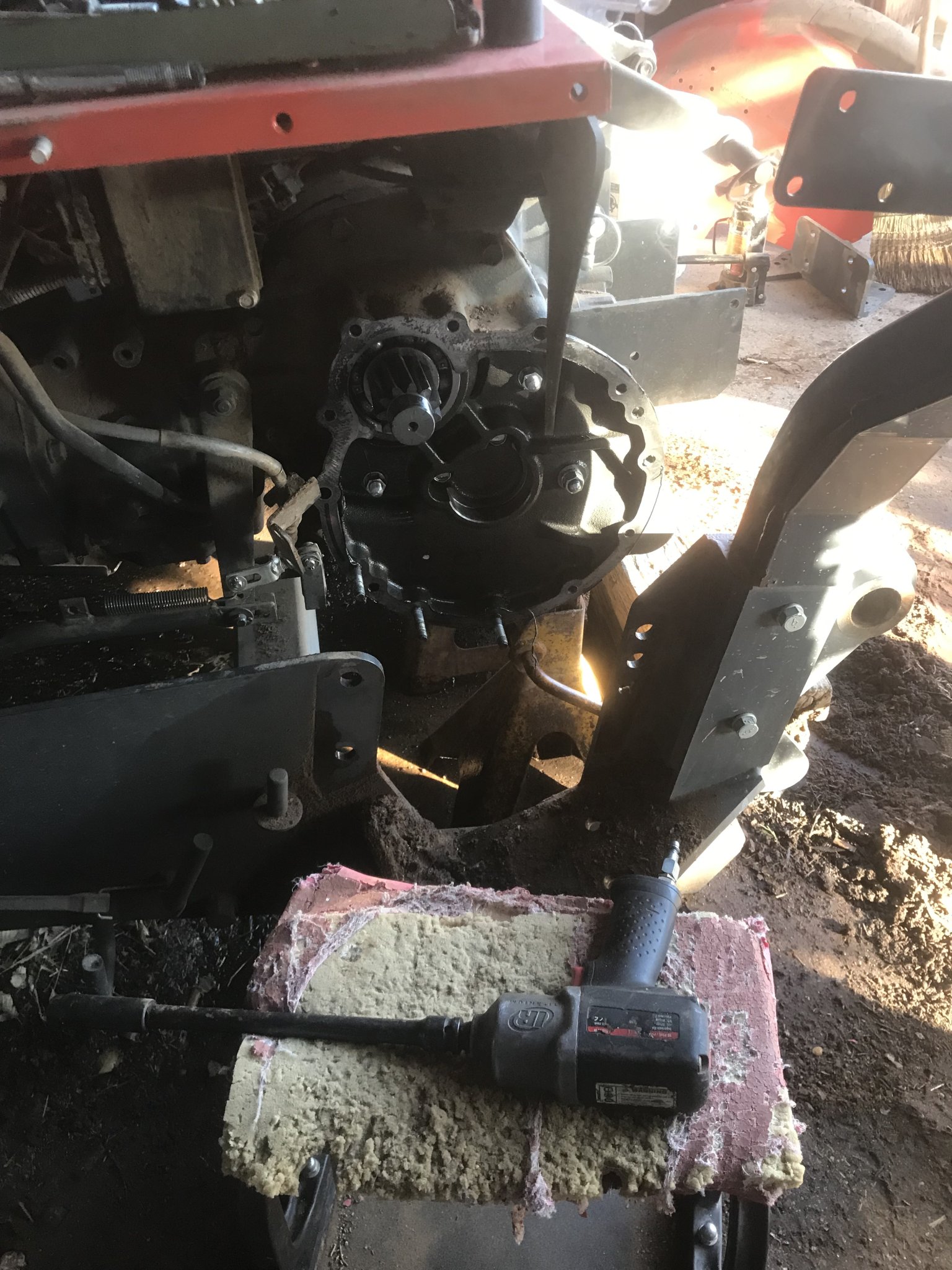

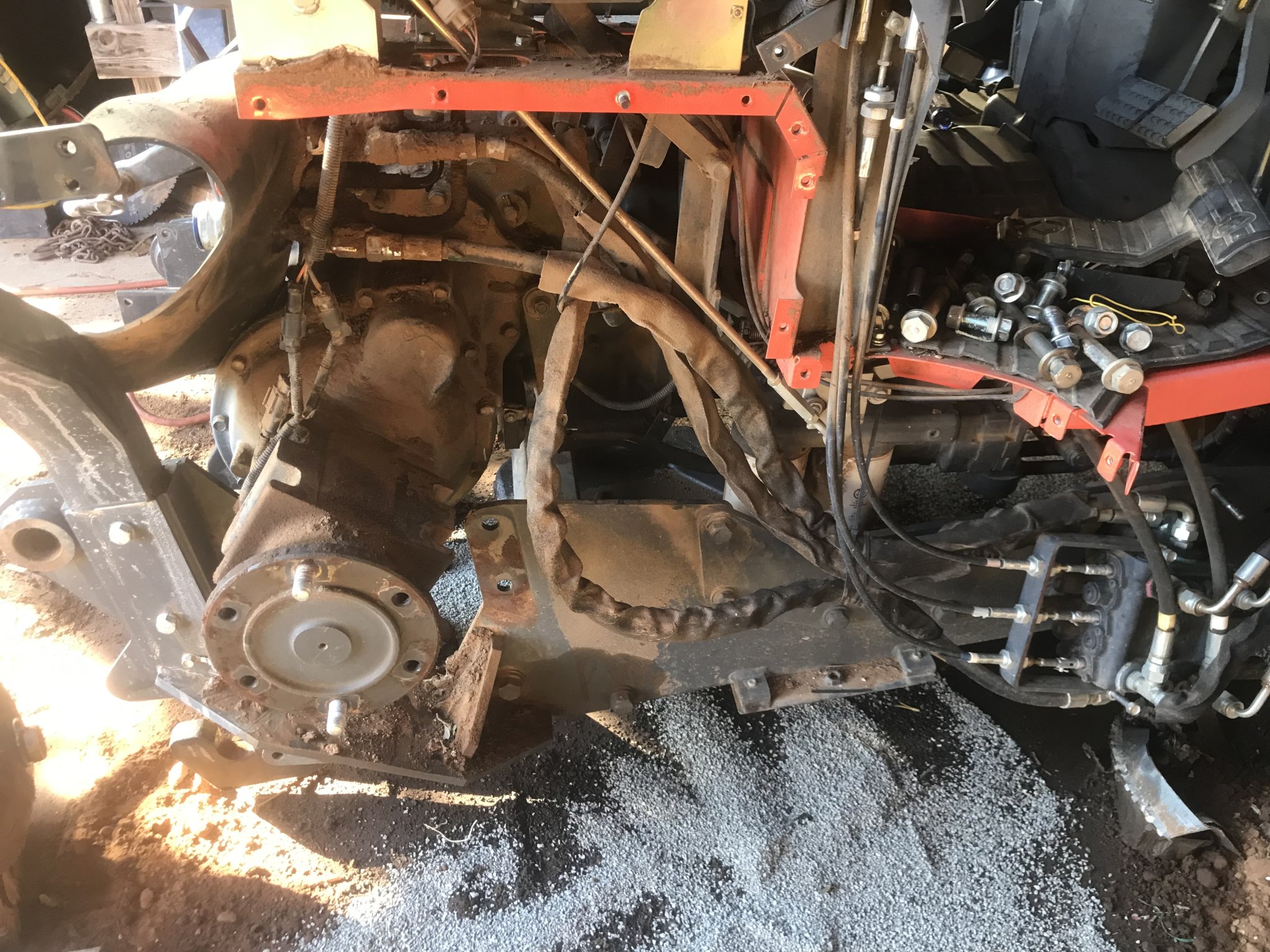

Loader frame dropped, lots of stuff in the way.
Still had to rotate the housing to get it out. It's heavy.

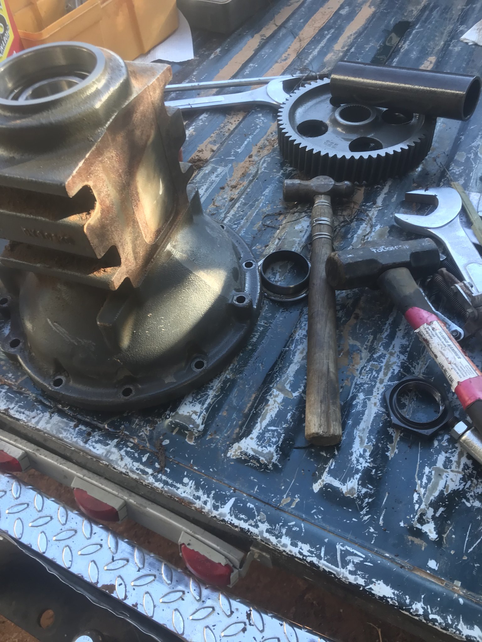

Back together
