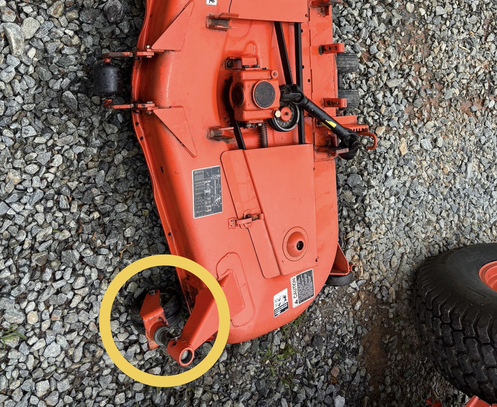

Hi all, first post here. I have a B2910 with a belly mower and somehow one of the front guide wheels has gone missing. I searched the whole field and zero luck. No clue how it could have disappeared. Anyway, was wondering if there is any way to replace it. Do forum members ever part them out. Any help would be awesome. Thanks!!

The whole dang thing. Somehow the retainer clip must have popped off while mowing and the entire bracket and wheel are gone. Which is odd since I didn’t notice til the next time I started the tractor and immediately saw it missing.

So the bracket on the mower deck got ripped off also? You will probably have to get that fabricated by a welder.
If the deck still has the bracket welded on then the rest of the wheel assembly should be available.

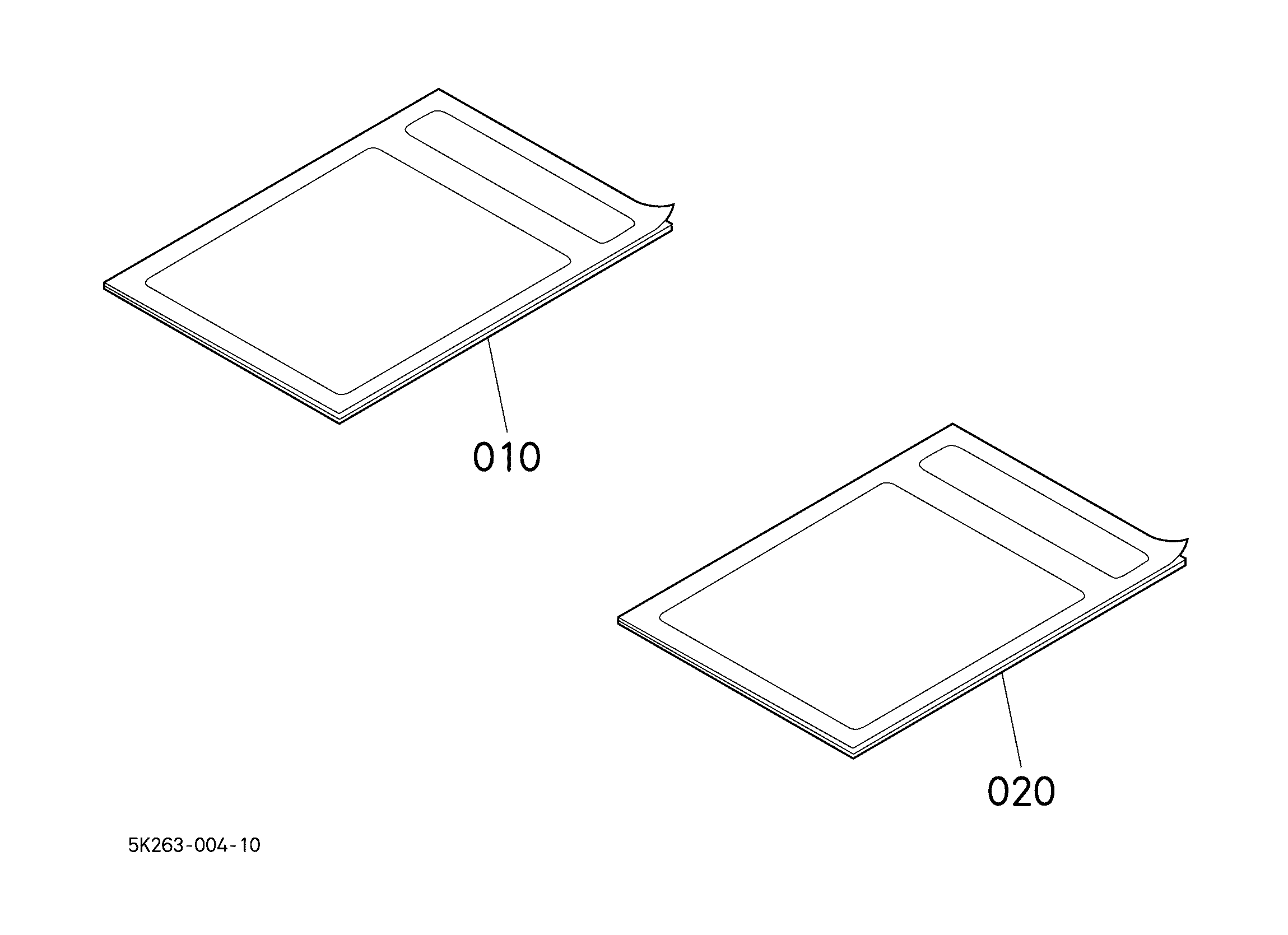

This should take you to the illustrated parts list at Messicks

Only available from Kubota and it is EXPENSIVE.
FWIW, you will probably find it the next time you mow the area.

You lost the bracket the wheel is mounted to is that what you lost, of just the wheel?

Seems like it could've only fallen out when you had the deck raised, so maybe go back (again) and re-check any areas you traversed while not actually mowing.
