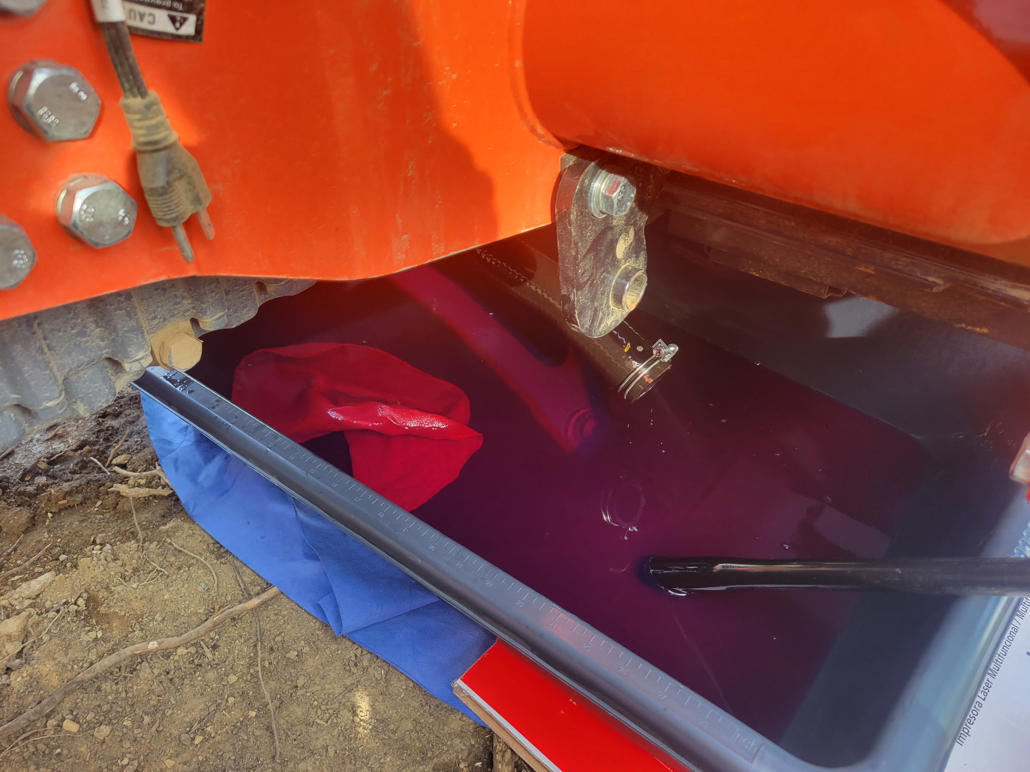

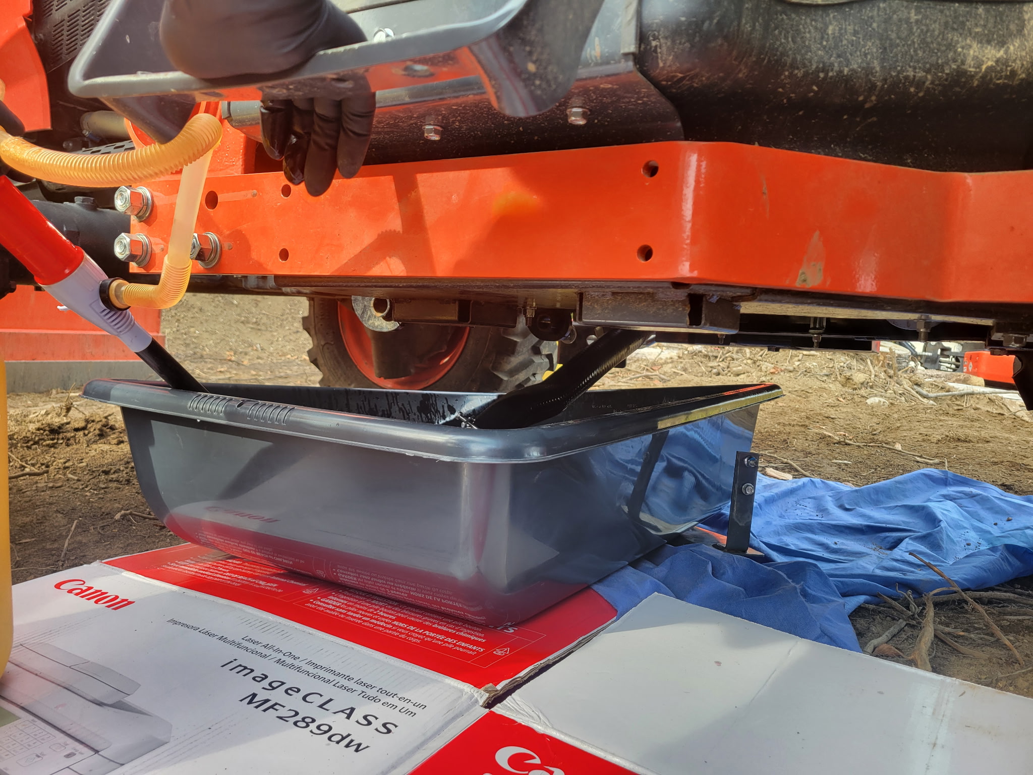

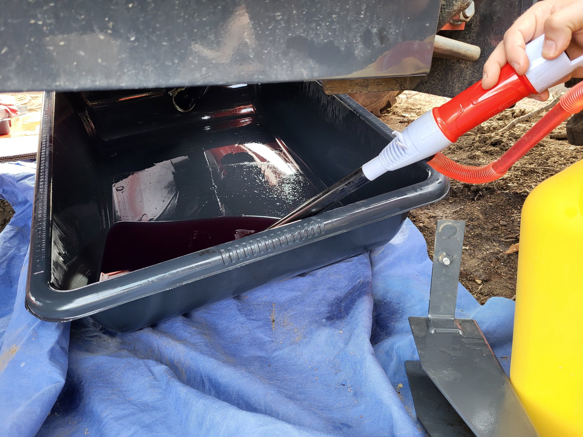

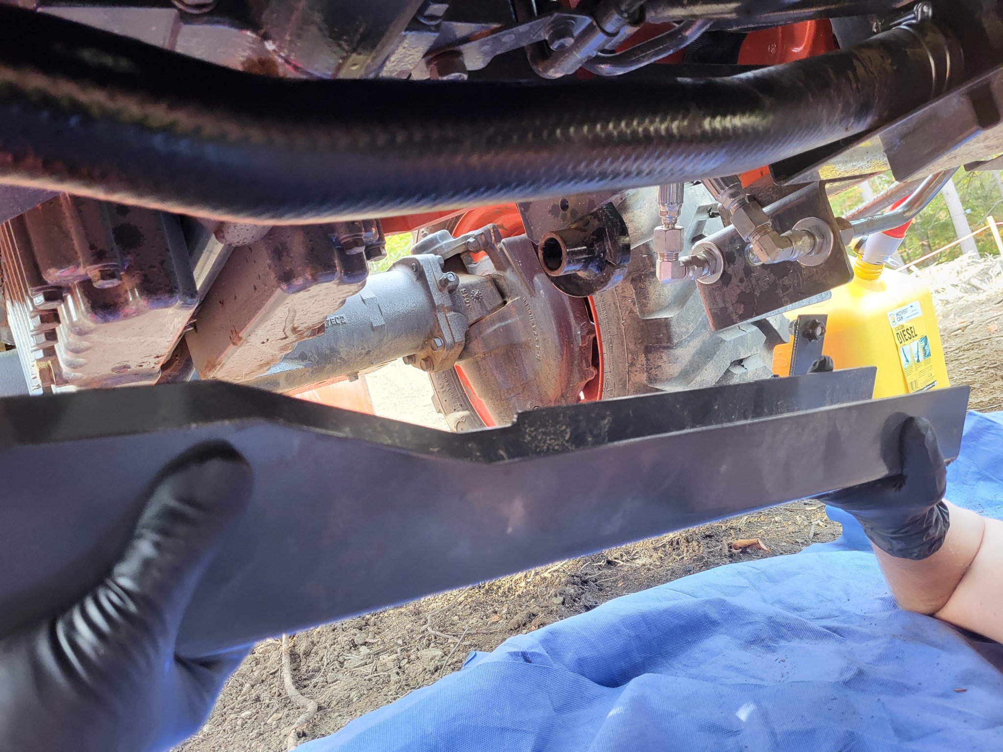

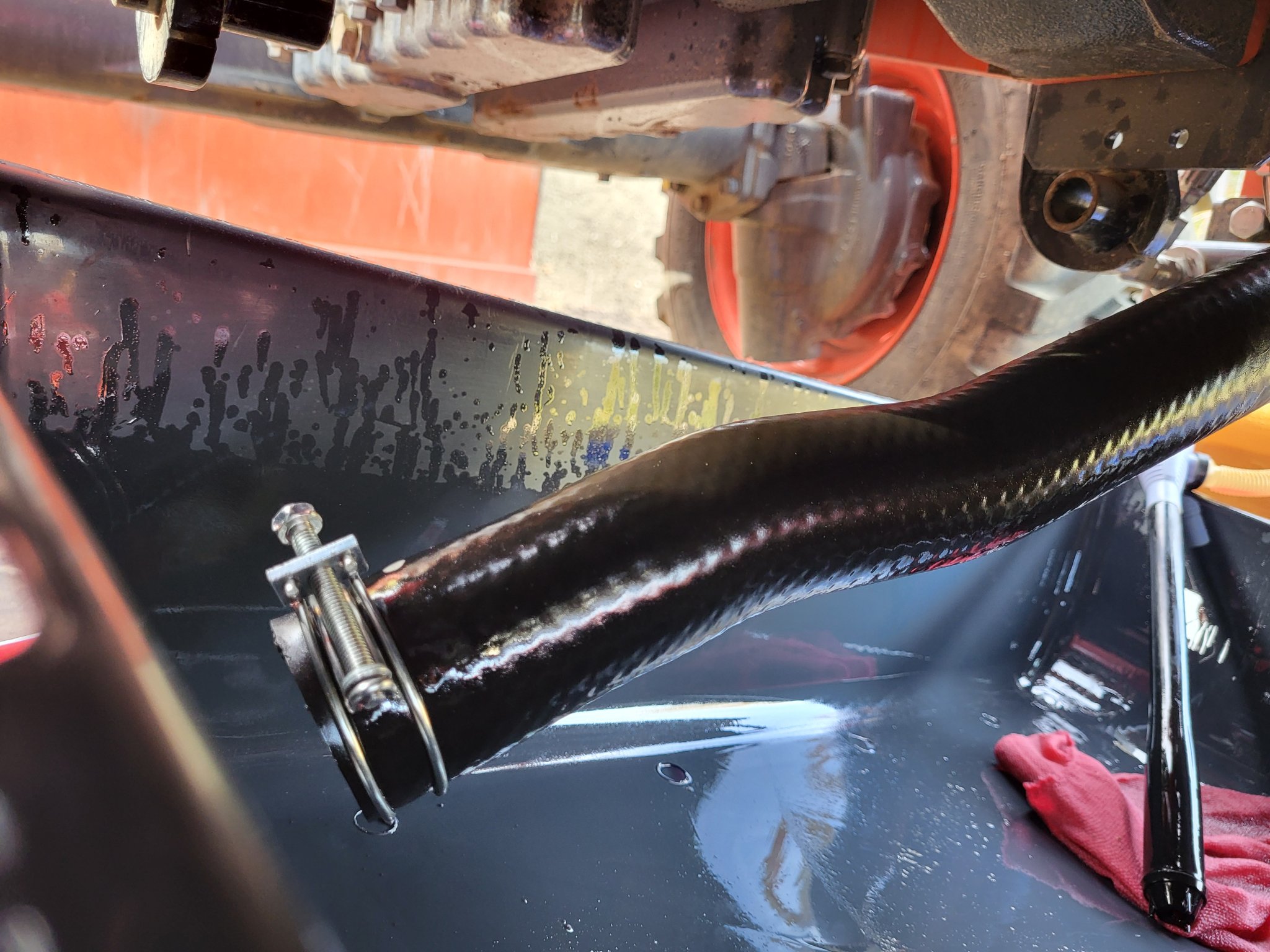

So, spent the day under my tractor doing idiotic move mitigation ( see above ). Tried siphoning out tank from filler tube to decrease volume but was only able to get out about 2.5 gallons out. Siphon tube could not reach the bottom of the convoluted right tank. Turns out the hose that connects right and left tanks has a check valve so draining tank completly is not possible this way. Water sinks below fuel so still needed to drain tanks from bottom. Bought a 20 gallon concrete mixing tray from HD to catch fuel. Removed protective u-channel like plate covering hose between tanks. 12 mm socket to remove one bolt on right and 2 attachment points on left. Struggled to reach bolt securing hose clamp on left but finally got it with 10mm socket. Frustrating position of clamp. Must remove left side of hose to drain both tanks as hose holds a check valve preventing back flow from left to right. Tank fills from right, transfers to left. Fuel is supplied to engine from left tank. Drained approx 11 more gallons into tray. Pumped from tray to gerry cans, and labeled cans as "contaminated." Will use for burning brush piles. Cleaned up components and reassembled. Took way too long... most of day gathering tools and doing the deed. Will never forget to put fuel cap on again. Will post pics later.

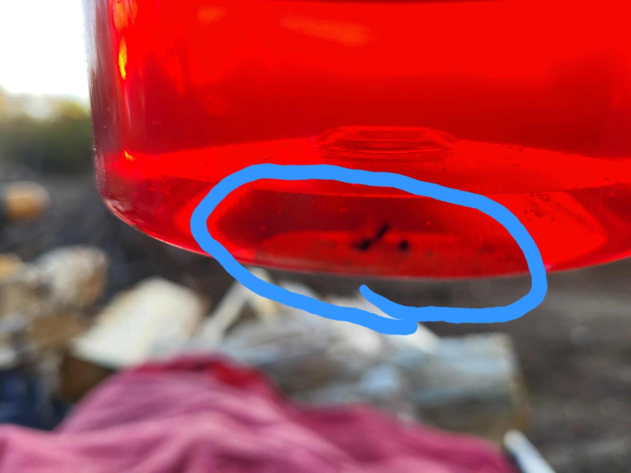

Yes. To be honest, we would have had to be very careful to draw from lowest layer of drain pan first to get an accurate measurement of water. But we wanted to get done before dark and so did not take great pains to do so. But I did place some of the turbulent aspirated fuel into a clear container and sure enough, there was some water. Tough to see in following pic but there is bit in bottom of jar. If I wanted to be strictly scientific about it, I could separate water from the 3 gerry cans to measure but I've lost alot of time having to fix my error and need to get back to my projects before winter comes to kill us. Lol. Mabye I'll save fuel for a wintertime experiment.
