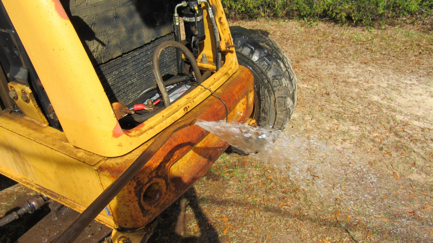

I do have a homemade water version I use on occasion. It does a better job than the blower and gets in a little more area. I just adapted a water hose fitting to a piece of 3/4" copper tube and bent the end down on a feeler gauge to leave a tight area that increases the water pressure.
