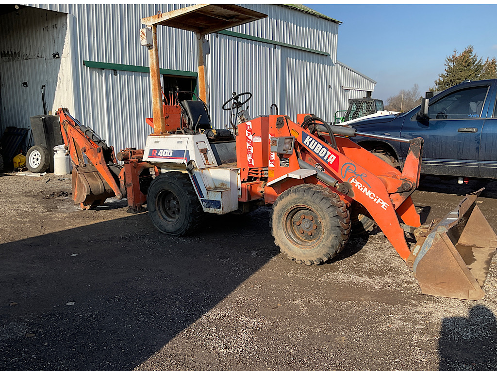

Are you talking about one of these?? If so.. that's an interesting machine!
