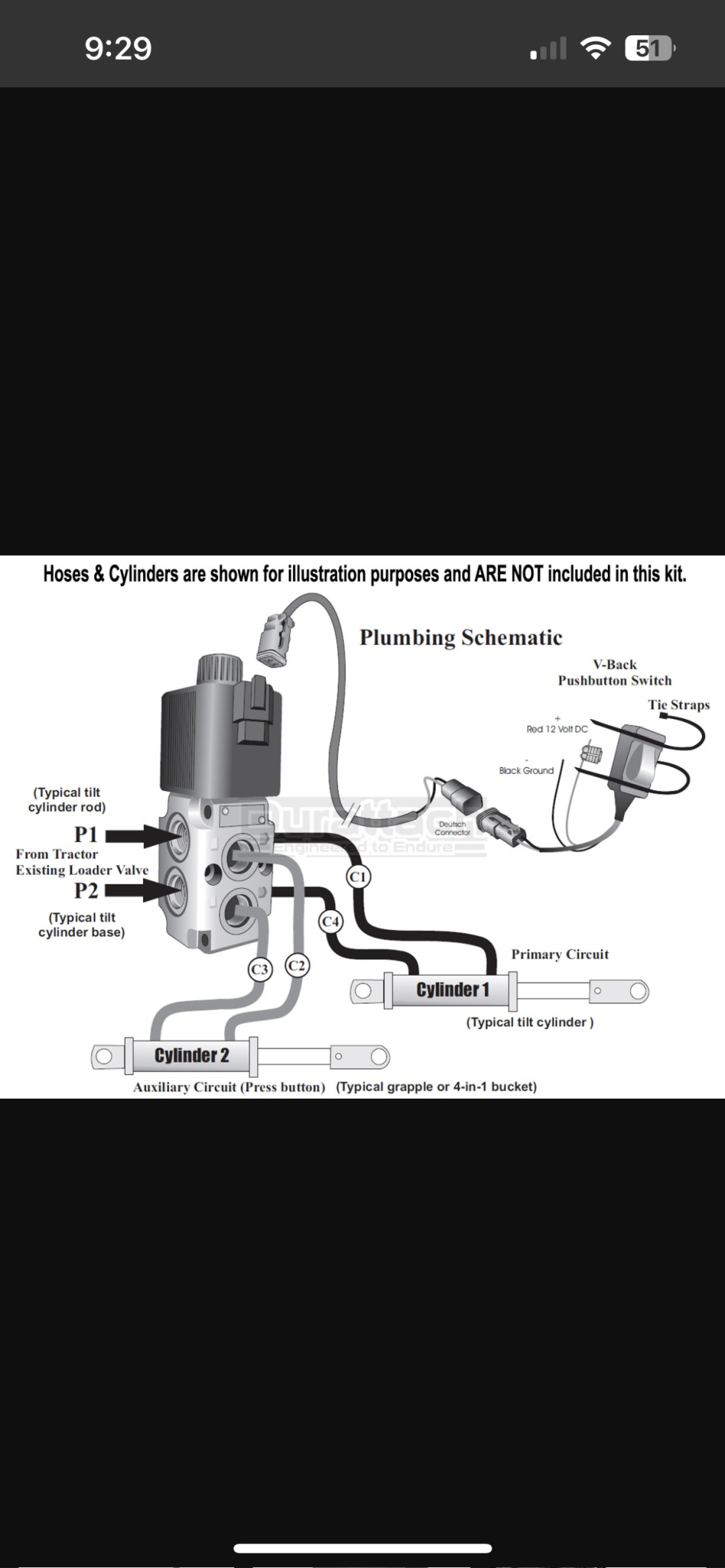

Na, just a 6 port with a momentary push button for energizing the second circuit.
8,928
4,668
I understood. I was talking about using another electric valve rather than a diverter to get the same functionslity as the additional work section in the Kubota kit.

Would depend on a few things. Seems off for just the valve kit, thumb kit and cylinder kit with labor. Now if it includes quick change bucket/coupler, that would explain the price. Also, the L47 you need to know if that is kubota designed or werk brau excavator quick change(orange or black)... Lot of variables here.
I think there’s two different thumb kits too, I.e. orange vs black in order to mate up with the two different styles of QA buckets. I decided to add a thumb after I bought my L47 and the installation isn’t too hard. The valves are exactly the same, except for having the thumb spool already installed which is silly that Kubota won’t supply just the thumb spool and pedal in a kit form instead of making you buy a whole new valve assembly. I have an almost brand new valve assy if someone wants to try and source the thumb circuit spool and pedal separately. Same valve is also used on the M62.
