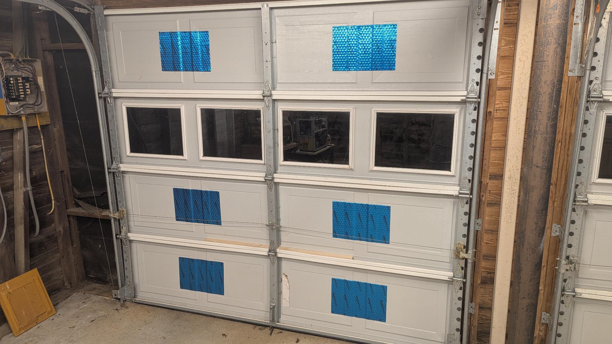

I had the good fortune of massively quieting the metal panel doors for my future shop with these butyl sound deadening mats. It even dampened the noise from the sloppy wheels etc. Highly recommended!
My intention was to make some effort to minimize shop noise escaping, and hoped for the side benefit of quieting the doors. Man was I pleasantly surprised. Didn't realize the extent of the drum effect of the panels.
I got the Amazon Basics version, which are bright blue, but I'll be putting rigid foam panels on top of them for insulation. Currently $18 for 10 pads, roughly 1 sq ft each. https://www.amazon.com/dp/B07XMF2V77
Hope this can help someone else.
Greg
