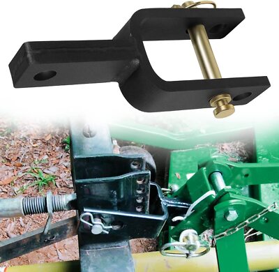

Looking at pictures of the hitch it "looks" like it's already QH compatible.
Better pictures of the top link hitch point might either confirm or deny it.
If it does need the adapter here is one:
