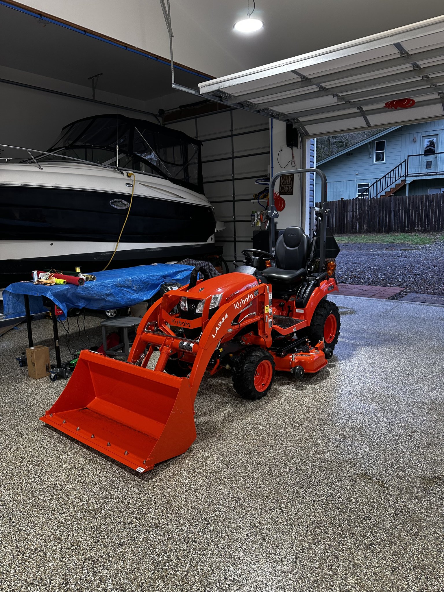

So on Christmas Eve I had my BX2680 delivered. It is replacing my 20 yo BX 1500. I ordered it with the Quick attach system for the front loader.
My 1500 has welded on hooks and I am wondering if there is a recommended set of bolt on hooks preferably with a hitch receiver I can get. Google shows lots of options but none say if they will fit this bucket.

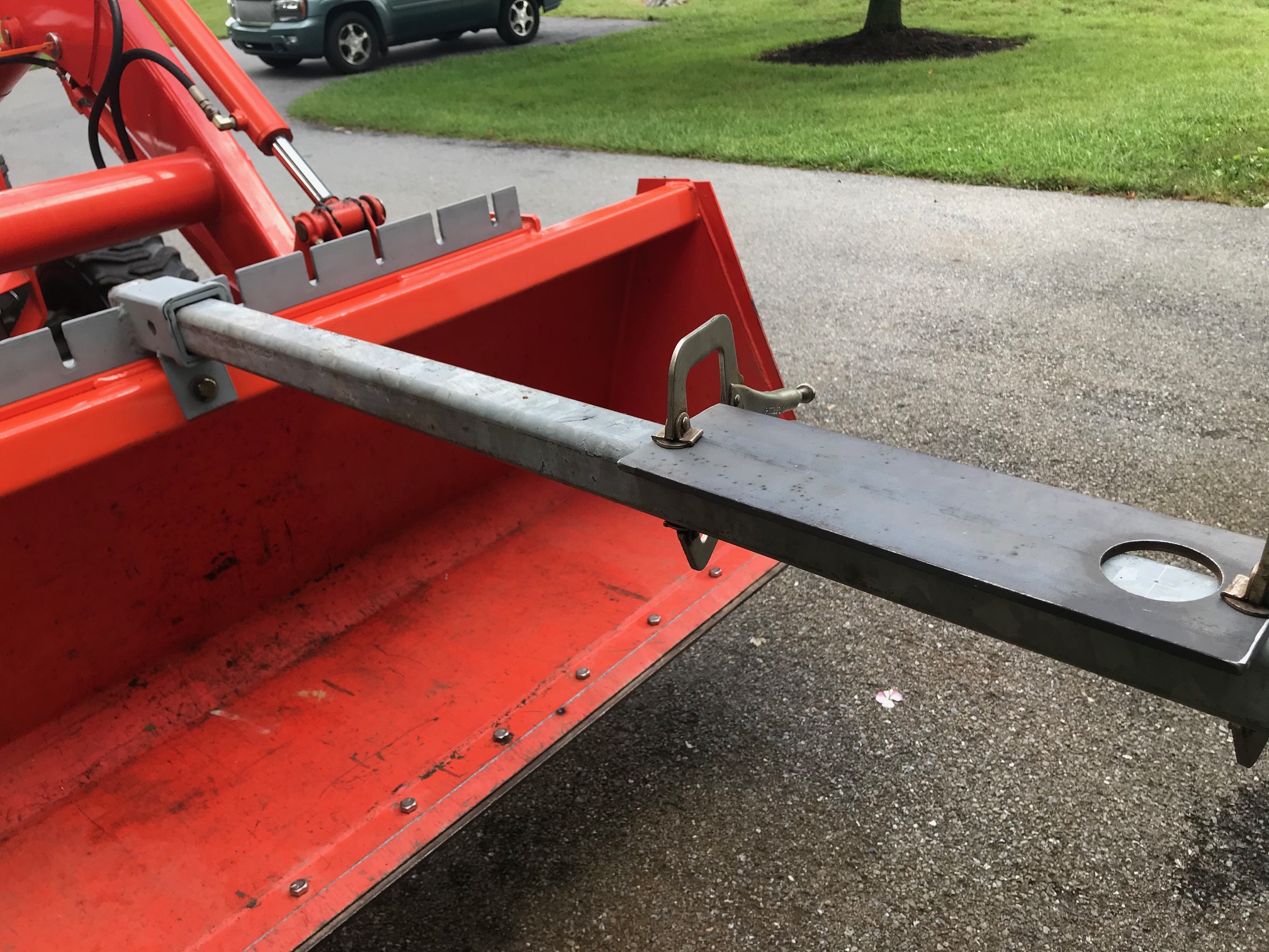

I didn't have the heart to weld or drill into my new bucket,so I went with option #3.
That's a section of electrical 'strut' that nicely slides into the 'pockets',hooks get bolted to the funny strut nuts and its tight. 4+ years, no issues.

I always like to weld hooks onto a 1/4” thick piece of angle iron that is the length of the bucket lip. Then drill and mount the angle iron to the bucket. This will strengthen your bucket lip.
