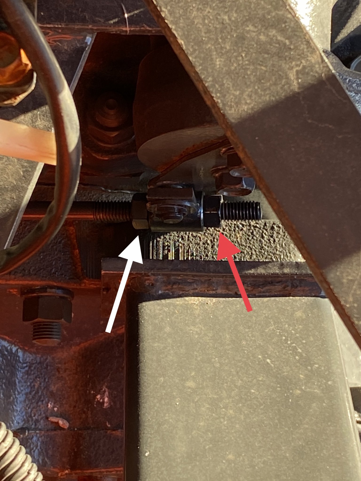

Here is the linkage needing adjustment, under the left side of the seat connected to the base of the left side 3 pt link

Red arrow is lock nut, white arrow is the adjustment nut for the link rod. Loosen both, start tractor and warm up with 3 pt in lowered position. Raise 3 pt lever, and adjust the left (white arrow) nut until the relief valve stops, then 2 full turns past that. Tighten your lock nut and problem fixed.
