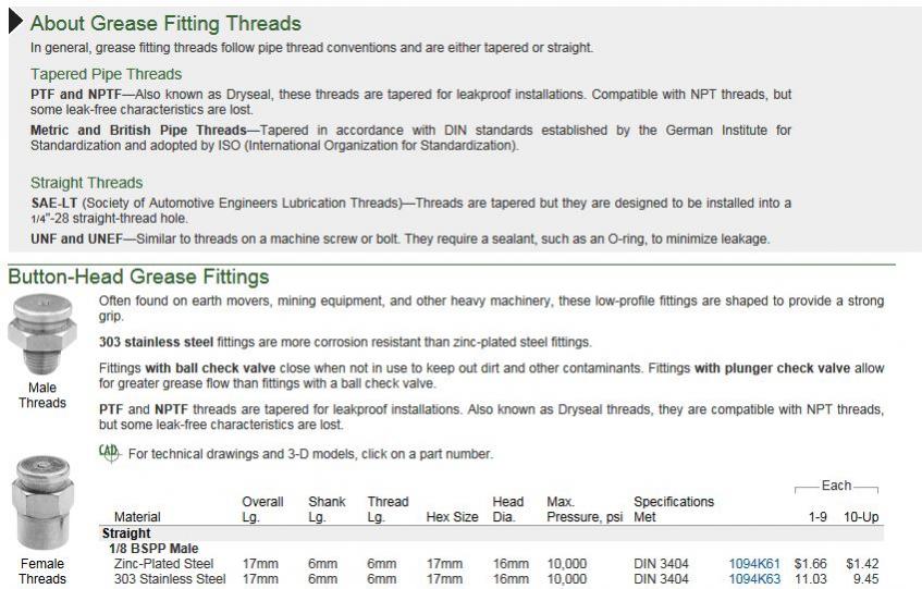

Button Head fitting was the first thing that came to mind for me. I think they can come with or without a ball check valve. Would seem odd to mix the two types on the same equipment. Pic is from McMaster.

Now I'm confused all over again! Ha ha ha ha! You may have to directly go to Kubota and see what they say. Thanks for your input.
